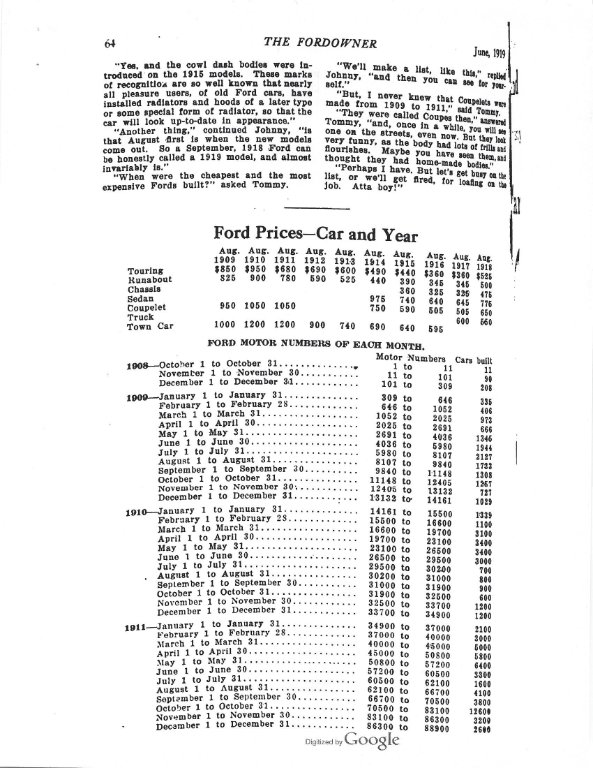

Correct. The publication Ford Owner in the 1920's discussed identification of the model T Ford based on the Motor Number. Another period automobile publication discussed auto theft and shows where to find the manufacture number. The article states that Ford numbers are located on the motor.
Remember too, that there was a forum discussion on using stamps to replace the original factory motor number on to reconditioned or replacement blocks.
If interested I can later jpg these references.

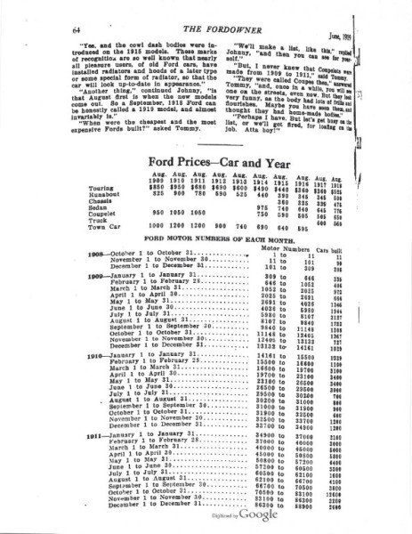

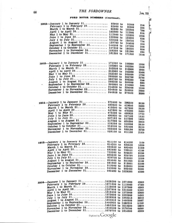

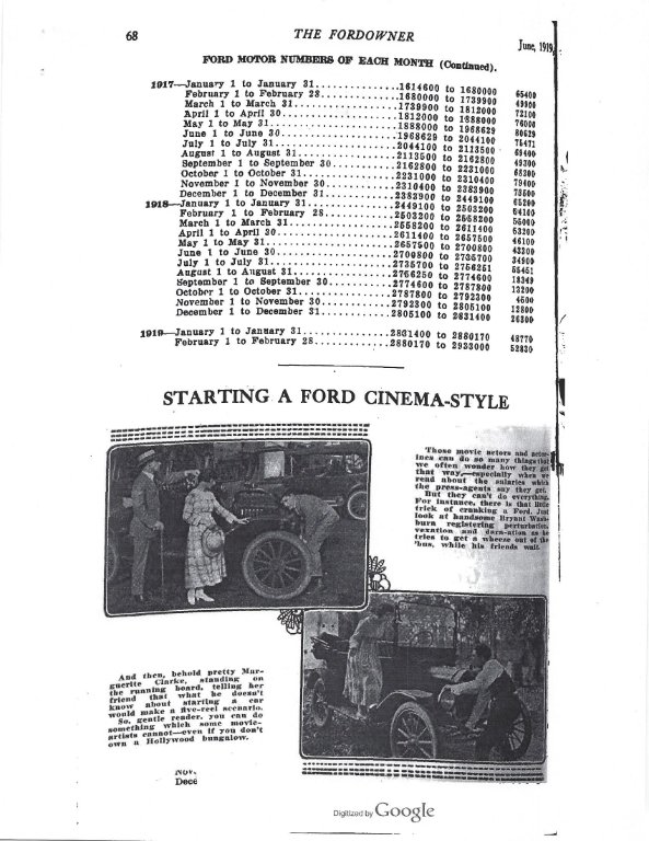

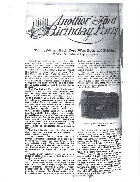

Post by Been Here Before » Wed May 17, 2023 10:43 am
The following may help pre 1920 Ford Owners. The article is from the Ford Owner June 1919. During the life of the Model T the FMCO would list production and motor number in their in house publication the Ford Owner. In May 1913 a list of motor number was published, it was used to identify the year of manufacture, provided the motor was not changed.
As we know all Fords look alike.
As the article states - "the real value of the motor numbers is to establish the definite date, ...on which the car was built. This motor number is stamped on the left side of the cylinder block....Many states require this motor number to be given when application for license is made." (Ford Owner 1919 June, page 63)
