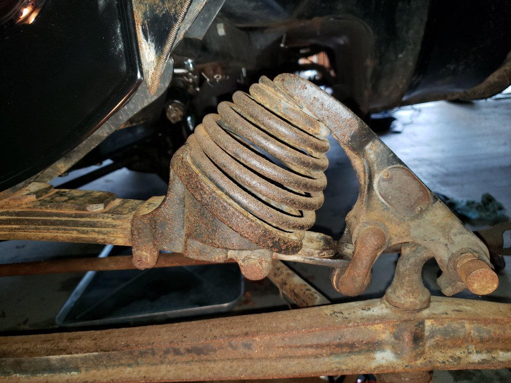

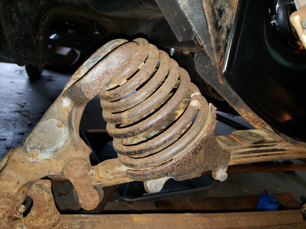

I eventually want to swap in the rebuilt front spring I have. My 26 Touring has Hasslers on it. My question is the Hassler springs look to be worn out. Do you think they are or is it just that the front spring itself is so worn that it is collapsing the Hassler springs down?
I noted the front spring/axle is shifted off center by about 1/2" I'll fix that with the new spring.

A weak front spring will allow the Hassler springs to compress more than normal.
All the parts of both the original equipment suspension and steering and the Hassler accessory equipment need to be in good condition. Be sure your front crossmember is not bent, cracked, heavily rusted, or loose at the rivets.

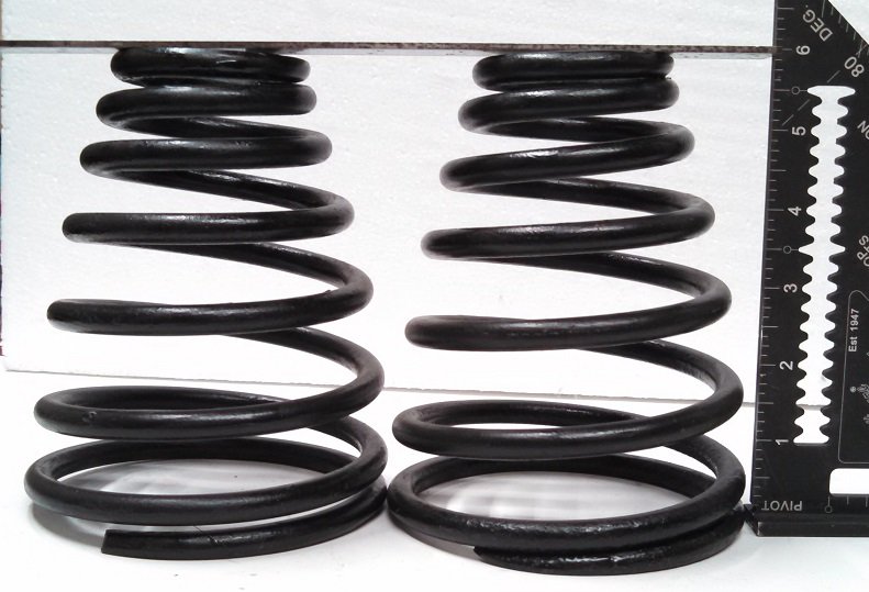

My own educated guess is the worn and shifted spring makes the Hassler springs look shifted and bottomed out. Since the leaf spring takes the load and the Hasslers just some of the shock, I'm guessing the springs are probably not worn but who knows? Anyone ever wear out a Hassler spring?
- Posts: 5385
Re: Question on Hasslers
Wear out, maybe not but go a little flat, yes.Mikey1968 wrote: ↑Tue May 30, 2023 1:19 pmMy own educated guess is the worn and shifted spring makes the Hassler springs look shifted and bottomed out. Since the leaf spring takes the load and the Hasslers just some of the shock, I'm guessing the springs are probably not worn but who knows? Anyone ever wear out a Hassler spring?
- Posts: 6552
at least one looks shifted and if you look closely again at the design, they are most certainly carrying some load.
my belief on shifting is based on the imaginary intersection of the arc of swing of the lever and the straight line of compression of the spring. In my mind the intersection of the lever arm and the spring axis should be very close to 90 degrees. One appears to meet that criteria and the other appears to be pressing on the spring at an angle (and the spring base appears more outboard, too)

Topic author - Posts: 232
- Joined: Fri Mar 01, 2019 9:08 am
- First Name: Michael
- Last Name: Jewell
- Location: Northern Virginia
I agree with you, Scott. This will be fixed when I swap out the leaf spring.
