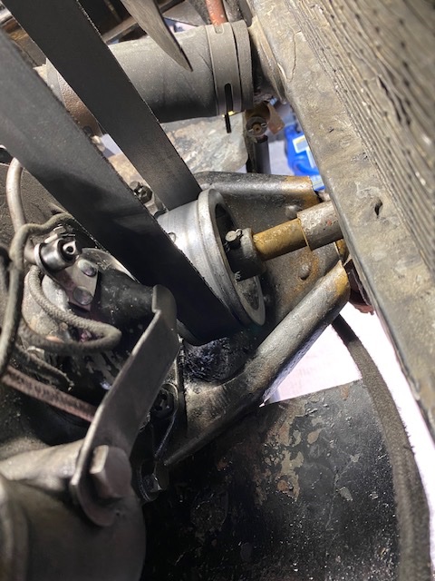

To locate TDC, in relation to the starting crank, in relation to your motor...pull the No. 1 sparking plug and turn motor by hand crank to get TDC - both intake and exhaust closed. Note location of starting handle.
- Posts: 4394
Re: Question re setting timer position at full retard…
You have an aluminum crankshaft pulley. They are usually split, with a clamp screw to secure them tightly. That split line runs perpendicular to the crank pin hole. Use that as your reference. At TDC, the split will either be at the 12 or 6 O'clock position, depending on how you mounted it. Determine if it's on the compression stroke by placing your thumb over the #1 plug hole while cranking. When you feel a puff, you're on compression. Then, just get the split line vertical and you're on TDC.

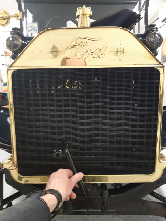

Going from TDC to 15 degrees past, the crank handle moves approximately 2 inches.

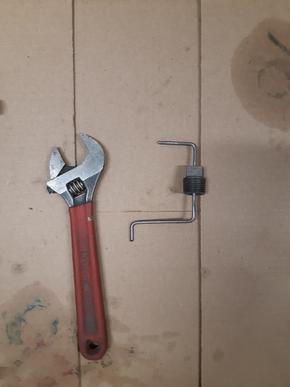

I made a tool to check the timer accuracy and initial error The device consists of a used camshaft, a timing gear cover, a camshaft gear, and a fixture to hold things in place. I found a degree or so of error at the timing gear with roller timers. The crankshaft error is twice this. I will post a picture as soon as I learn how to post a picture.

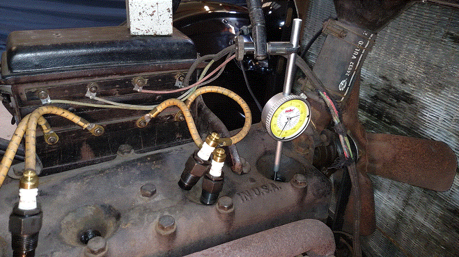

I-timer is only $424, but if you want an E-timer.....
You still have to find TDC after you install any timer of your choice, and adjust it.

John : Just trying to show guys what to look for at swap meets. Or when my daughter has the auction.

I followed the suggested simple process noted by others above. Take out the #1 plug and use a wire, gauge, screwdriver or other favourate way of checking piston position. Turn the engine to the #1 compression stroke, piston 1/4 to 1/2 inch down after top dead center. This likely works out to only 2 to 5 degrees after top dead center. But it works well.
Set timer and rods to spark the coil at full retard on the column at this position. Take out piston position indicator, install plug and start engine and go driving.

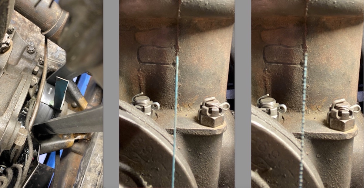

So to help with the discussion I went out this afternoon and actually measured (more or less) where my '15 is currently set for full retard.
I think that I originally targeted TDC or where the piston just started to move down. Its current setting is actually slightly BEFORE TDC to fire the coil on battery. The coil is firing about 1/16" +- before TDC. And even there I can choke the engine cold, turn 5 spins full throttle, then turn the throttle back to 1/2 or so, and get a free start 4 times out of 5 cold. And it will start hot with only a pull or two and needs very little throttle to start hot.
And I haven't experienced any "kick back" hand cranking with it in this position either. Although I would recommend aiming for more for TDC or just where the piston changes direction.
Here is a picture of where my crank is when the coil is firing on battery. And also one of my low buck home made piston position indicator. A pipe plug with a small holed drilled in the middle and a coat hanger wire indicator. The top of the wire is bend over to point in the same direction as the wire that will sit over the piston so that you can check that its aligned.
Drive Safe
Jeff
