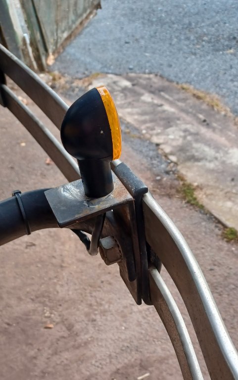

Post by greasemonkey100 » Wed Jun 07, 2023 3:34 pm
On my '27 Fordor I installed 6 volt motorcycle turn lights I found on ebay with brackets that bolt on with the bumper. I like the look and they are plenty bright for people to see.
