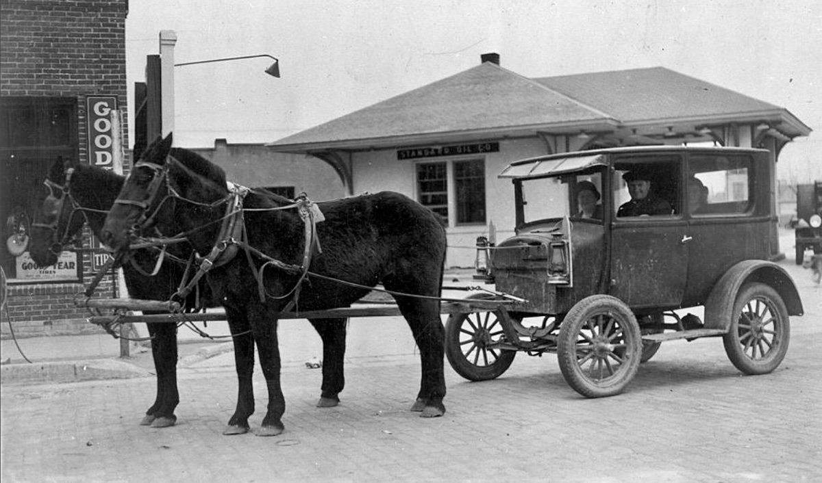

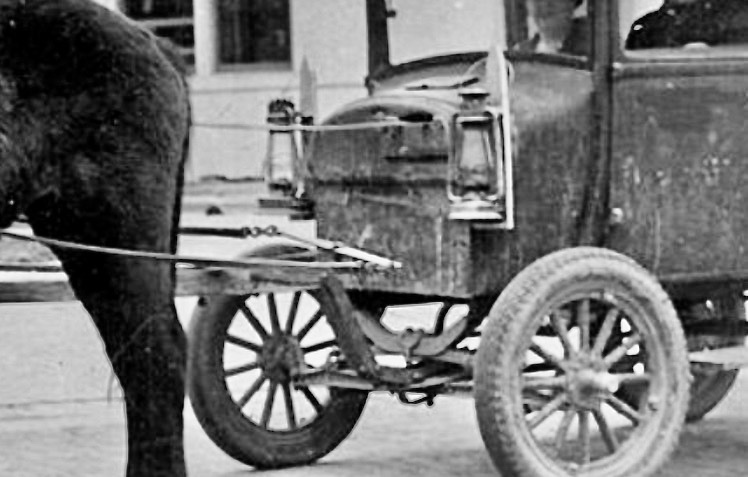

Post by DanTreace » Fri Jun 09, 2023 9:21 am
Looks like a sort of a horse wagon fifth wheel apparatus to steer the front wheels.

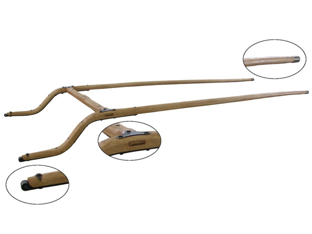

Stuff:
https://www.ivccarriage.com/collections ... e-hardware
imagesshaff attachment.jpg (10.96 KiB) Viewed 1901 times
Consider contacting the Carriage Association of America ( https://www.caaonline.com/) and inquire about information in their archives.

Re: mods to make a Bennett Buggy/Hoover Wagon
Post by Dennis_Brown » Fri Jun 09, 2023 10:11 pm
In the picture they have used aunt that attached to the front axle and had a double flat plate on top.the bottom plate was part of the piece attached to the axle and there was about a 5/8 hole thru both plates and bolted together for a turntable. The top piece extended to the rear and was clamped to the tie rod causing the spindles to turn with the tongue.. The top piece also extended forward and in this instance angled up a little then had a pivot so the tongue could move up and down? I see a single tree attached to both harnesses i and the tongue in front of the horses. Normally you would have a double tree attached lower behind the horses and the tongue attached there and the horses could turn easier without the tongue between them.
This unit looks like they cut off the frame and moved the front crossmember back. I do not know if the horses could pull the front axle out if the wishbone was removed but they may have rigged some way of attaching it. There was no torque on the rear axle so the radius rods there could be removed or attached some way to keep the axle straight.
I wonder if the left the emergency brake lever in and hooked up?
Normally when the T chassis was used as a trailer the pan was left in and the front radius wishbone was left hooked up as a tractor would have a stronger pull against the axle. The tongue then pivoted up and down just in front of the axle.
.I have a unit in the attic somewhere that I took off a front axle that was used on a 4 wheel trailer.
