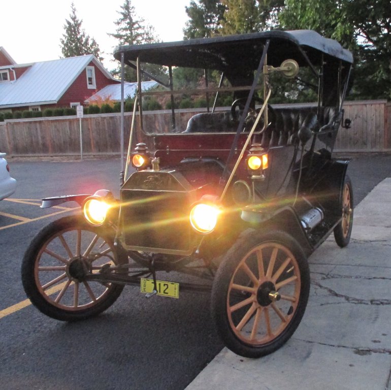

An MC tank will work for short periods of show for a static display only.
If you want to run acetylene lights, get a B tank and mount it on the running board.
