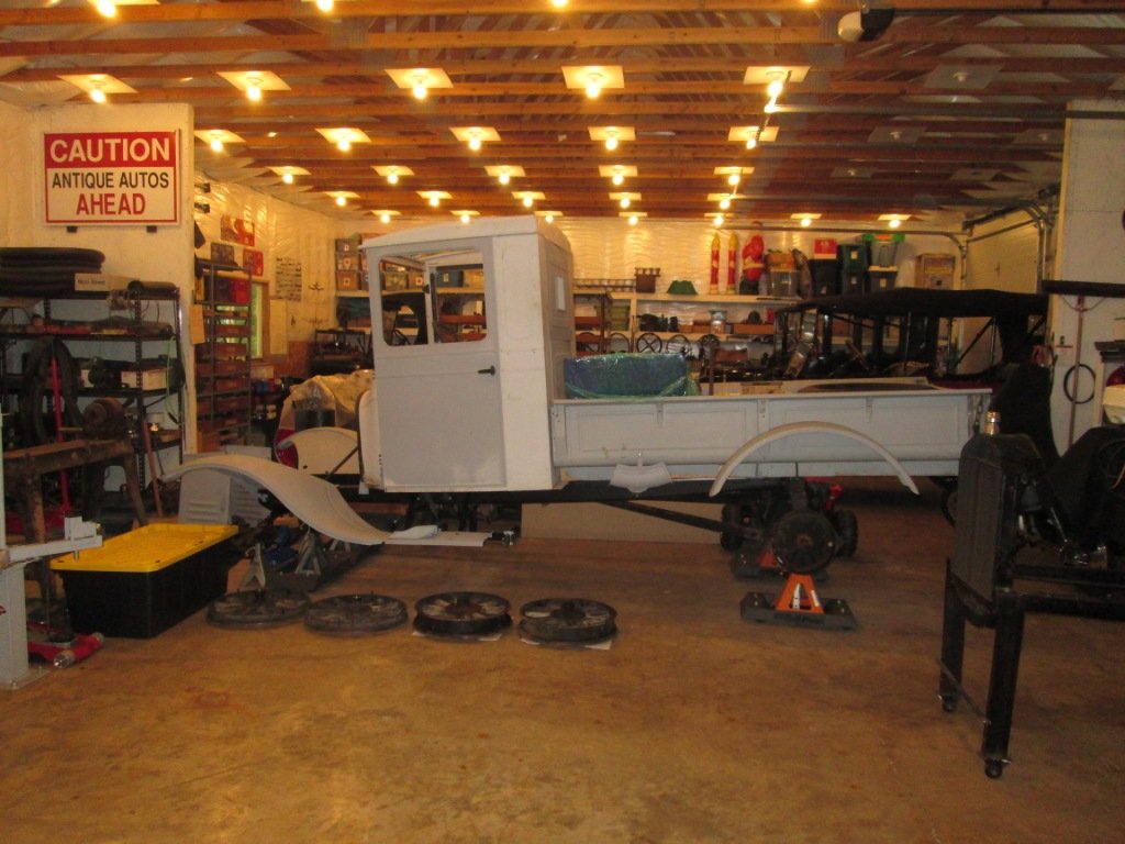

Not mine but helping a fella with a "sentimental" TT project - fired off the rebuilt engine yesterday - next is chassis restoration & new rubber.

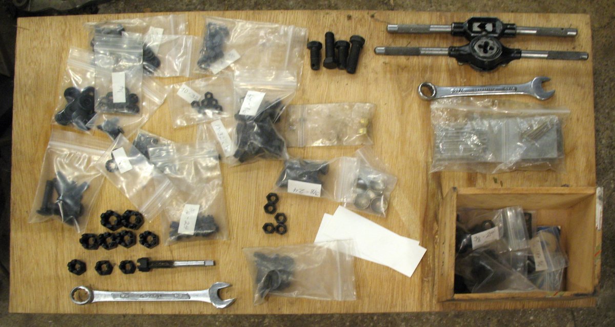

This morning I finished my box of spare fasteners to carry under the seat. Nuts, bolts, and washers are stripped of cad plating, etched with phosphoric acid for paint adhesion, painted, and baked for several hours at 180º. Threads chased with taps and dies. Size ID tags on small bits of card stock are in each bag. 5¢ casting plugs and three sizes of cotter pins are included. With all that, I've probably forgotten something.

I do not see any valve stem parts or repair tools.

Right. All the tire stuff is in its own box.

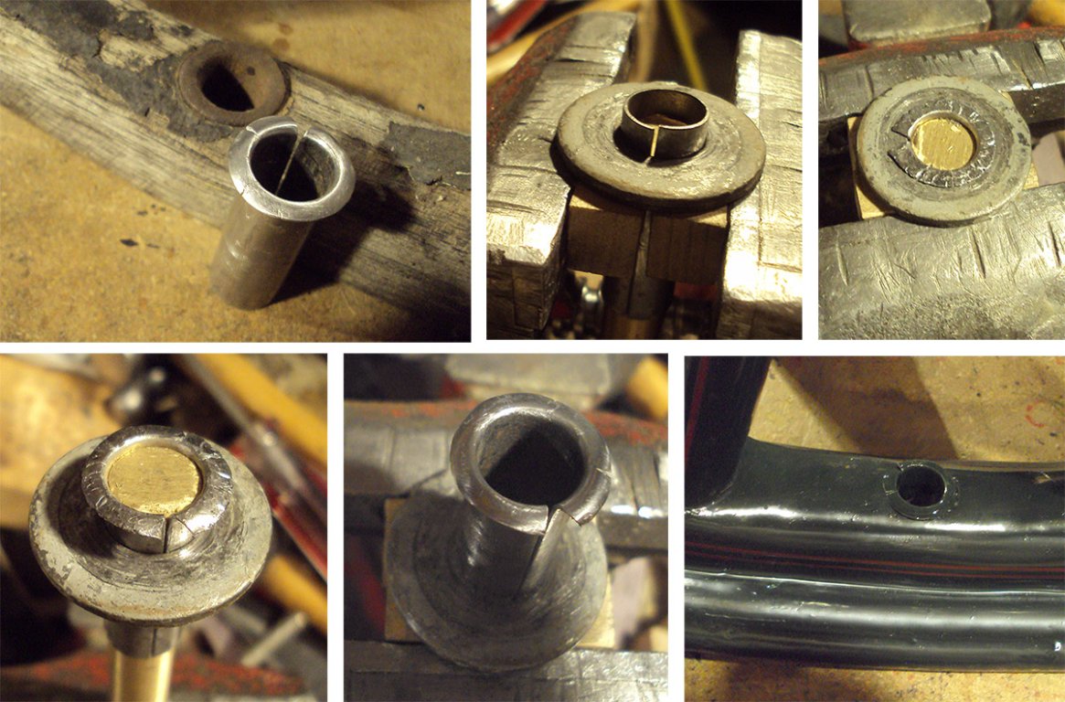

Today I made one of these. Not wanting to search for the right size tubing, I just rolled some 22 Guage and hammered it over. The notch won't show with the stem nut in place.
Quick and dirty gets it ready for the tire. I'm sure some work fine without them.
