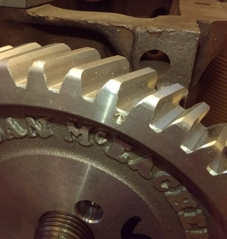

I can certainly add a notch in our timing gears to allow you guys to clean out your oil lines, but from a functional standpoint I don't think anyone would be pleased with the result. Seems Mr. Ford located the oil line hole pretty much in line with the rim of the cam gear, which unfortunately is where the gear teeth are located.

As far as manufacturers smartening up and drilling holes, maybe they already pointed out that to drill the hole, you'd essentially be removing a tooth, and they even supplied a picture pointing out that fact.

After getting some good and better information about the location of the oil hole that’s the reason using a speedometer cable to get access to the oil hole that’s in between the gear teeth would be just as good as air that Ford used in the manual. I don’t know if a small flexible cable could be had in the 20’s but since air was available that’s what was used in the manual. These days if the oil line gets stopped up it would be unusual since T engines are being cared for more than they were years ago overall.
But I could be wrong like I was about the exact location of the oil hole.
