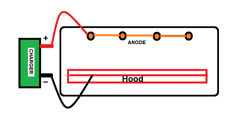

You might try an electrolysis tank, its easy to make and its known to also get the rust out of internal surfaces. One hinge at a time. I had a door latch that was rusted internally and no amount of WD40 etc got it loose - the tank did can't find the pictures
Here are some instructions https://www.secondchancegarage.com/publ ... emoval.cfm
I made one using some rebar as the sacrificial anode, You only need about 1/3 cup washing soda for each 5 gallons of water or 1 rounded tablespoon of soda per gallon. Too much is not a good thing - can burn at the charger , which needs to be a manual one not one that auto shuts off when the battery is charged - a dumb trickle charge will also work

I second the electro tank - that has worked miracles where others won't work... Once you get it apart, you'll need to paint the hood panels again it as it will leave the steel bare as a baby's bottom, but it will kill the rust. There are normally other considerations when using electrolysis (such as hydrogen embrittlement - bake in a hot oven 400 degrees F for an hour, trust me, your wife won't mind, especially if she never finds out :lol: ) and it is caustic (caution for aluminum hoods!!), but it will whack the steel to steel rust. Scrub off he black crud, for the bare rods, follow those up with an application (first) of Kroil, and then a good quality oil.

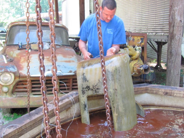

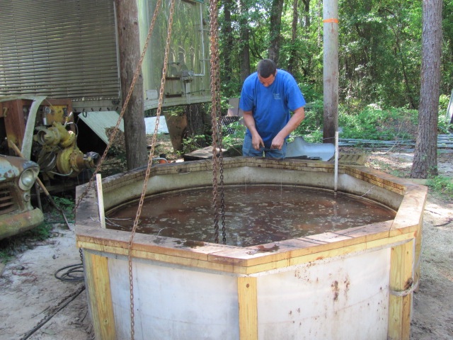

Post by DanTreace » Fri Jun 23, 2023 8:19 am
Simple, safe, and effective for your rust on those hood rods.
Molasses and water
Just get a 1 gal. of molasses and a shallow plastic tray, long enough for the hood length. Soak in a 1 gal : 2 or 3 gal. solution of water and in a few days the rod will be free of rust. Have used this method for rusty hood panel with stuck rod, after apart, sanded the rod and coated it with Slip-Plate, the graphite paint, hood raises easy and no sticky ever again!
Thought about Molasses to but never had the ratio of molasses to water. Also GREAT IDEA of slip-paint on the rods !!!!!!!!!! :idea:

The mix ratio can vary, first tried 2:1 water to molasses, 1:1 seemed too thick. So yes, mix and temp are considerations.
But net effect, sure is great at rust removal, safe for operator and the environment. Got the first idea to use from a visit to a hot rodder friend, who rebuilds for others too. His tank is huge plastic, and with chain falls over, can lower in large parts at a time.
And works on fine delicate items too :D
