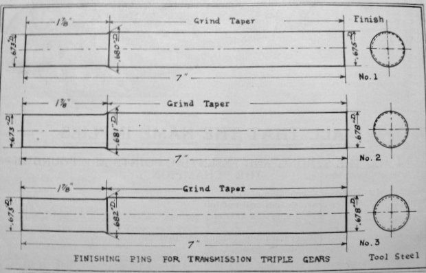

Ford Service Bulletin shows how to make a series of progressive larger tapered burnishing tools to size triple gear bushings and encouraged FORD agents to thusly treat all bushing replacements in this manner. Drawings with dimensions was supplied and FORD recommended that the burnishers be made from an old axle or a good tool steel.
The final bore diameter of the bushing would be somewhere shy of .682 as that was the finish size of the burnishing tool and there will be some spring-back in the bronze material. Additionally, the bore of the bushing would have a layer of very densely compacted material, a feature which is lacking in today's repair(s) along with the bushing being tightly swelled into the gear.
For Info: Factory drawings show ground pins to be .6775 at maximum material condition
Assuming a burnished bushing finishes at nominal .6815 and ground pin at maximum size of.6775, one would expect a total clearance, as repaired, of 0.004" or .0045 if the pin was at minimum diameter
I personally do not need further documentation or opinion as to what the "correct" clearance should be (for my personal work) as FORD documented all of it and I doubt that they were swamped with come-backs for spun bushings

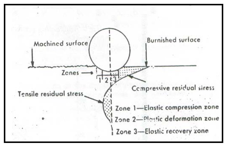

Now I'm getting in over my head. I've never studied ball reaming. Can somebody describe/explain it or direct me to a source (preferably illustrated) that does? Google is not being helpful on this one.
- Posts: 8643
Re: Seized triple gear bushing: Why?
I believe it amounts to a mechanical hardening and sizing procedure.
Neither reaming nor honing will give the same result.

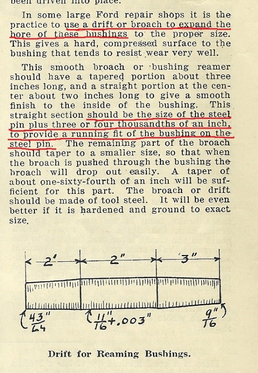

On the broaching subject, this is an interesting tool published by Murray Fahnestock in article with Ford Owner Dealer.
Gives note of the clearance for the .002" running fit, to make the broach .004" larger than the triple gear shaft.

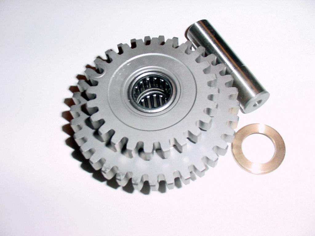

I was the first to use Dans needle bearing triple gears in my overhead powered speedster. Over 25 years and no problems Im sold!!!

I don't dispute that Murray did this piece that you posted, but do the math!!
the result is a hole which is .6905 which is wildly oversize
somewhere between Murray's notes and the publisher's ink, something went badly awry!
Even FORD documents (not drawings) have minor errors creep into publication, but I'll stick with what they published in the service bulletin that I posted above. It clears up the dimensional controversy and results in foolproof parts (but boy, do Dan McE's gears look nice! They may well be my next ones)

Yes, that 6905 (11/16" + 003) dimension is quite gross. the factory spec after finishing was .6785-.6790. Yes, 4 digits accuracy and I do believe Ford was was able to hold to about 1/2 that range.
There would of course been a spring back factor from the mandrel if mandrel swedged, but at best probably something at the 4th decimal place? I just don't know. That STILL leaves way too much.

He also makes these.

"Running Fit" is a class of tolerance
Running or Sliding Fit can encompass any one of 9 sub-classes of fit from RC1 (Close Sliding Fit) all the way to RC9 (Loose Running Fit). FORD's ".002" Running Fit was likely an early equivalent to RC7 Free Running Fit or RC8 Loose Running Fit
Using the below calculator and entering ".677" for "nominal", "RC" for Running or Sliding Fit, and then either RC7 or RC8 and by going down to the "FIT" section, you will suddenly see that your final clearances are on a much looser side than you would imagine. Given that FORD's smooth broaches gave a nominal .004 clearance, and .005" clearance was at max limit, I'd imagine that FORD's class of fit would be defined today, by ANSI B4.1, as the upper limit of a RC7 Free Running Fit that is defined as ".0045" at it's upper limit.
FORD's ".002" was never a tolerance or final clearance fit - it was part of defining what class the "Running Fit" was.
https://amesweb.info/fits-tolerances/an ... lator.aspx
