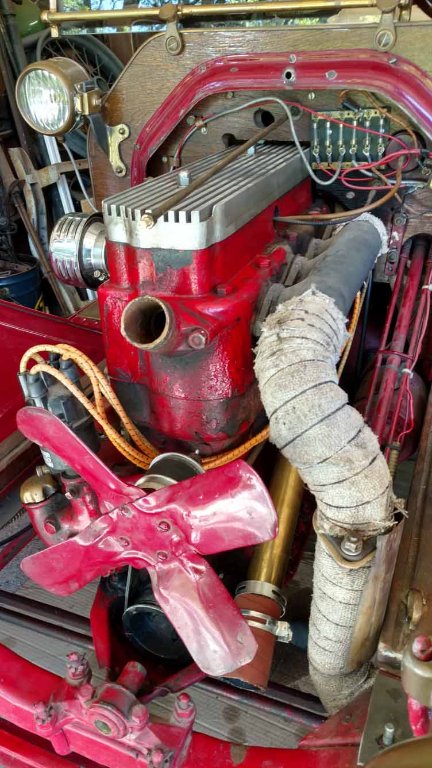

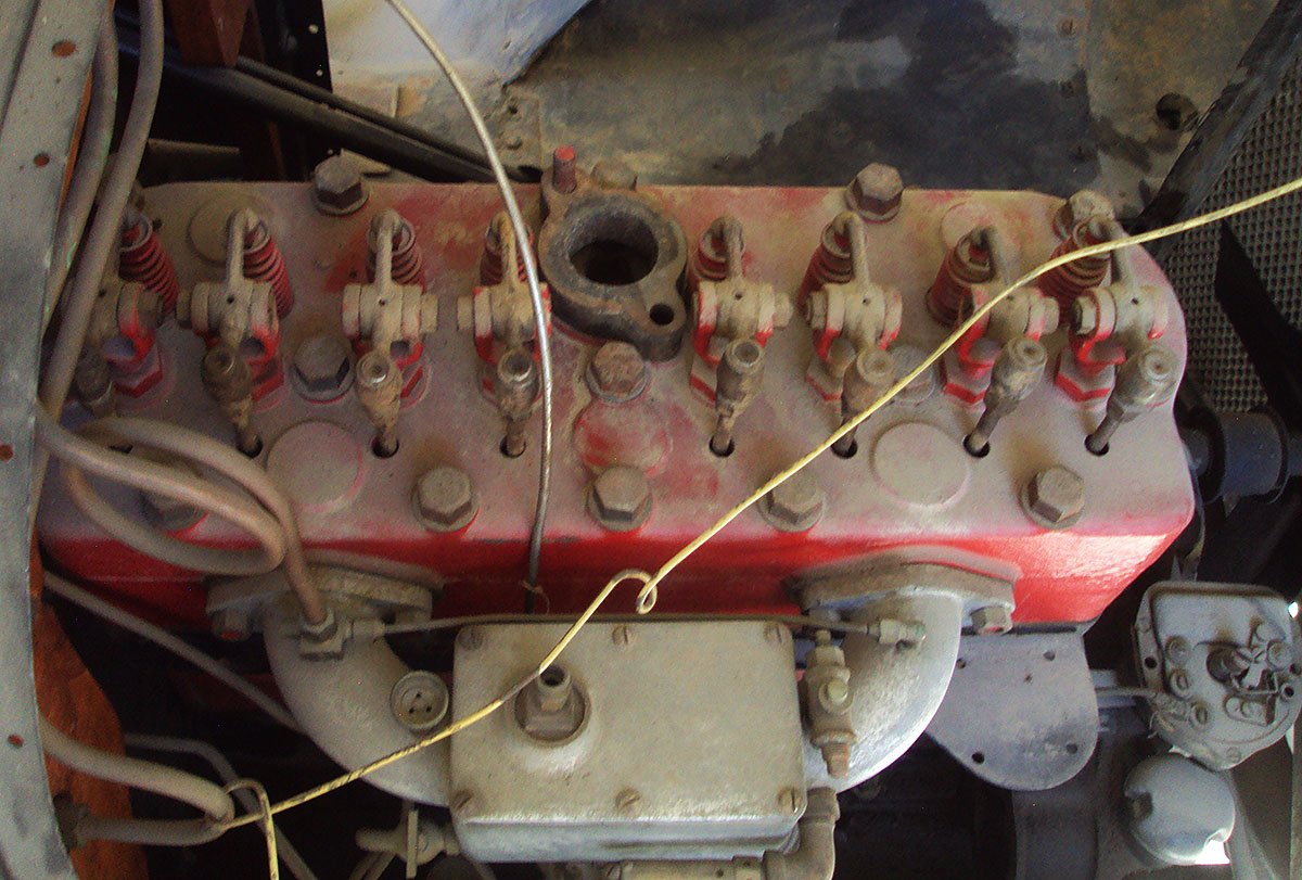

Post by Rich Eagle » Tue Jun 27, 2023 1:44 pm
I can't seem to find the make or model of this overhead setup. Most rockers are on shared shafts rather than separate standoffs.
I don't see a outlet to the radfiator either.
Curious.

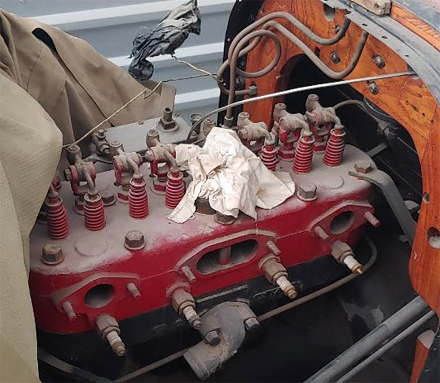

Re: What Overhead is this?
Post by ThreePedalTapDancer » Tue Jun 27, 2023 7:02 pm
That’s interesting. It looks familiar but I can’t place where I’ve seen one before. It has subtle similarities to Rajo but it’s not. I believe the water outlet is in the center where the rag is stuffed, and a pipe/water manifold led to the radiator inlet. Hmmm

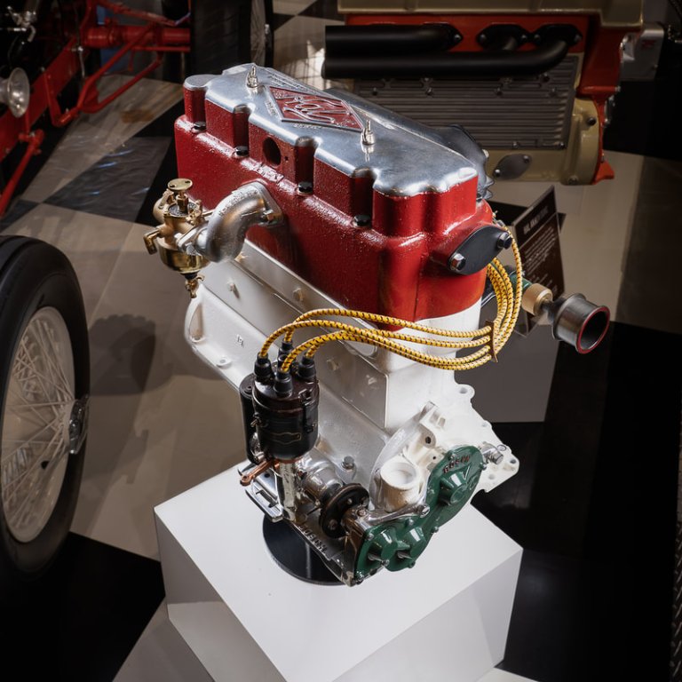

Might be a HAL conversion without the rocker cover.

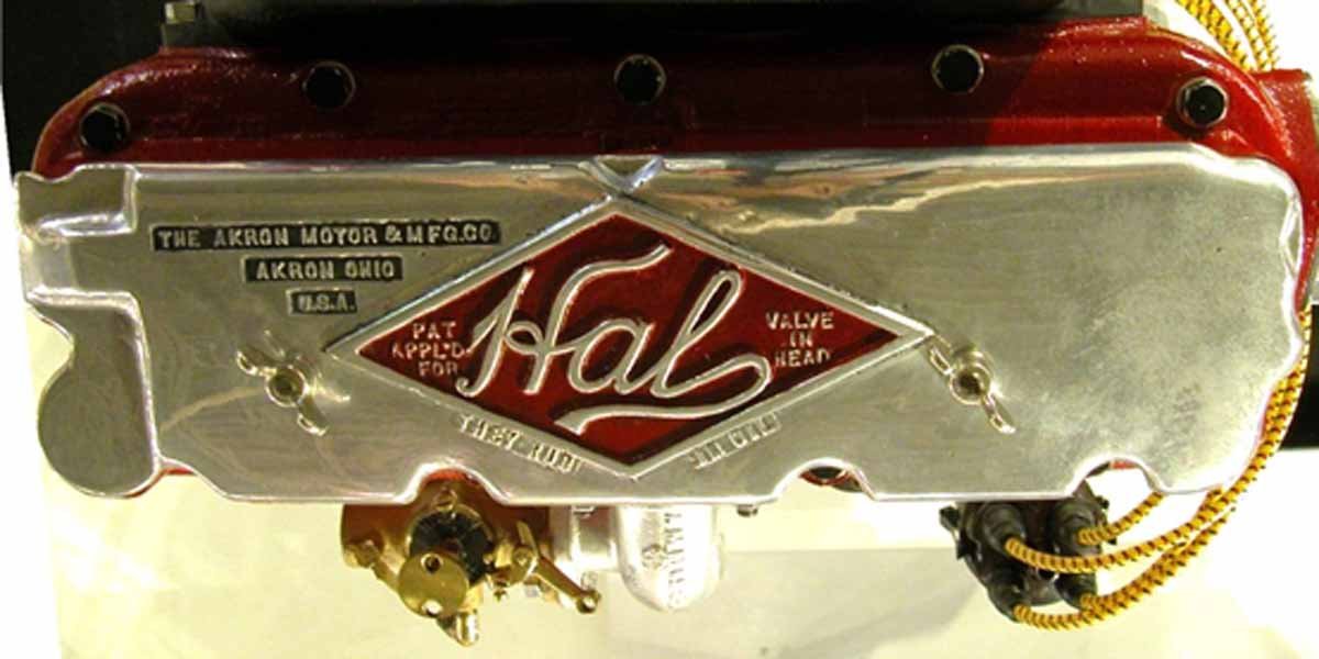

Post by Kevin Pharis » Tue Jun 27, 2023 8:19 pm
The only HAL heads for a T that I know of are the earlier production “run in oil”, and the Akron-Hed. Definitely not either of these.
These same pics surfaced a while back… and as I recall did not get identified. I was just cruising the Speedway museum a couple days ago, and did not see anything with exhaust ports like this one. It’s a neat design, sure would like to see more of it!
Post by T4Tom » Tue Jun 27, 2023 9:15 pm
It looks like the head is mounted backwards! The red arrow is pointing to what looks like the water outlet flange.
Tom
Post by Rich Eagle » Tue Jun 27, 2023 10:11 pm
Thanks, I will try to get some more pictures of it.
Post by Dan Haynes » Tue Jun 27, 2023 10:16 pm
No, it can't really be on backwards; the cam is on the right, the rockers have to stay there, too.
Post by ModelTSpeedster » Wed Jun 28, 2023 7:51 am
Here is the HAL version.

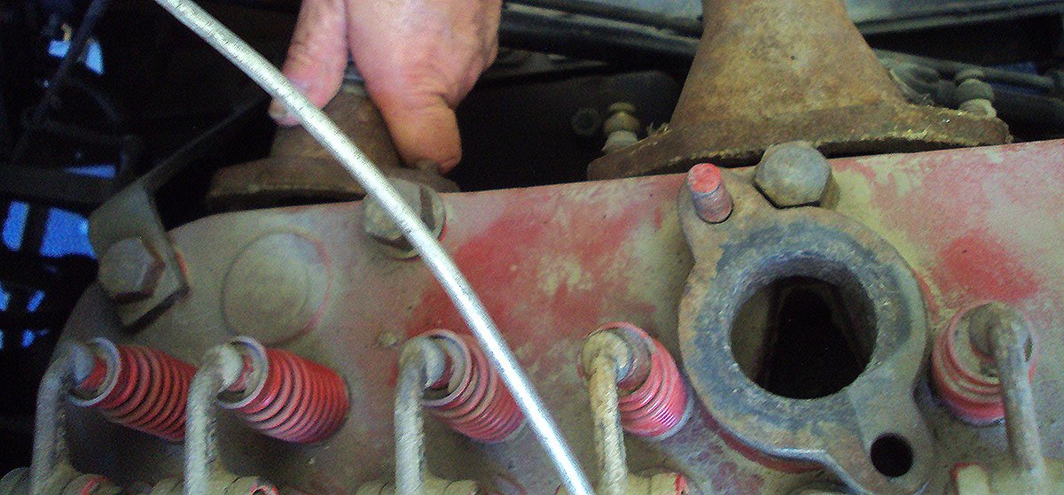

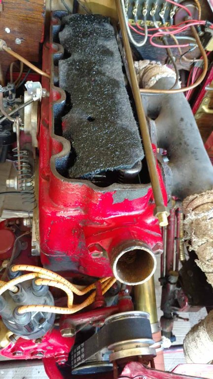

Post by Rich Eagle » Thu Sep 07, 2023 5:13 pm
I answered the question of "where does the water exit the head". It is in the top and center and was obscured by a rag in other photos.
I can see no markings or name to who made this head. It may be early with the somewhat crude rockers and standoffs. The push rod adjustments seem like an earlier idea too.
Anyone else have any thoughts or information?
Post by Henry K. Lee » Thu Sep 07, 2023 5:53 pm
Looks a lot like an early Liberty Head.., They were used on boats for the most part. Thats why there is a center return on the water outlet. Not very efficient for a car with a radiator since early boats used a forced scoop system.
Post by kmatt2 » Thu Sep 07, 2023 8:51 pm
I thought the exhaust ports looked a lot like a Robert Roof head I saw a long time ago, but I wasn’t sure. Robert Roof also used the name Liberty , so that would be another name for the same thing. With the stock T water inlet location in the block and having the water outlet in the top of the head , it could be problematic in getting good cooling in the rear of the head if used in a car. In a boat engine that cooling would not be problematic because of the constant cold water intake and no radiator.
I am sure it could be made to cool ok in a car with some sort of baffle and maybe a water pump.

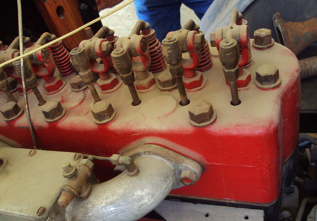

Roof liberty? I have one here, 3 port exhaust, front outlet, 2 port intake.
Post by Rich Eagle » Sun Sep 10, 2023 6:56 pm
FWIW, REO used similar rocker arm mounts with the yoke and threaded into the head for several years. Rollers on the rockers is interesting.
Post by OilyBill » Sun Sep 10, 2023 8:19 pm
Rockers appear to be on individual stands and separate, not shared.
