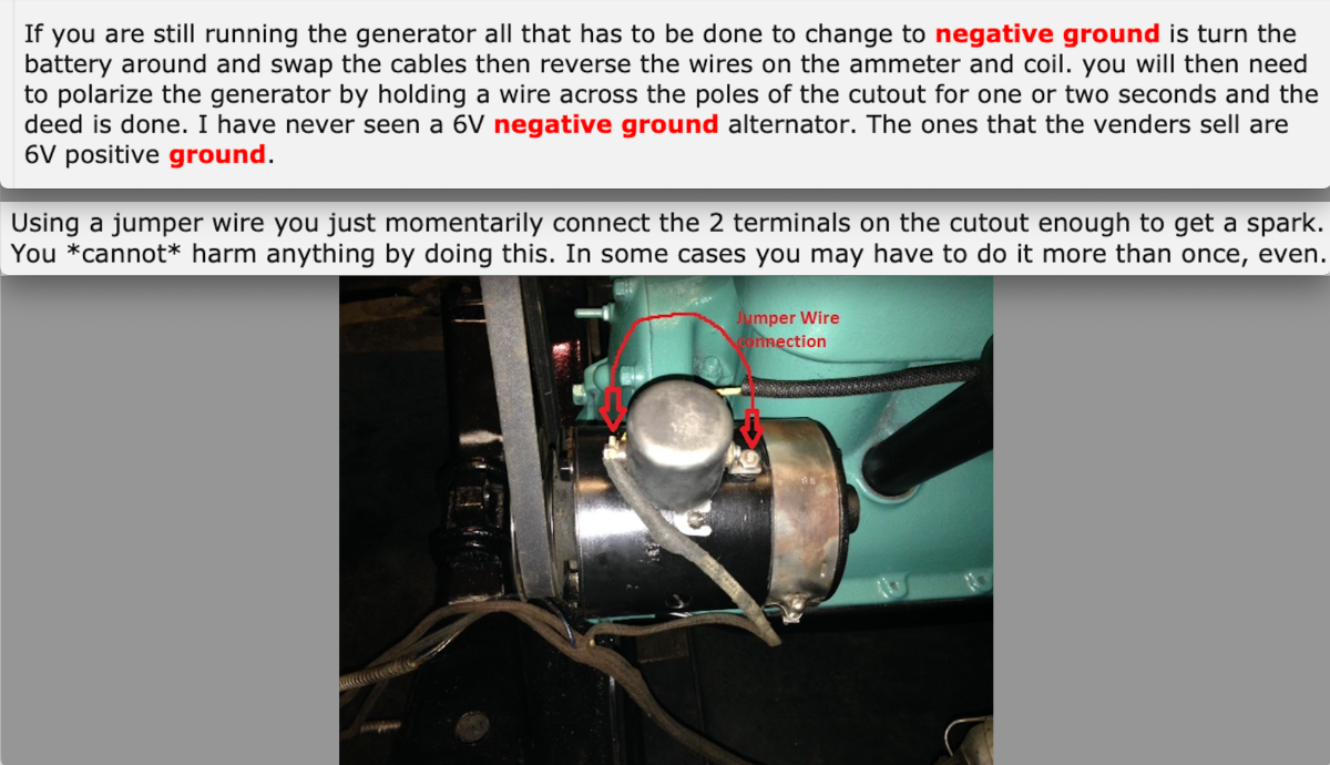

Should you want to revert to the factory setting of "Negative Ground," make certain that you reverse the battery, negative terminal to chassis ground and the Battery Positive to the starter/generator terminal.
"Polarizing a generator is telling the gen. how the battery is hooked up. Positive or negative ground. It is done by using a short piece of wire and touching the post coming out of the generator(which is connected to one side of the cutout switch, and holding the wire to the other side of the cutout switch, for about 3 seconds. You will see a slight spark when you first touch the terminals. The wire on the other side goes to the battery and thus the generator sees which way current needs to flow."
The best advise here repeat. Keep as found.

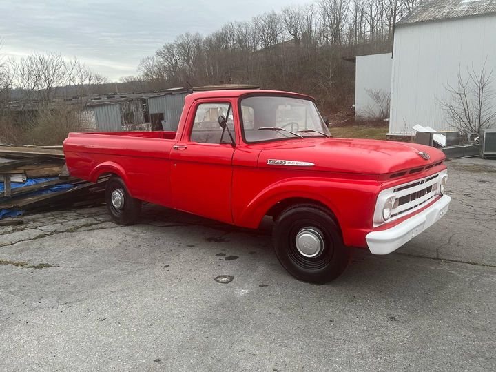

Re: Model T on Positive Ground?
Ford, for what ever reason, was using Positive Ground even into the 1960s. This 1961, F250, 292 four speed has 12 Volt Positive ground. And it came with no power steering, power brakes, no seat belts, one visor on the drivers side. No air condition...just hand crank windows, window vents, and kick panel air vents. Heater was an option. A step up from a TT.

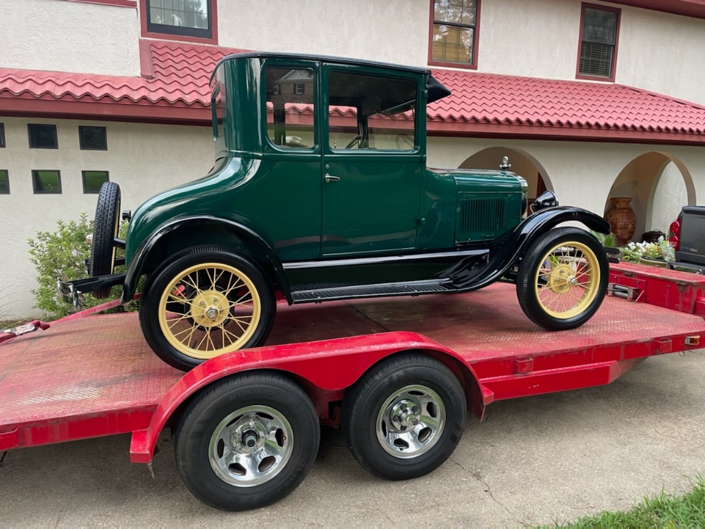

Thanks to everyone who has replied. You guys are all an incredible source of information. The car was restored about 10 years ago and has essentially sat undriven since then. It has been converted to a distributor and retains a 6v system. With the key on, before the engine is started, the ammeter reads in the negative. When the car is started and running, it reads in the positive. The positive lead is a braided cable and goes to ground on the frame. I changed the spark plugs this morning and the motor now idles and accelerates well for a 96 year old car. The transmission bands were replaced a week ago (kevlar) and it is my opinion that they were adjusted extremely loose….next project![image][image][/image][/image]
- Posts: 6708
WOW!
nice buggy...congratulations

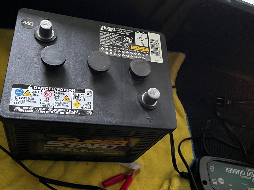

The engine turns over slower than I would like when cranking and the battery is of unknown age so I am just going to put in a fresh new Group 1 6v battery this morning….positive ground.
I don’t have any intent to swap to negative ground nor convert it to a 12v car. “If it is working, don’t screw with it” The question on the positive ground came from my understanding that the entire run were negative ground cars. My post was just a question out of curiosity.

Clean all wiring connections between the battery and the starter. And make sure these wires are large enough.
I find that a 6 volt group 1 battery easily starts my stock 1923 touring car. This is after I cleaned connections and the starter switch.

To Been here before : That is a beautiful 1961 Ford pickup, but when it left the factory it was negative ground, as were (and are) all American 12V electrical systems. You will have to go to the Brits to find a factory 12V positive ground electrical system.
Edit: Ford switched to 12 Volts negative ground for the 1956 model year.

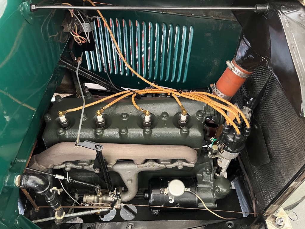

- Posts: 6540

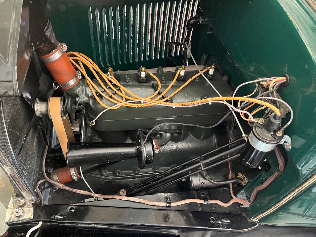

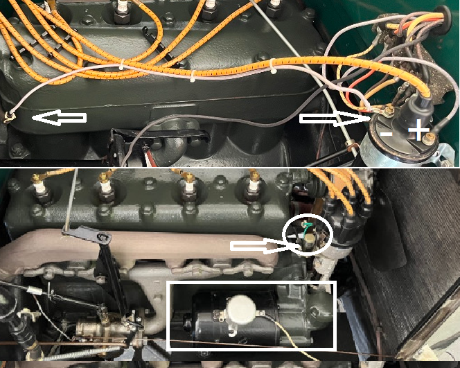

Others need to way in on this but looking at some of the wiring I'm thinking your identification of it being positive ground is correct based on the pictures provided. So if you or someone else would change things its good to know what you have and what would need to be changed.
1. The cut-out on the generator appears to be a Model A cut-out. They usually have an extra set screw on the end connected to the generator post. Model T' cut-outs didn't have that . But you never know- need to follow where the yellow wire with black tracer goes.
2. The wiring for the distributor (Texas T?) appears to be consistent with positive ground but hard to confirm from the wires around the coil and where they go. The wire (green) running from the coil to the distributor condenser & zip tide to spark plug wire appears to be in a white harness wrap.
So while the chassis may be positive ground, some things may be wired to the positive terminal of the battery and not relying on the ground

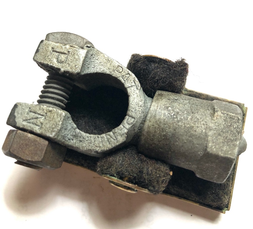

In 1922, the Electrical Journal for December (p. 523), has a discussion that telephone systems using dry cells were able to reduce corrosion if the polarity was reversed -- positive was the ground. Too automobile manufactured thought the reversal to positive ground would reduce miss firings. But the change (1922) was not accepted by many.
- Posts: 4042

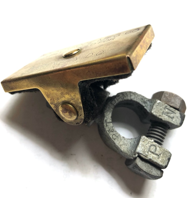

Prior discussion was because gasses of bubbling electrolyte, from the storage battery upon charging/discharging, corrosion tends to collect at the positive terminal on the battery, causing poor connection and reduced voltage.
Ford engineers decided to ground the positive terminal of the battery to the frame, to minimize corrosion that would form on the battery positive terminal. Interesting fact is inside the storage battery, electricity flows from the negative plates to the positive plates, and externally from the positive terminal through a circuit to the negative terminal.
So using a absorbent pad or covering the positive terminal of a wet-cell storage battery with vaseline will help prevent such corrosion. Or....use the sealed Optima battery! No out gassing!
Period No Krode brass cover with wool pad soaked in vaseline.
