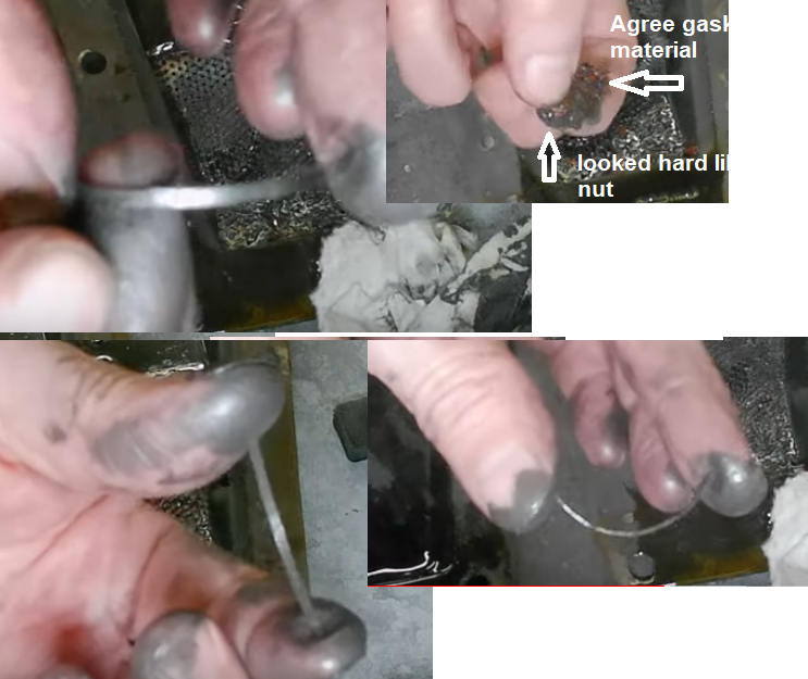

Ok found this thread again, thanks for the pointer. I checked the oil and I did not find bronze in it. I did find something though. I'm leaning towards the triple gear theory above, not the spiral crack theory. IDK - I can't remember it happening in low, just reverse pedal. That would pull the assembly backwards away from the flywheel wouldn't it? Possibly tilting the triple gears? EVERYTHING was brand new from 2007 in this engine. And everything was the top of the line as well. No corners cut on this one. I originally built it to sell but then I cracked a low drum in the original engine and in my car it went about 3 days before I left for Indiana in 2008.
Oil change, inspection, what I found on the magnet in this video: https://youtu.be/zX94LINIYHk

Here is what he found in the oil. I'd drop the inspection pan, there may be more things to find there...TheSpeedsterProject wrote: ↑Thu Mar 23, 2023 9:12 amOk found this thread again, thanks for the pointer. I checked the oil and I did not find bronze in it. I did find something though. ........
