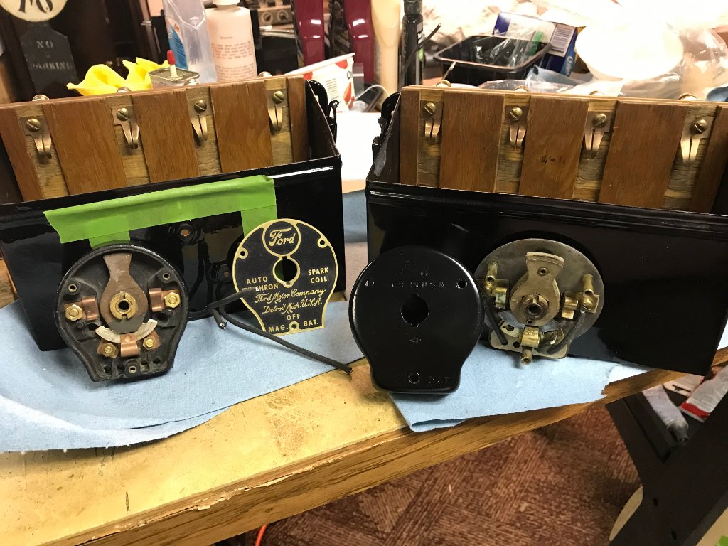

Two issues- It would help to understand what "coil box" you have. Wood or metal and even what style so a picture would help. I assume that the coil box is mounted to a wood firewall. So the Box is insulated from ground. To get a shock some wire , carbon track is making contact to the box which in turn is connected to the switch. Normally these are insulated. Now to get a shock with one hand on the switch another part of your body need so be grounded to the car - like holding onto the spider of your steering wheel. Is your switch one of the ones below. What condition is you box in?Skyler Kimball wrote: ↑Wed Jul 05, 2023 12:30 pmHi everyone, I have a strange problem that I hope you could help with. I have noticed that at certain times, my coil box switch will zap me quite hard, so recently, I have decided to just kick the switch off, but now I have noticed when I was checking wire tightness while the car was running, I got zapped pretty bad by simply holding the non metal center of the spark plug wire. Are these things normal, and how would I go about repairing these problems? I was thinking something along the lines of a faulty ground?
