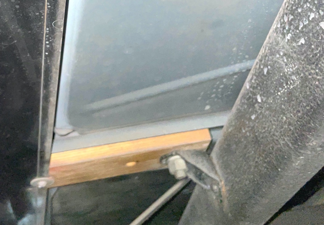

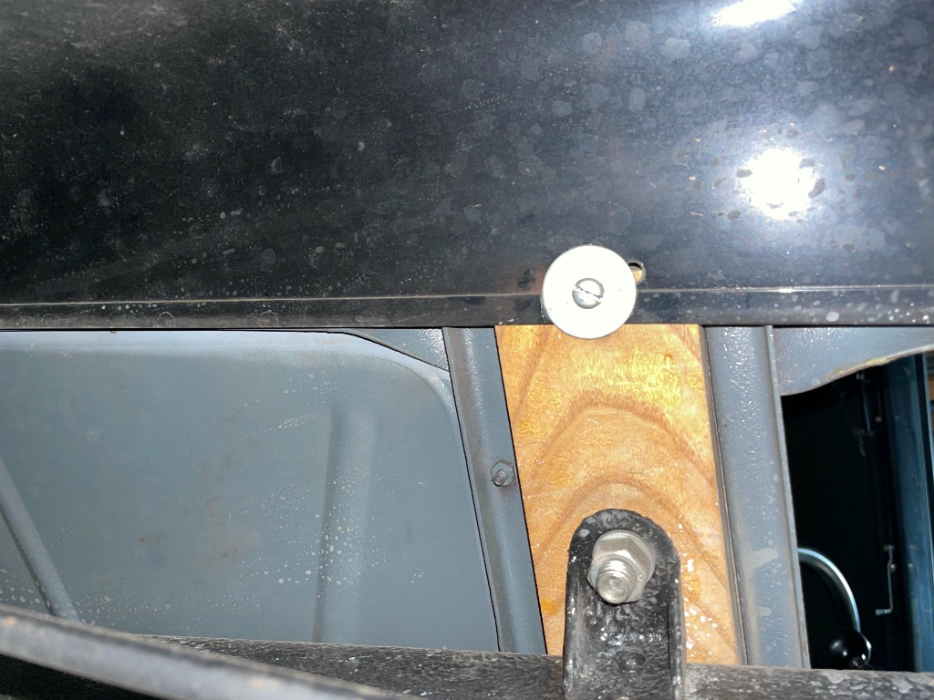

What would the bolts that hold the cab to the frame crossmember through the body blocks be called/identified as, as well as the rear ones that go thru those body blocks?

Are you referring to a car/roadster body or a TT truck cab?
If a TT cab. I can't find any specific factory numbers for those bolts, however, the factory drawings indicate that they are 1/2" bolts. No length is given, so you would need to have them to suit your particular body build. They would be carriage bolts.
For a car/roadster I can't find any part number or dimensions. They would be carriage bolts of length to suit the body.

The list covers only chassis parts, including Ruckstell and TT. Body fasteners are a whole other subject.

Car/roadster body….So where would one find info about these body to frame bolt sizes?

You'll need a Ford factory number to get the correct info from Benson Ford Research Center, but likely hard to do.
Ford Price List of Parts has some bolts listed for Fender Bolts and Nuts, but just part order # and price, no dimensions. Ford Price List of Body Parts doesn't list fasteners for the body/frame either. '
If doing a high quality restoration search out original cars to ascertain the proper fasteners. Have restored some '26-'27s but don't remember the actual fasteners, most times they are missing anyway unless the car was intact.
So measure the hole diameter in the frame brackets, and the wood blocks and use a rod to determine length overall. Then get a min. Grade 5 bolt, lock washer and hex nut, and all should be good. ;)
