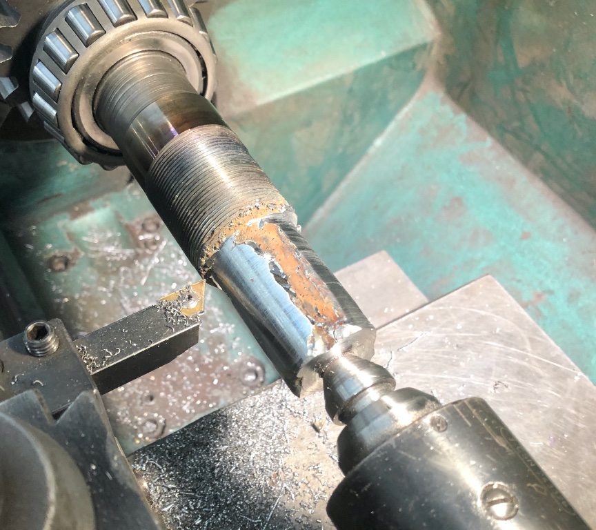

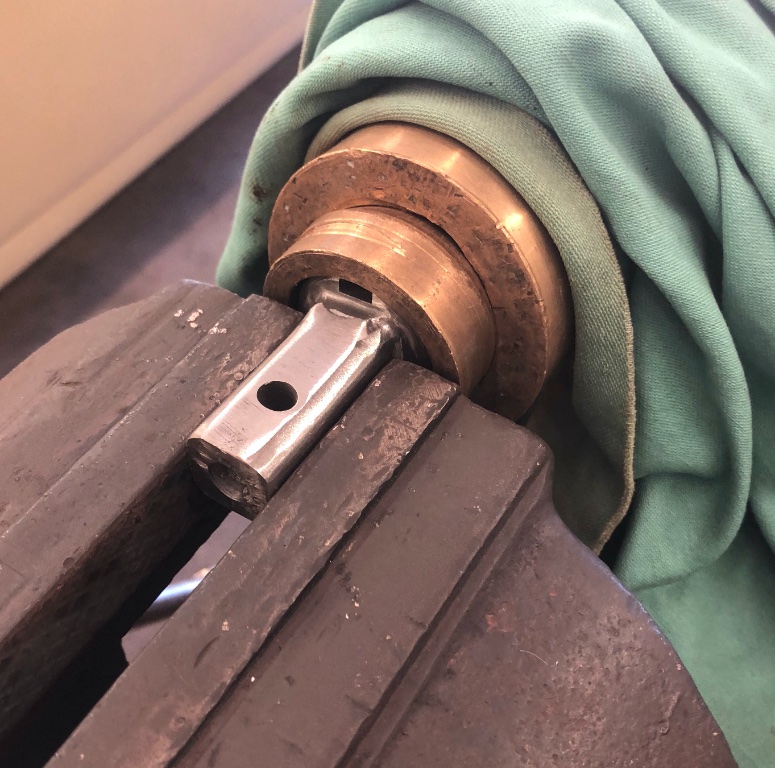

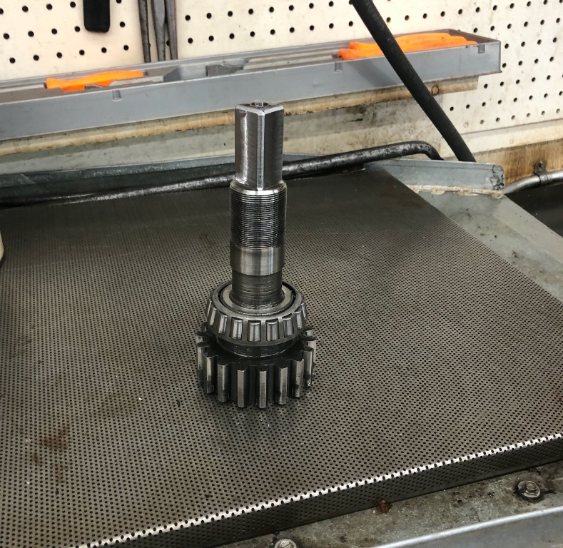

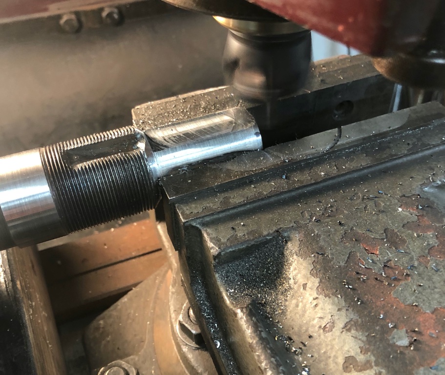

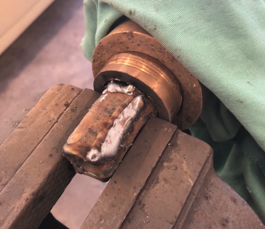

Use old school methods. Shunting the heat transfer with heavy brass, inoculating with carbon while keeping it as hot as possible. Old shaft restored!
4 hours later, DONE! Shipping back in the morning.

What is it exactly? Input shaft?
