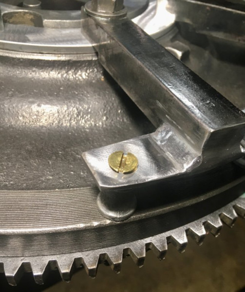

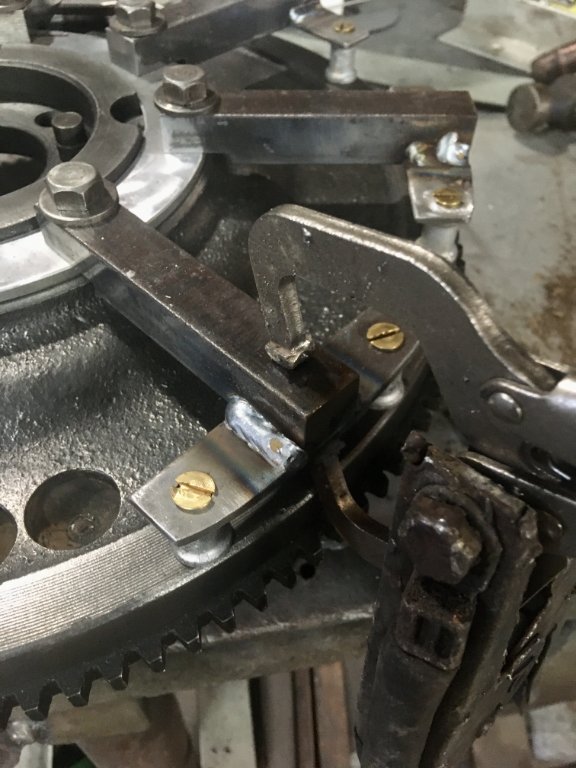

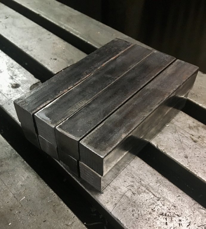

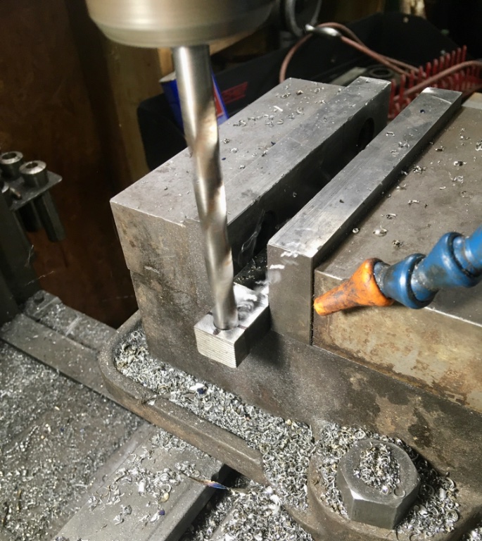

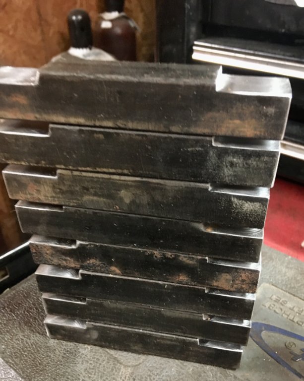

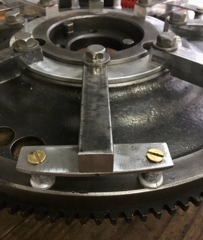

Tried my hand at building Oil slingersStarted by cutting some equal length 3/4 blocksNext milled off the edges. one side for the triple gear pin ring. the other for the mounting tab on the ring gear side.Test fit on the mounting tab. Used original spools and a new set of original brass screwsNext Welded itThen I gave it a smooth finish

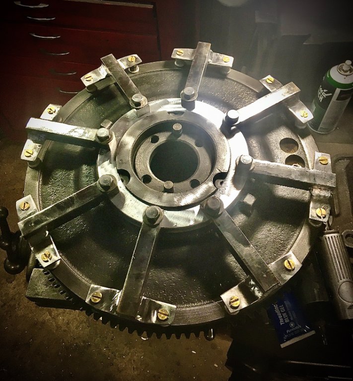

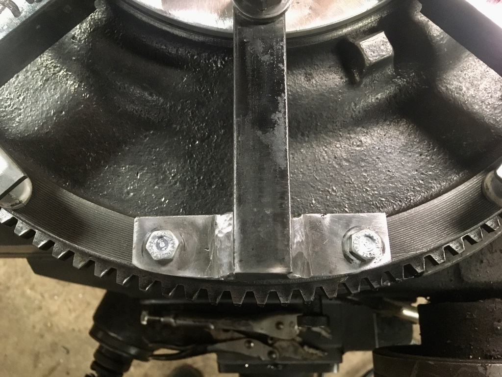

Then I assembled it all. I wanted to retain some of the flywheel mass so i used this method. it's about half the weight of the original magnets and the height is the same as the magnet to throw the oil in the same place as originally intended. hope you enjoyed!

Very nice, good idea to keep some flywheel weight for low end acceleration.
Only my 2 cents.. old brass screws may be weak point, they do snap off heads. Tap the ring gear and use steel machine screws and LocTite.
- Posts: 4460
Re: Oil Slinger Build
Make that 4 cents now. Even new brass screws, in that application, give me pause. Might also peen the ends to lock them in.

This is why I posted the build! Some good advice. I might ditch the brass. I did use lock tight and peened them. I forgot to mention. Thanks fellas

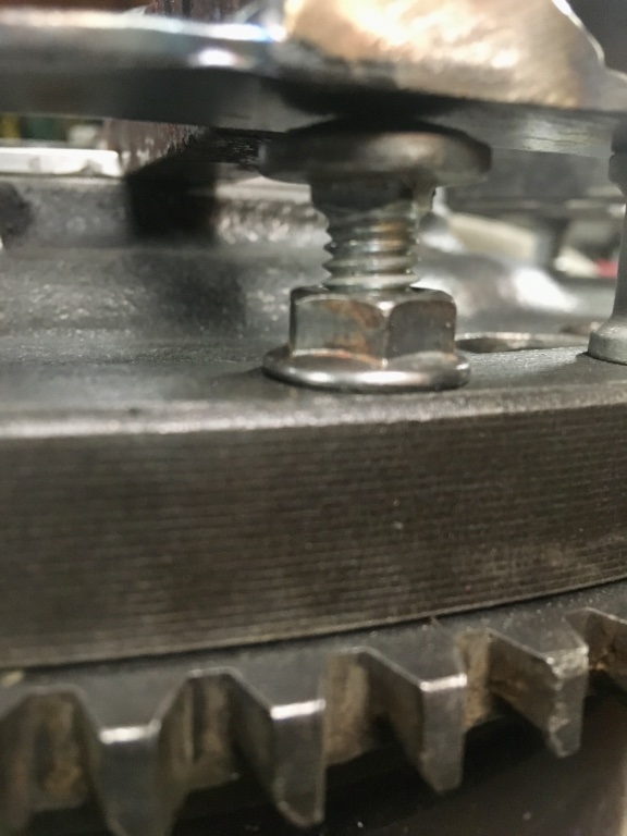

I forgot the drill the hole step
i used the original magnet bolts to secure them on the inside.

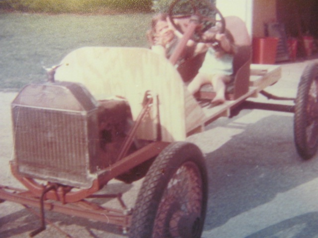

Did this '15 speedster way back when the my gals were tiny! Removed the magnets and added slingers, ran 12v DC to the vibrator coils. Std. axle ratio. Hand-cranked.
While this little thing was very lightweight, getting underway in low gear took a bit longer. Once going into high, sure it felt nice and fast. But believed then, and still do, the T needs that flywheel/magneto mass to have good low end grunt to launch.

The ones to use are 6mm x 1mm high tensile screws. They must be high tensile or the threads just strip and won't lock, as I discovered. Mine have been in operation since early 2011 without any problem.speedytinc wrote: ↑Tue Jul 11, 2023 2:39 pmThere is a metric screw size that works quite well in this application. The threads self lock.

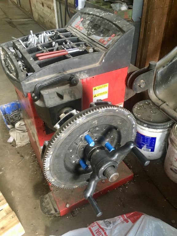

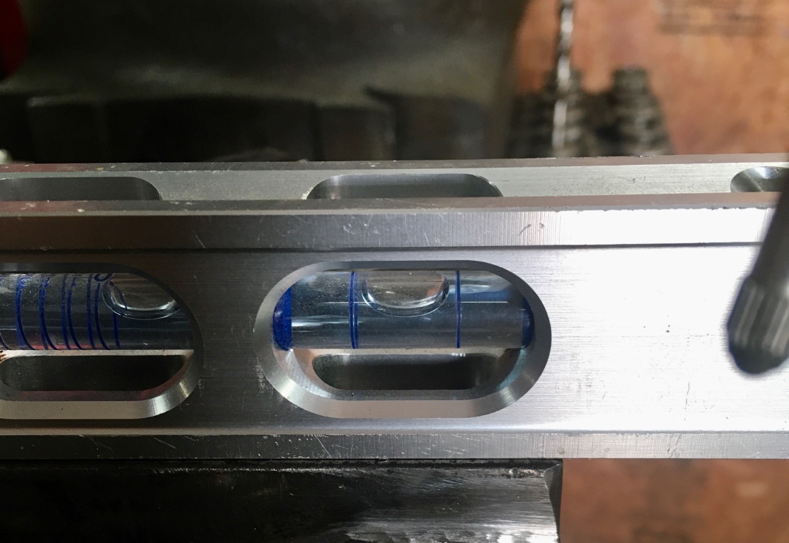

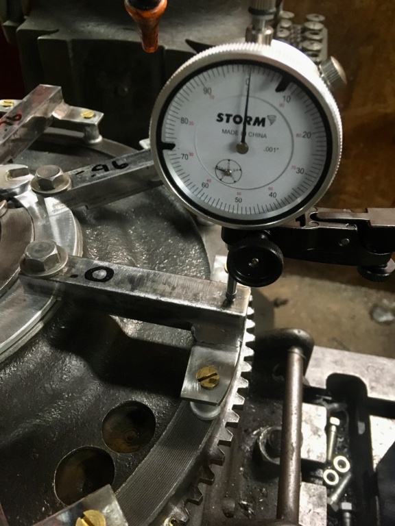

Thank you John I purchased 6mmx1mmx50mm high tensile bolts from our supplier on the farm. Threaded in perfectly with enough sticking out to peen over. because I can’t leave well enough alone I decided to indicate the slingers like one would do when setting magnets I started with a level slinger next worked my way around on the turn table on the Bridgeport adjusting to .zero with this little carriage bolt and nut a lot like adjusting valve tappets it brought everything to zero.then I spun it on the tire balancer because it was to big for the lathe and it appeared to turn wobble freenext will be balancing the whole assembly when I finish building the mandrels. Thanks for watching.
