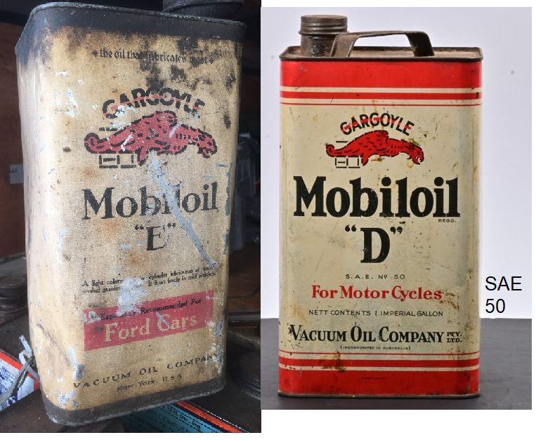

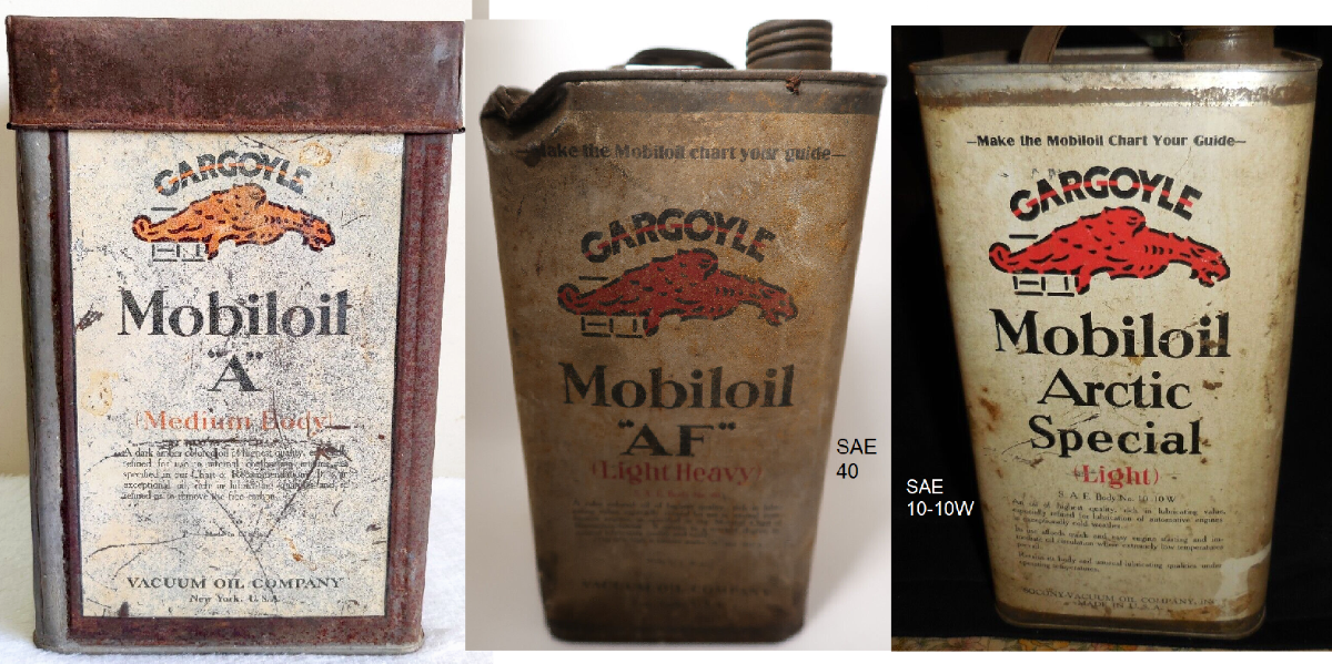

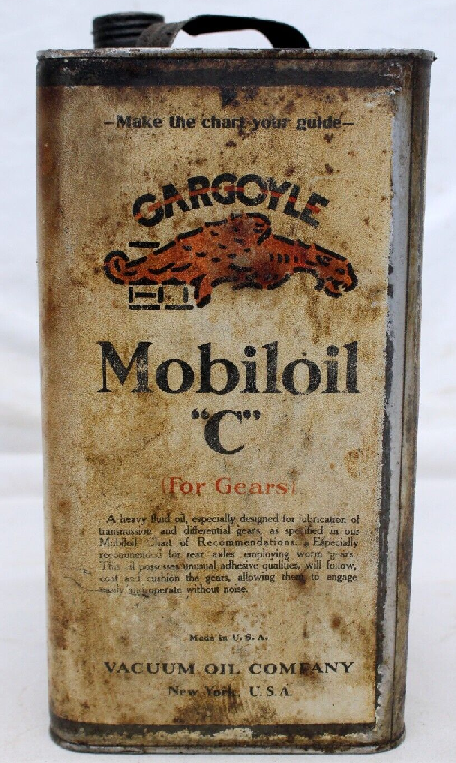

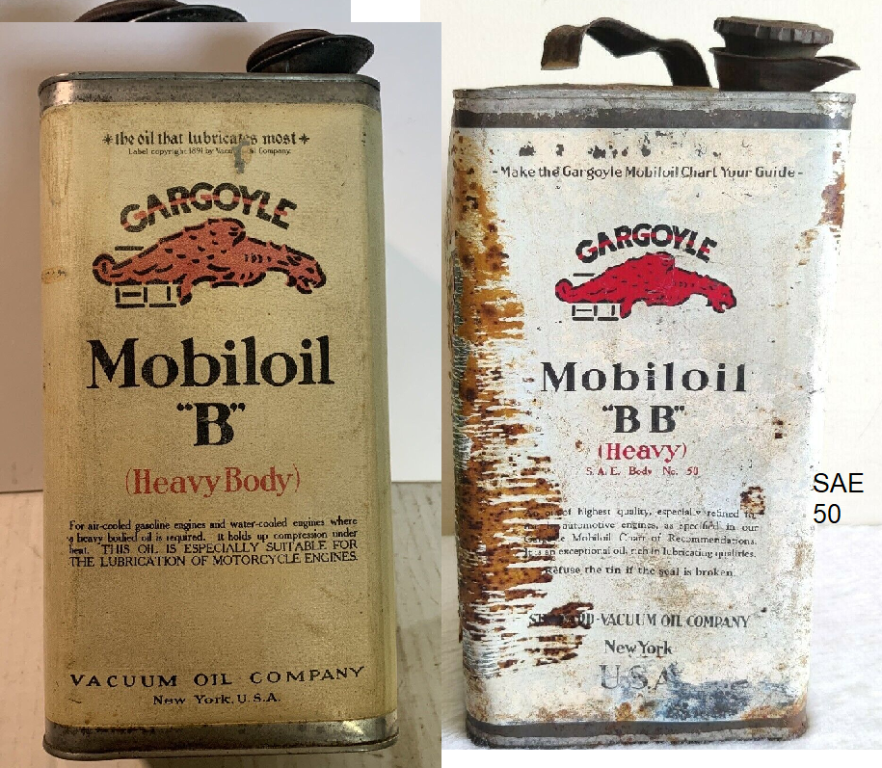

Searched the internet but couldn't find specific information so resorted to getting images of Original containers (Vacuum Oil Co) whenever possible. Some indicated viscosity
