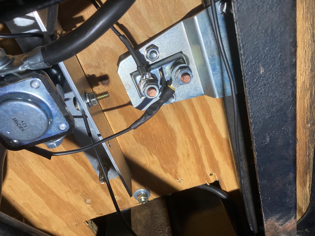

Mark, if you look at the attached photos, I have installed a starter solenoid. I’m checking the wire size but believe I put in #2 .
If you can give me some direction, I’m whiling to try anything. I’m tired of Hand cranking it. Don’t get me wrong, it normally startes on the second attempt.

If you hear a click in the solenoid when pressing the starter button and you're getting 12V at the solenoid output, I suspect the problem is the starter. I assume that all of your cable connections are as clean as the solenoid connection in your photo to support my suspicion. I think your original post and test method would be as good start to see if your starter is working.

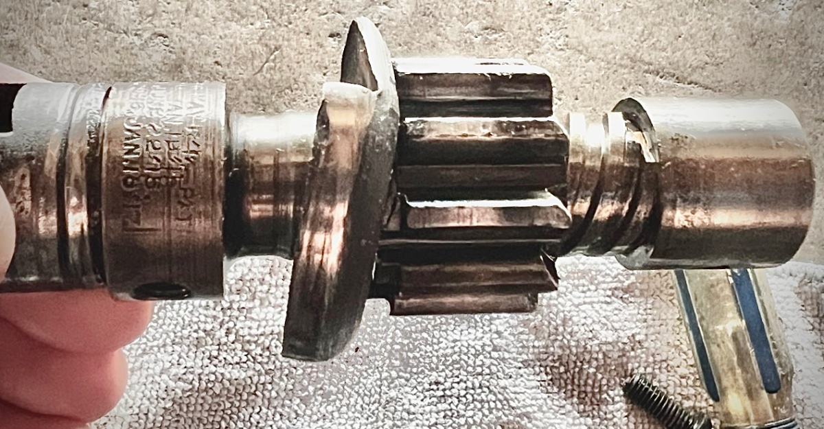

AdminJeff
Re: Applying power directly to a starter
Installing a starter solenoid is a terrific investment, especially if you have a 6v car. it's literally the first mod I did when I first bought my car. I highly recommend it.
Apply 12 volts to 6v starters and they may seem to crank better but there is a hidden danger lurking. 12 volts slams the bendix into the flywheel at an amazing speed sort of like a speeding bullet into a steel plate. It is only a matter of time before the delicate bendix gives up the ghost and obliterates itself, or worse, destroys your flywheel ring gear by chipping a tooth. The worst is yet to come though. Once those bendix or flywheel parts go flying, all kinds of mayhem can ensue.
I'll attach a couple pics of what happens when you apply12v to 6v starters. I got these from various customers who all experienced multiple problems. The call I got last week was that the woodruff key was sheared off and required replacement. The starter shaft was also bent after that.
As always, your mileage will vary.
