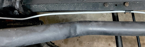

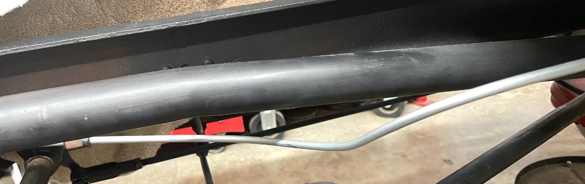

Haven't had that heated up tank before that caused any fuel line to carb issues. But image it could happen if the fuel line is rather close to the exhaust pipe.
The pipe where the fuel line is draped under with the factory bends, is hot, this thermal image shows the exhaust pipe area under the floorboards to be around 120 F., maybe more. (The thermal image is front right hand drive T)
If the fuel line is routed like stock, the curve keeps it rather away, min. 2" clearance, from the exhaust pipe to keep the gasoline in the steel fuel line a comfortable temp. FYI, if it makes any difference, I do run engine pans on all my Ts, could help a bit with some forced circulation of air from the radiator fan, but likely negligible. From the description of the hill climb, could have been one of those '3 gallon' hills, that need a least that much gas in the tank to gravity flow.
