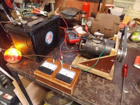

Jim,
I don't think you have problem with the magnets of your generator.
I should first clean all the connections on the wires starting on the generator and going to the battery connection. Check also the ground connections.
Than connect a 12V 21W light bulb between the generator output (not the cutout output) and the ground. Start the engine and watch the lamp.
If the cutout is not shorted to the ground, the lamp should just light up. Disconnect the wire at the cutout terminal ( pay attention this wire is HOT) and watch the lamp. It should become very bright. If you have no light your generator need a clean up or a total overhaul.
If the lamp lights up, test with a voltmeter (analog) the tension on the out put. It should be higher as 7V. Your cutout closes at about 7V.
As it take some time to show a charge on your amp. meter I think your problem is dirt.
Good luck
Andre
