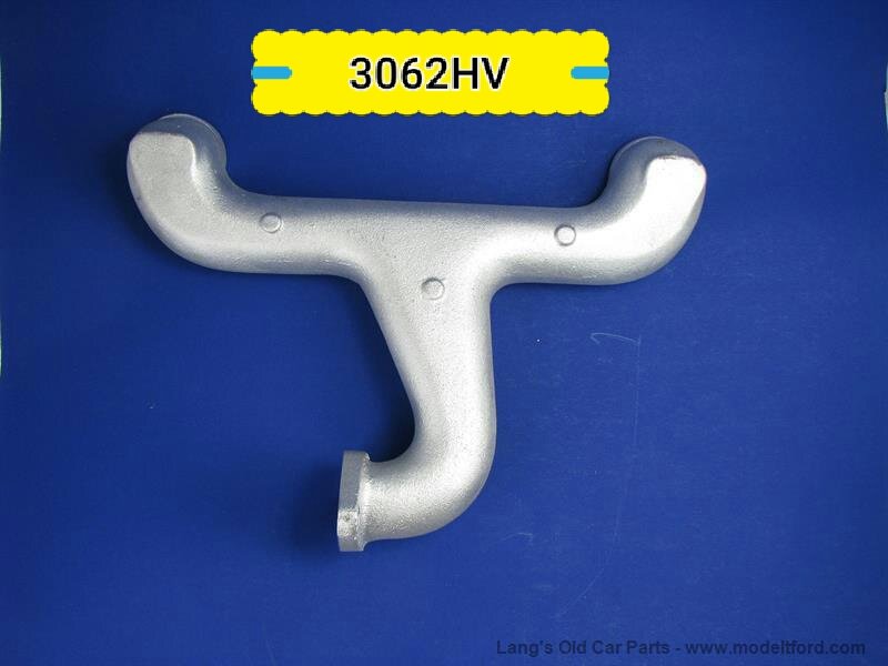

Hi flow aluminum intake manifold... anyone have any experience with one? Pros/cons?

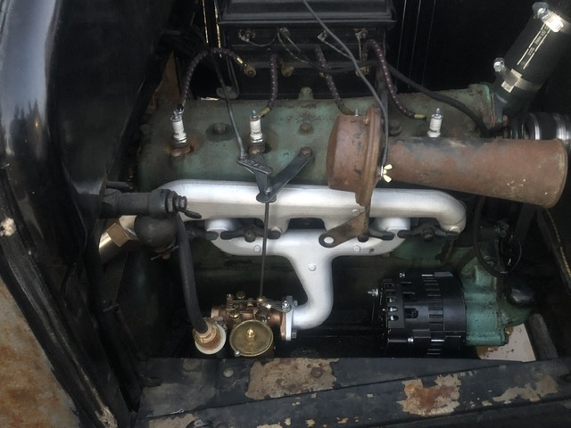

We, as in Australia do have a con, it is just wide enough that it has to be removed to get the generator out with the RHD steering in the way.

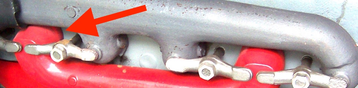

Only slight con.....at least on my install of the hi-vol intake. The intake flange rim is a bit larger than Ford intake, and with a repro exhaust manifold the hi-vol intake impinged on the underside of the exhaust manifold.
Had to grind off a flat on the top side of the alum hi-vol intake flange rim to nest up, otherwise the intake won't seat on its gaskets squarely.

I’ve had the same experience as Dan. A little massage with a grinder takes care of it. Didn’t notice any real difference in performance but your experience may vary.

With those who have rebuilt the engines with a little bit larger diameter valves, 280 camshaft and a straight through NH carburetor will find this large bore intake manifold to be a real positive asset.... These are new castings of an earlier Ford intake manifold.

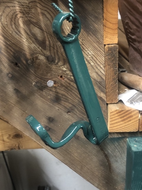

I added one when I swapped my vaporizer for a stromberg. The only fit and finish problem I had was the throat casting width at the bottom flange was a little too wide to clear a socket on the mounting bolts. One side cleared the bolt but the bolt on the other side scrubbed the side of the casting. On the plus side, I made a neat wrench with literally only one use! Between the new high compression head, carb and manifold, my coupe runs like a scalded cat.
