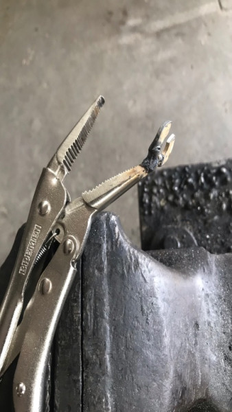

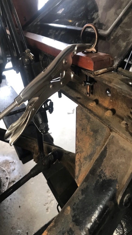

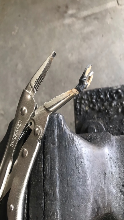

We are putting a 1913 back together after clutch replacement. Facing the dreaded hood latch installation, my friend Michael had an idea for a tool to assist, and a great one it was! He made it out of a $10 pair of Harbor Freight vise grips and a flat washer. About five minutes later, all the latches were in. Even the one right next to the carburetor was a breeze. I did the rear ones from underneath.

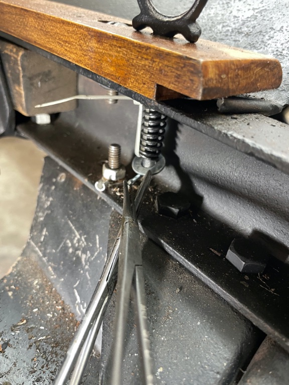

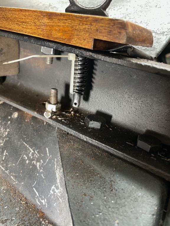

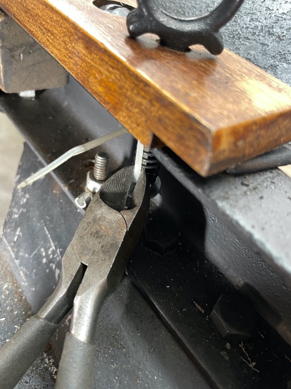

Yep, those hood latches are a bit of a struggle.
So I just used plastic wire ties, they compressed the spring, placed the hood latch.
Then, with the help of micro hemostats, griped the washer and cotter, slipped up the washer and cotter pinned the assembly.
Finally, cut the wire tie to free the spring to do its work.
Worked out real nice
