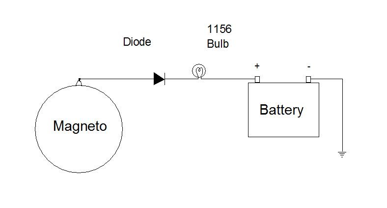

Following the discussion about using the magneto to charge battery, why can't a wire resistor of equal cold resistance of a 1156 12.8 volt bulb be used? As for overload or short protection a fuse in series. The diode from google search, is a 1N5402 diode which is rated at 3 amps and 200V peak repetitive reverse voltage.
- Posts: 5129
Re: Magneto Battery Charger
3 amps is a bit lite. 5 amps would be a minimum in my mind. The units I have built put out 3-4 amps from a hot magneto.
I also used both filaments or they blew bulbs.
- Posts: 6708
Ron Patterson's or John Regan's answer at the end of this thread answers the question as to why a bulb and not a resistor: https://www.mtfca.com/discus/messages/4 ... 1416288062

This doesn't answer my question. There are industrial grade resistors that will change resistance - temperature variables - as variables change. Also what is the average life of a 1156 used a a current limiter?Scott_Conger wrote: ↑Thu Aug 03, 2023 2:49 pmRon Patterson's or John Regan's answer at the end of this thread answers the question as to why a bulb and not a resistor: https://www.mtfca.com/discus/messages/4 ... 1416288062

actually, Patterson's and Regan's answers answer your question EXACTLY, and very directly, about the use of a fuse rather than a bulb and why it would be a terrible if not completely ineffective choice.This doesn't answer my question.

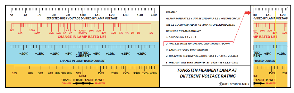

I'm not sure I want any part of this fireplug as no one has expressed a goal on this lamp life thing...but for the sake of maybe helping, here goes.
Just looking at the lamp it's the voltage that goes through it that determines life...the amps are not necessarily the first order failure.
Lamp life and everything associated with lamp characteristics do NOT follow straight line calculations. There are some plug-n-play calculators to help with the variables question. Some lamp house offer 3-D interactive charts to make guesses.
I'm a simple guy...I'll use the format for 'rerates' from the 1930's before all of the PhD's chimed in. This is how all of the WW2 airplanes were 'rerated' for life, illumination, amp draw, etc when there were limited lamp choices and lots of voltage choices.
The chart may help the OP in his quest. A quick comment on an 1156. --- At 19V of Magneto, lamp life is statistically ZERO...like in poof (and why magneto rated lamps never really working in the first place) . The original rated current had increased by 25% and the illumination was 4 times greater than at control voltage.
This 'calculator' for rerating is what was used at the Naval Research Center...all of the Anti-Submarine Projects, all of early LAMPS projects, the original and subsequent Centrifuges, etc. There are other 'theories' and other 'publications'...I always use this one!

I’ve been using just a diode on my 13 to charge the battery. I’m running a “Tru-Fire” ignition and signal and brake lights. Charging a “Seadoo” battery.
- Posts: 5129
Well, thats interesting.Les Schubert wrote: ↑Fri Aug 04, 2023 1:13 pmI’ve been using just a diode on my 13 to charge the battery. I’m running a “Tru-Fire” ignition and signal and brake lights. Charging a “Seadoo” battery.
What does you magneto put out voltage wise pre diode?
What voltage battery? How many amps charge?
Doesnt the light bulb regulate the amperage down to a safe & sane level?
Is your mag output weak to the point regulation is not necessary?

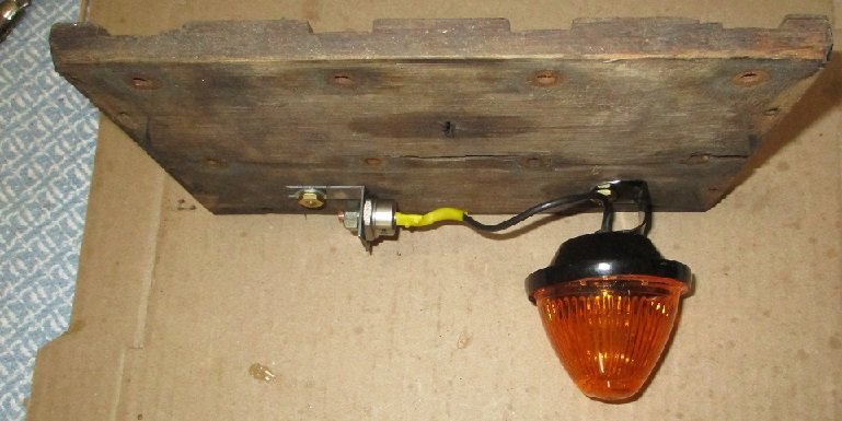

I've used an 1157 bulb and socket to charge small lead acid and Li batteries using older battery chargers that lack appropriate settings for such batteries.
With a discharged battery, the bulb glows bright and as the battery comes up to charge, the bulb goes dim.
I use a tail/brake light socket, which is convenient and which also allows choosing 3 different charge rates:
High, using both filaments.

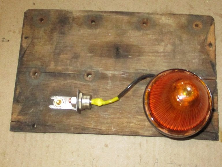

The Diode is a 1N1183A and the one that Snyders was selling as a kit with directions and may still sell.
The earlier editions of the MTFCA Electrical book also had that one, if I recall correctly.
Later editions deleted it!
With this one the current flows in the direction of the arrow.
Some of the older other diodes had the current flow opposite of the arrow direction.
I made several Model A Diode Cutouts before I recognized my problem.
I didn't, but John Regan told me, I had to read the diode spec sheet for each diode type.

An original ammeter with two short test leads can be used for a quick test to identify the diode polarity issue.
You clip one lead to the yellow battery wire.
You clip the other lead to the Bat terminal on the Cutout or the connection from the Mag.
If there is any current flow showing on the ammeter, your diode is in backwards and has to be reversed or your battery is in backwards with a positive ground and has to be reversed.
J1MGOLDEN
- Posts: 1314
- Last Name: Golden
- Location: Bowie, MD

Thanks Jim,
That diode has vastly more capacity current-wise than is needed, however it's potentially close to spec from a (reverse) voltage perspective. While it'd probably work ok it isn't what one would normally specify for the task you're wanting it to employ it in - those that Dave showed would be more like it.
Interestingly it's not necessarily ideal for a 'cutout' diode either. To be clear, it's not that it won't do the job and I'm certainly not advocating you throw it away, however it will have more loss and could generate more heat than you'd get from a schottky type. On the other hand given the relatively low currents involved it's hardly likely to matter much, and I expect they're cheap and plentiful (and robust) so there are compensatory factors
Luke.
Art M
- Posts: 983
- First Name: Art
- Last Name: Mirtes
- Location: Huron, Ohio
I am planning to try a diode from a GM alternator. They seem to be robust and reliable. I haven't seen one fail since the 1960s. Does anyone we forsee any problems.
Art Mirtes
Art Mirtes
Luke
- Posts: 617
- First Name: Luke
- Last Name: P
- Location: New Zealand
Art,
Without a part number it's not possible to say definitively but it's likely to be capable of handling the current draw, whether it'd cope with the reverse voltage over time is perhaps less certain.
Like JIm's component most of these diodes are designed for high-current but low-voltage use, whereas in the case of a magneto charger you have low-current, with a higher applied voltage. It's not a particularly high voltage in the grand scheme, but let's say you get to 30V or 40V input, and/or there are a few spikes on the line as a result of the T's generally harsh electrical environment, and you apply this to a diode that's only rated for say 50V, you're getting uncomfortably close to its maximum...
In circuit design it's normal to over-specify such components in order to allow a healthy margin and ability to cope with minor events where things exceed expected parameters for a brief period. If you've a component that's only just rated for the regularly applied voltage it could well deteriorate over time and fail prematurely.
In your case the diode may be fine, but you need to bear in mind that in its normal environment it wouldn't be anticipated to have more than say 18V applied to it, certainly not twice that. To be sure, if you were able to let us know the part number it may be possible to check the rating to see if it'd be ok for your proposed use.
Luke.
Luke.
