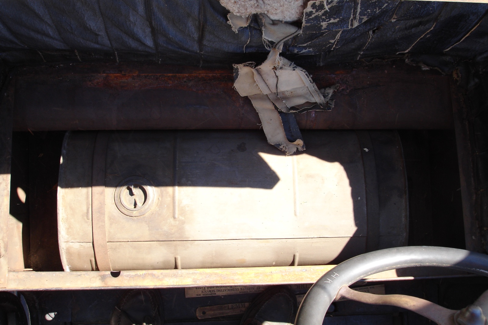

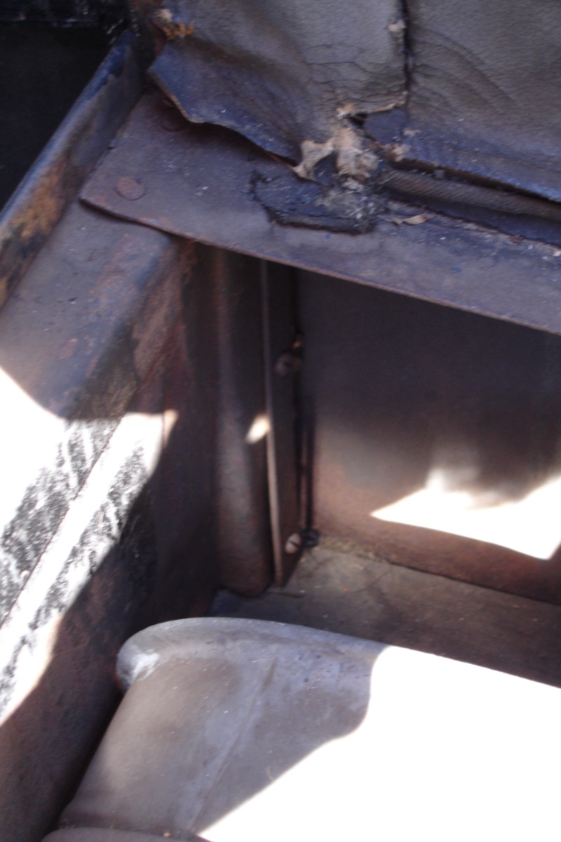

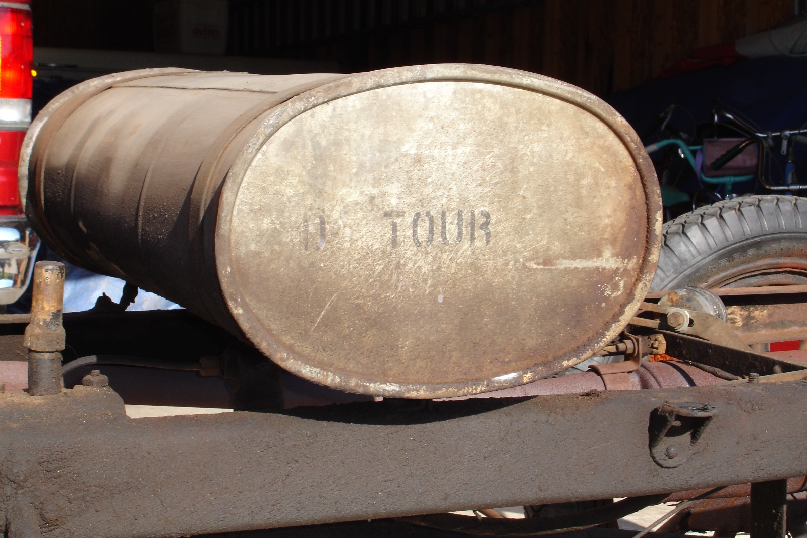

Steve, Don't know if it helps. Here are some pictures of my 1920 Touring (August) tank when I was disassembling for restoration. John

Sorry, meant to reply to Dennis.

Sorry for the delay in getting back to this thread. I've been occupied with doing the wood work needed to change my Mel Miller based (round tank) roadster framing to the oval tank type roadster framing as well as swapping out my round tank to an oval tank.
Thanks for the Pictures John. Also thanks to the others for the responses. Eric, Are you referring to page 421 in Bruce McCalley's book or his discussion on page 315? He discusses the November 1919 Ford factory letter concerning future changes to the Touring and Torpedo bodies which were in progress. Page 421 comments on the runabout continuing in the same style of 1920 until late 1922 but no specific reference to the seat riser. Page 317 the rear quarter panel changes and the lowering of the seat frames for the touring are also commented on.
So then for a 1921 Runabout it appears the additional gap between the metal lid and the lower oval tank is considered normal. If any one's got an original 1921 roadster with oval tank to share photo of, I'd be interested in seeing them.
