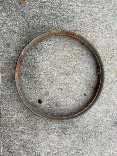

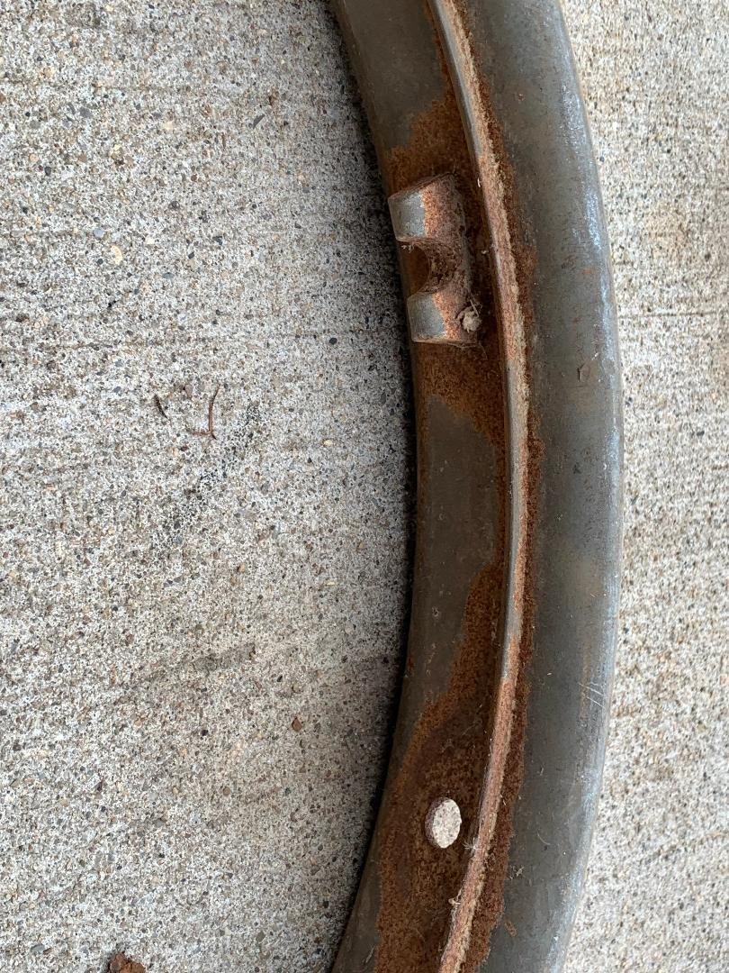

What is this single lug rim?

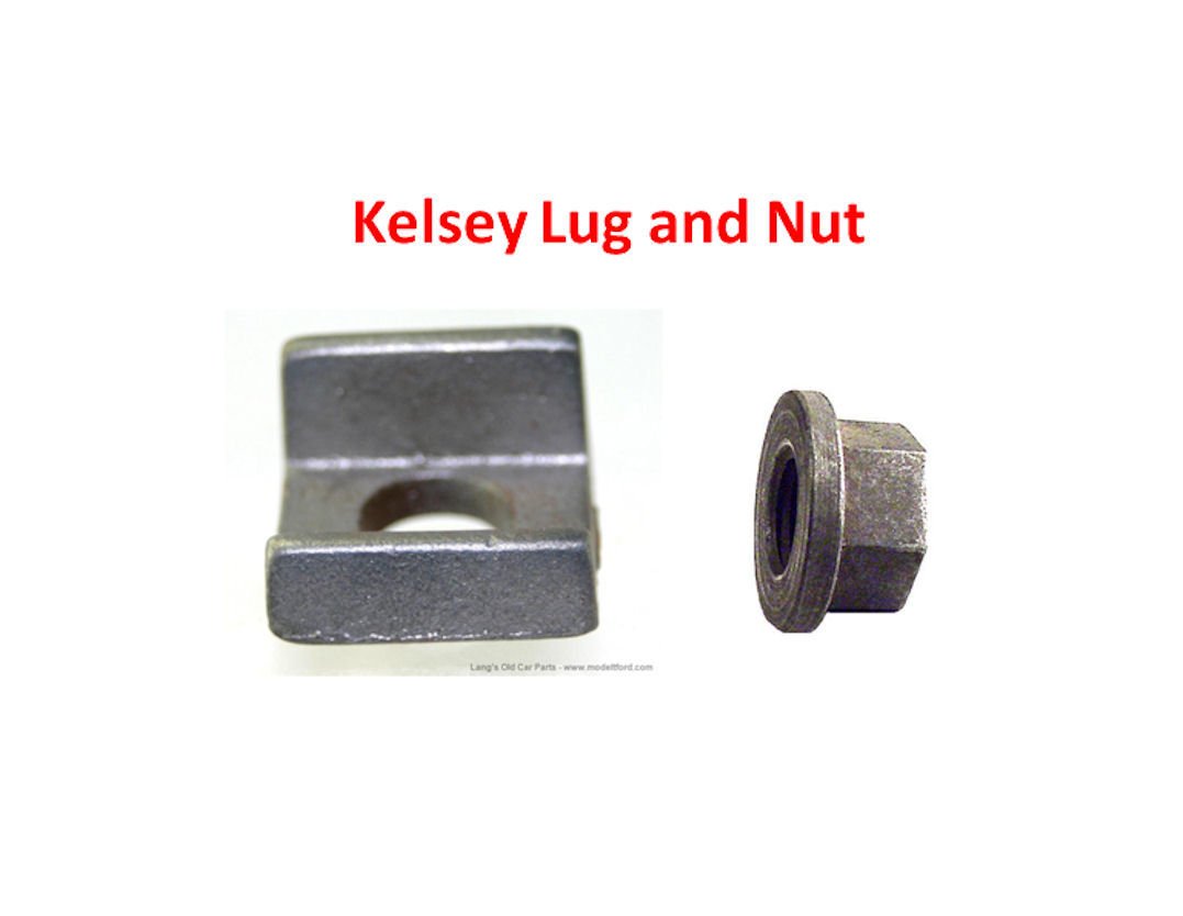

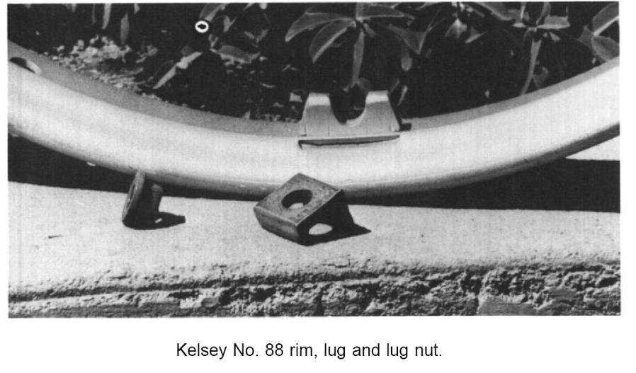

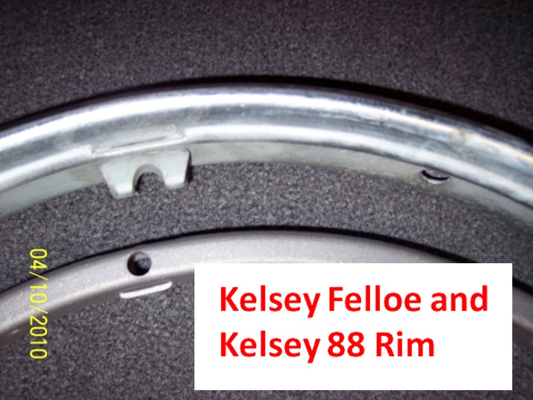

Kelsey 88. Uses loose lugs with flat bottom lug nuts. The one lug indexes on one of the lug bolts to keep the rim from spinning on the felloe.

I believe its the correct rim for the wheel in "what do I have here?" post. Early rim for the 19-20 wheel.
