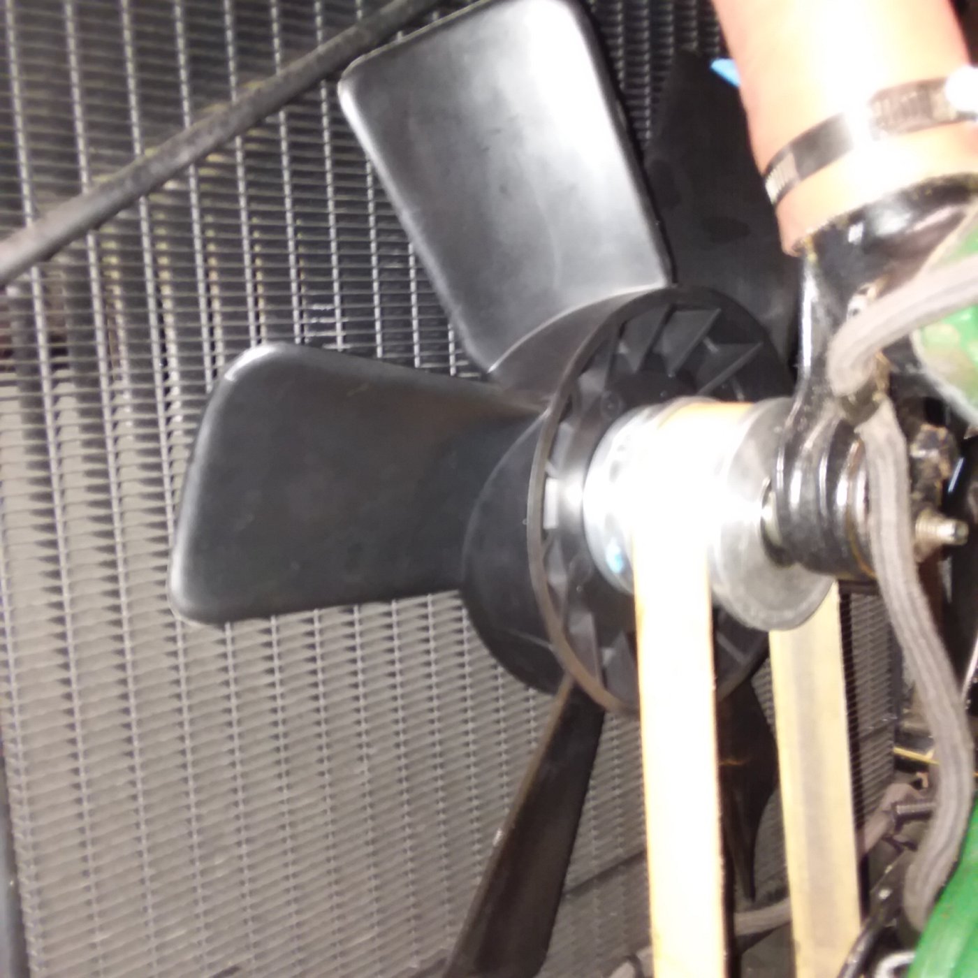

2 days ago I got to witness a 10 year old plastic fan grenade itself while in use. Further inspection of the remnants showed it had hardened with age (and perhaps heat) and lost all semblance of flexability... an old, frayed belt tipped it's fray into the fray, and ping pop gone.

Currently there is no way to set the model A plastic six blade fan dead center and indexed on the modern roller bearing pulley. Being off balance and off center is detrimental to blade life and personal safety.
My recent foray into the plastic fan world has fallen short of success.... for now.
Maybe someone will 3D print an update on the plastic fan that allows for indexed accurate placement on the pulley hub.
We'll see I guess....

To clarify, I meant that maybe someone would find a way to create an adapter so as to be able to index/center the 6 blade plastic fan, sold by vendors, on the hub.Mark Nunn wrote: ↑Tue Aug 22, 2023 8:44 amMark N. wrote....Professor Fate wrote: ↑Tue Aug 22, 2023 6:19 amMaybe someone will 3D print an update on the plastic fan that allows for indexed accurate placement on the pulley hub.
I have used 3-D printed plastics to build prototypes for over 25 years. I would NEVER trust a 3-D printed fan behind my new Brassworks radiator.
