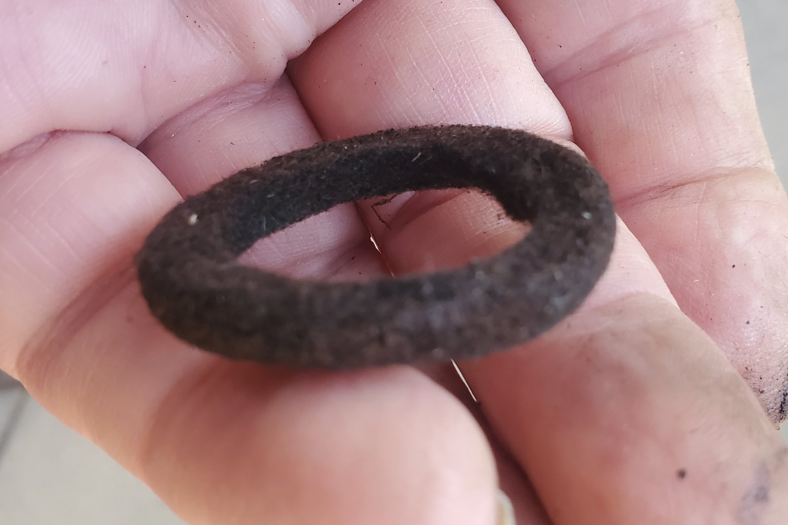

Felt seal that came out of the timng gear cover camshaft hole.

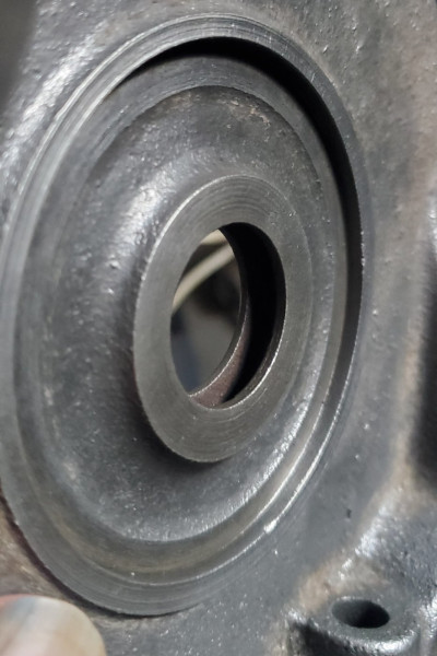

Hole in timing gear cover for camshaft seal. Most of them I have seen you were able to press in a lip seal. This one has a groove for the felt in the previous photo. I have seen felts (in the past) that the suppliers sell and they don't seem dense enough.

I had great fun reshaping the housings for those seals. I used rear axle felt and cut it thinner for them.

If you send me your front cover, I’ll re-machine it for a modern seal for $80 and will include the new seal.
