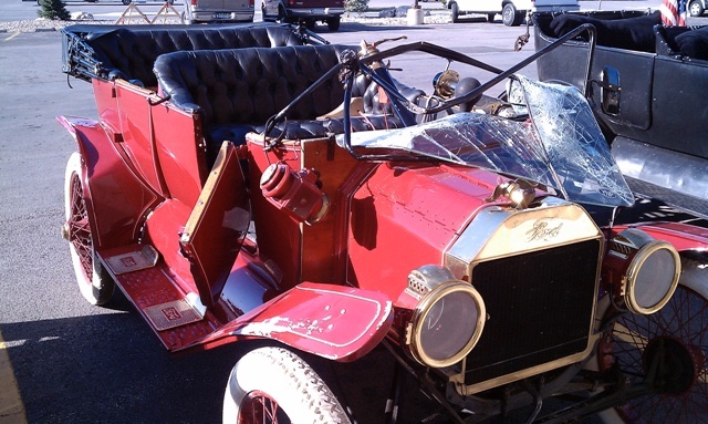

This beautiful Touring hit neutral when shifting an aux transmission when climbing a fairly sreep grade. The car did not have aux. brakes and overturned as it went off the highway near the bottom of the hill at high speed. The occupants were hurt.

I don't know the person driving or the owner of the car but that touring accident was the result of two critical failures that I would put on the owner/driver. He/they may be some of the finest people in the world but -
Failure 1 - In my mind it is criminal to drive a T with an auxialary transmission without having fully functional wheel brakes.
Failure 2 - Don't shift a non synchro transmission on a hill! Shift before you get there. Fundamental driving technique that helps you stay out of the hospital or morgue.
OK - Flame me now but people need to learn how to prepare and drive their cars before they hurt or kill themselves or others.
