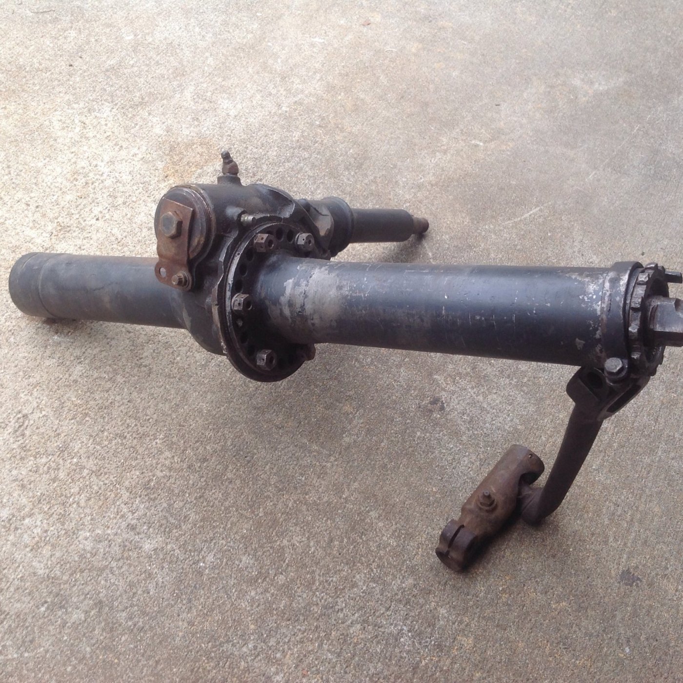

Re: 1924 Model T Racer
Thank you for the reply
The steering box in the photo is that for sale ....???
I have an original center mount steering gear. I believe it is a franklin. I was going to use it in a 1928 single man sprint car that I restored several years ago. I found a different center mount unit unit that worked out better for my car.
I can send you photos and measurments if you are interested.
