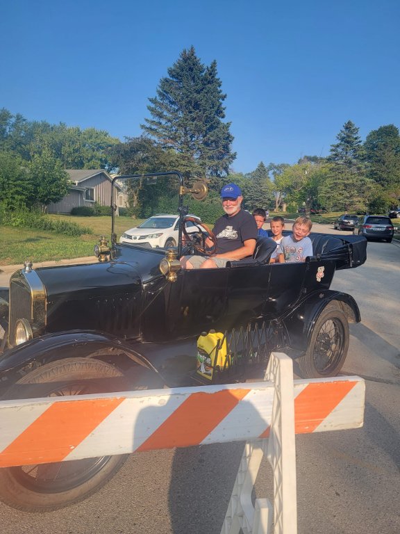

Thursday I drove about 20 miles to a local car show, so I could hand out flyers to my car show next month. Met a lot of nice people, an old friend, and took a young couple for a ride.
Saturday I went on a tour with the Dairyland Tin Lizzie group and added another 130 miles. A young lady in the group was able to drive a Model T for the first time, so it was called Lilly's Lizzie Tour. We stopped at a cheese factory for some cheese, visited a Victorian Mansion, ate lunch, and then stopped for ice cream on the way home. Later that day our neighborhood had it's annual block party and I gave rides to about 20 kids and a few adults. Some kids must have gone around the neighborhood 4-5 times.
Later this week I head up to Minneapolis area for the New London to New Brighton Antique Car Run. I will try to post a few pictures. I know others will, too. www.antiquecarrun.org

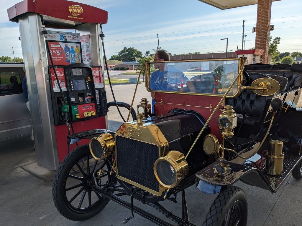

The heat wave, in Kansas at least, finally broke this weekend. My wife wanted to go T driving, so how could I say no? I think we won the award Saturday for "the oldest car to get gas at Casey's on 8/5/23"

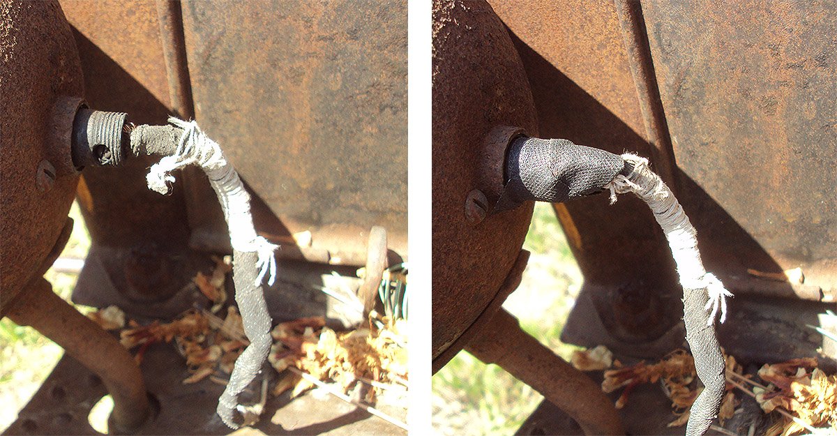

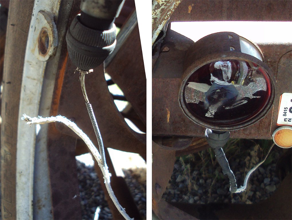

I noticed my taillight needed refreshing. The plastic window disintegrated, and the white cardboard reflector warped out of shape. I think these were standard and they do make the taillight brighter. I also resoldered the socket as it was loose. I made sure there was a good ground to the spare bracket.
The wire insulation was frayed so I refreshed it with "friction tape".
The light didn't come on so I will check the bulb and connections soon. It was nice to be doing some work again.

I got the taillight to work. The plugs have been exposed to the outdoors, Summer and Winter for 10 years now. They fit tighter into the sockets and have some corrosion and dust in them. I think these are old originals. I wiped with lacquer thinner and scuffed with Scotch pads and they fit better now. The headlight plugs needed it too and work fine now. Grounding is also a problem with outdoor cars.
My cars that sit outdoors show me many things that are problems and some that really are not, that I wouldn't know about with the pampered indoor cars. This gives me better insight into what owners contended with back in the day. I thoroughly enjoy that. Something many don't get to know.

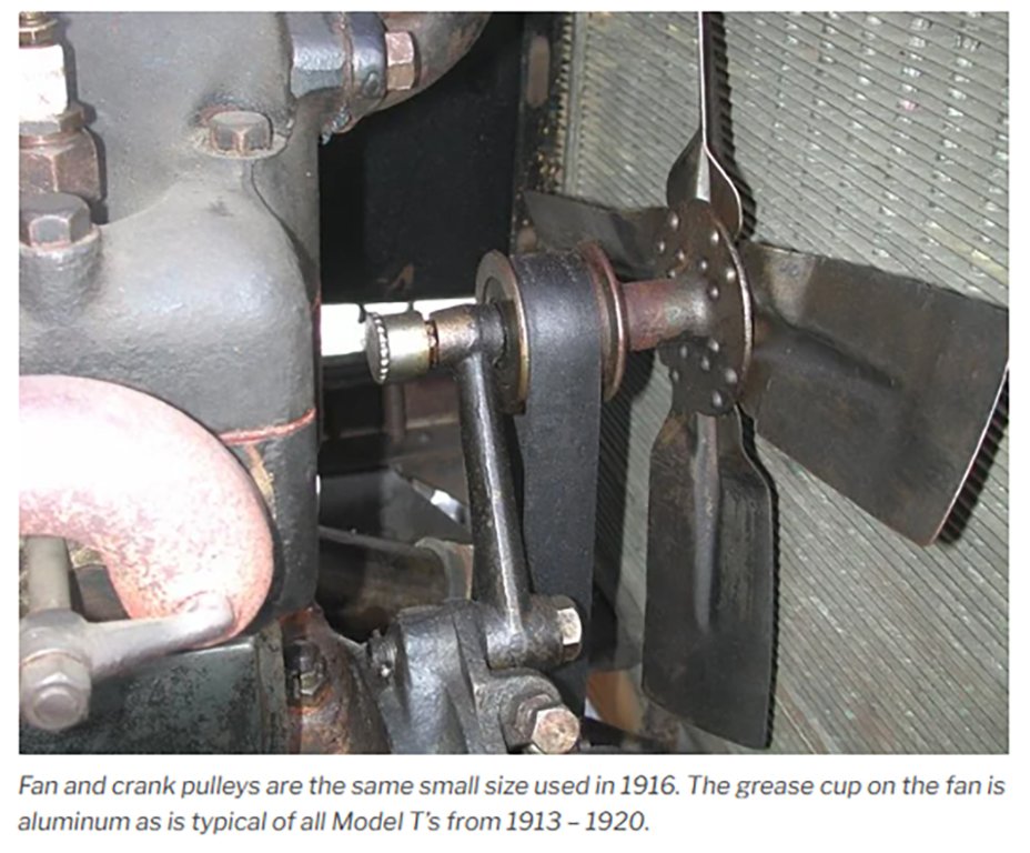

Looking further, I see this on FordFix.
I hadn't ever heard of an aluminum cup before???

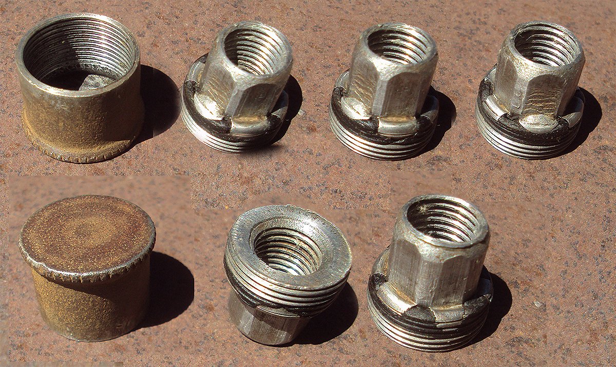

Dont believe everything you see on the internet.
Those internal threaded cup bases were only used on early fan shafts as shown.
The seal is a crimped leather ring. The leather seal can be replaced with an O-ring.
The leather acted as a seal & tensioned the cup to not vibrate off.

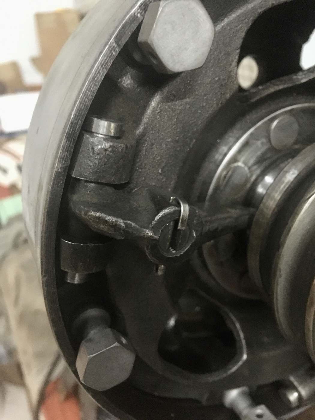

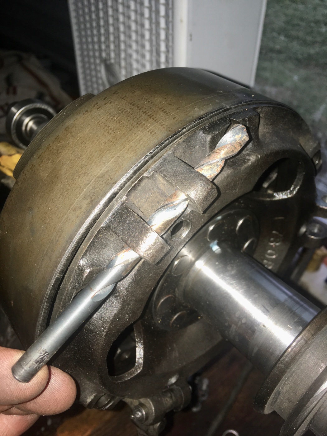

Turned some drive plate pins
the originals where to sloppy for my liking
19/64ths did the trick
Just enough to get everything the same size
A nice tight fit with enough clearance for oil
I will finalize later when I buck them tight

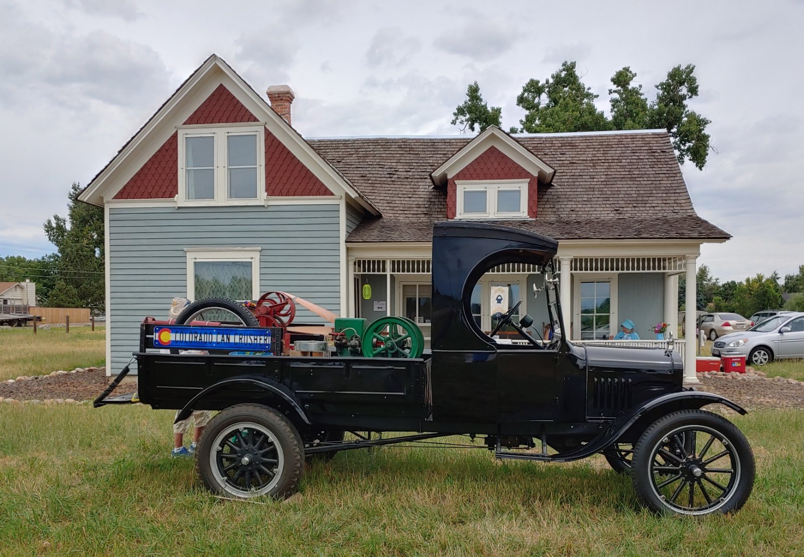

Spent a NICE day at the Wheatridge Heritage Center, Baugh House. This is the first house in the Wheatridge area. Originally a log cabin. Later, they built a Victorian hose around/over the original log cabin. You will see the original log cabin while touring the house.

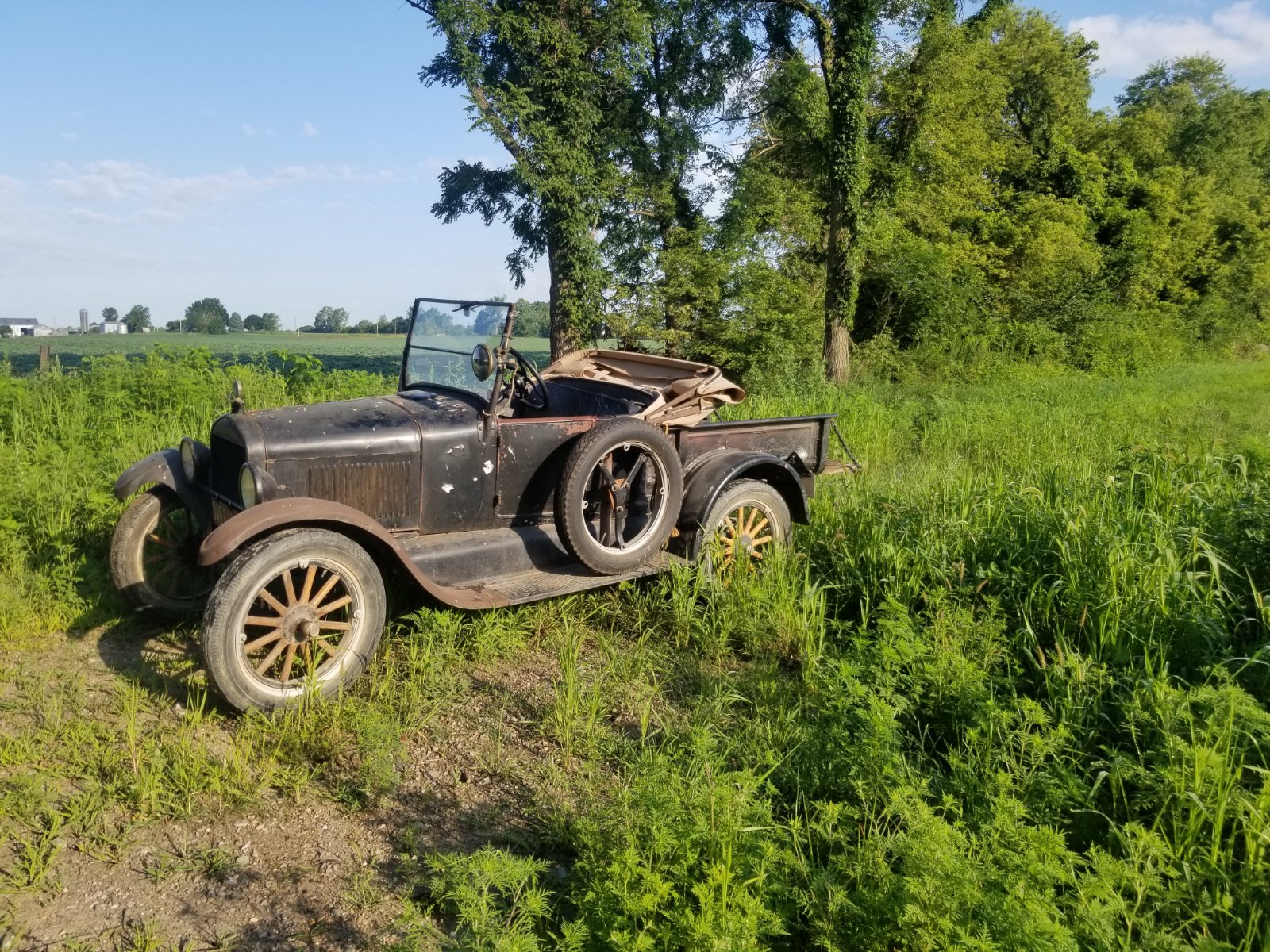

Post by Dallas Landers » Sat Aug 12, 2023 7:29 pm
Drove the RPU to the gas and steam show in the next town. Nothing better than gravel roads and a Model T on a nice day.

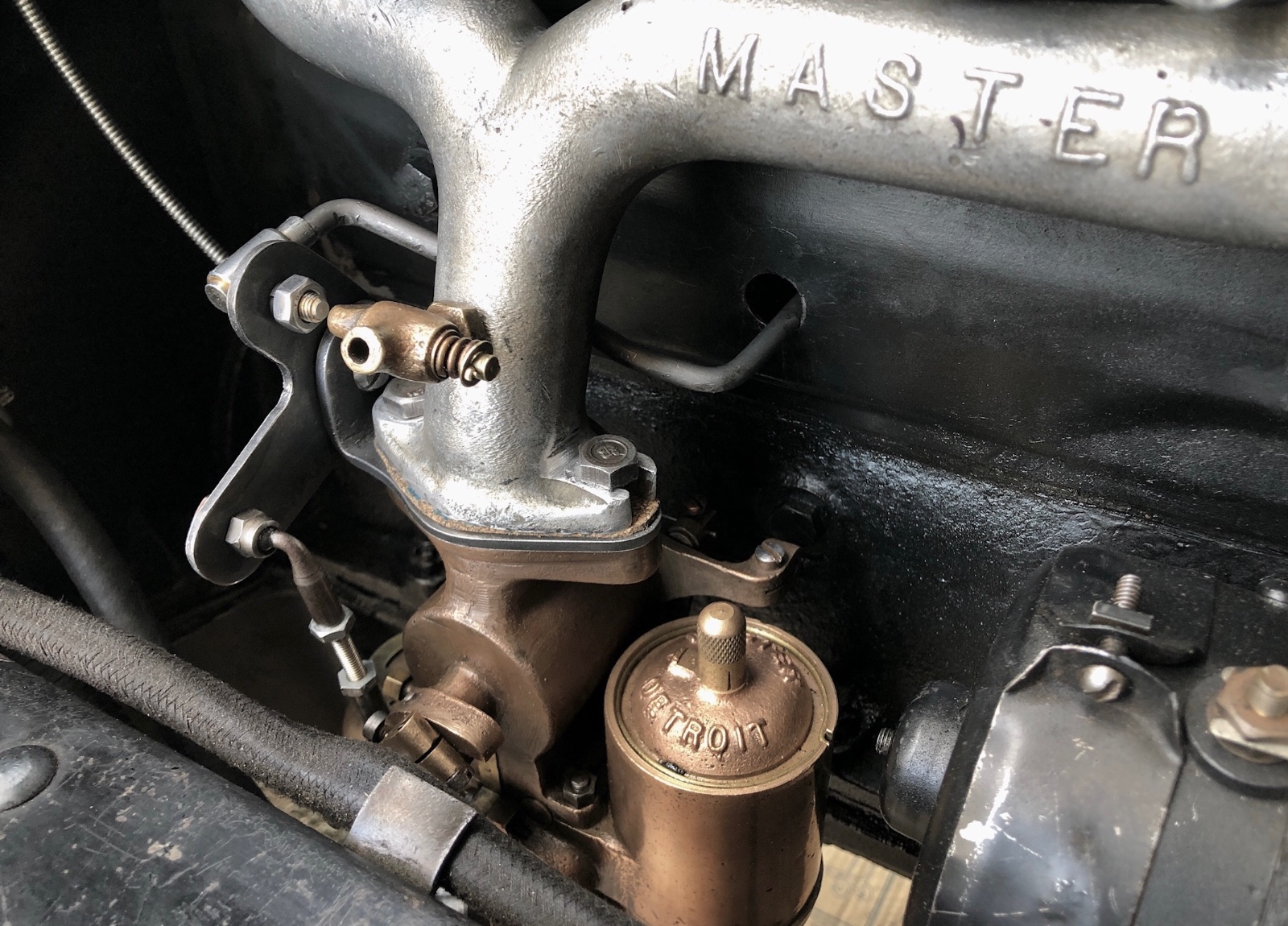

Rebuilt Leakey carb, replaced sediment bowl valve and fuel line and installed a fuel filter. Next up is to replace stripped stud on coil box and replace the contacts in the coil box as soon as the parts arrive.
Also replaced crummy spark plug wires and a new timer harness with proper routing and clips to secure it.

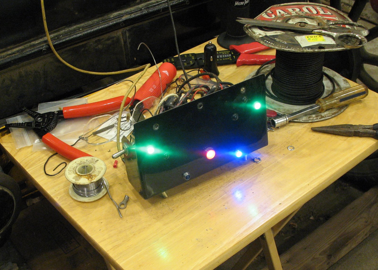

First, this wasn’t my car, it belongs to my son. He missed the 2022 Old Car Festival because his Heinze coil box went dead. This summer I disassembled the box and replaced three contact springs and the copper wire leading to each. The shop next door to mine shares a wall and the “farm” inside caused havoc with the humidity in my place and the machinist two doors over. Wholesale prices dropped and they moved out and all is now well. I’m happy to say the new guy next door is great.
So, After reassembling the box and soldering the wire to the split rivets we heard four coils singing. Tonight we cleaned out his fuel system. My son was so delighted to hear his car run that he bought me a burger and a beer. My daughter’s son was helping so he got fed as well. He’s eight years old and has no intention of missing the merry go round Friday night at the OCF.

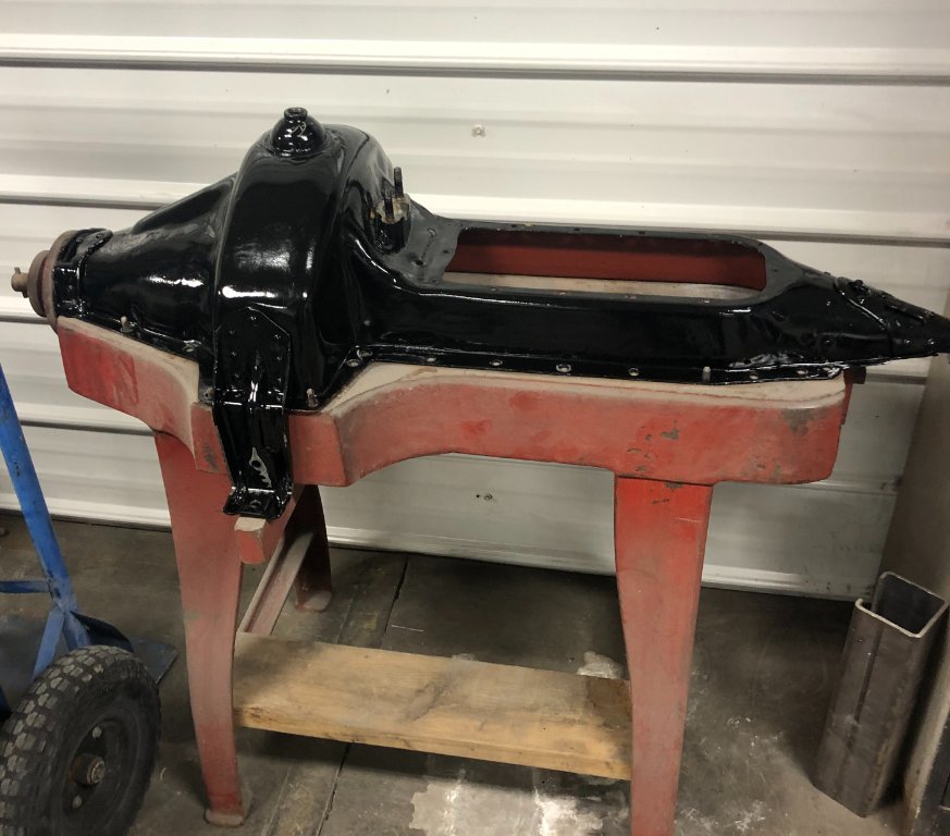

Post by varmint » Tue Aug 15, 2023 10:32 pm

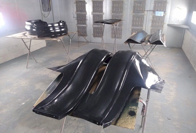

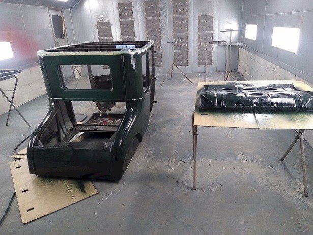

Got to painting the black parts.
It's a 100 footer.
I looked for steel replacement fenders and never found any. So, we patched up what we had.
