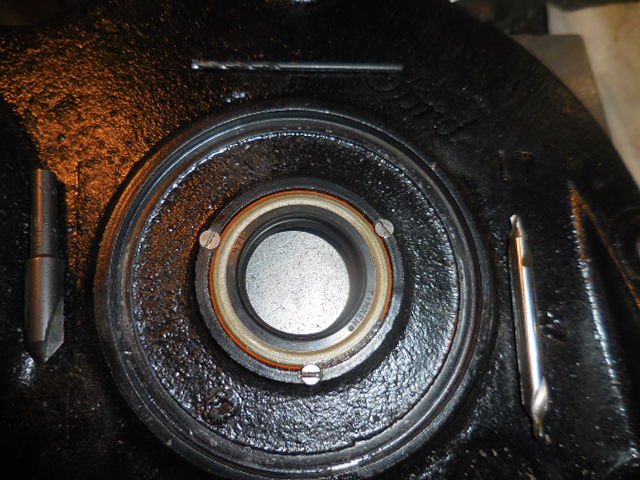

The way I solve the cam oil seal from coming out or leaking, Is to clean the outside of the seal and the seal bore with acetone, let It dry than put a thin lining of ultra gray silicone sealant on the bore of the cover and push the seal into the bore, put a weight on it and let it set over night. The next day I drill and tap for 3, 6-32 flat head screws evenly spaced so the screw heads put pressure on the seal to retain it. Please see picture.

Bill, using those screws is an excellent idea. It provides an added measure of peace of mind.

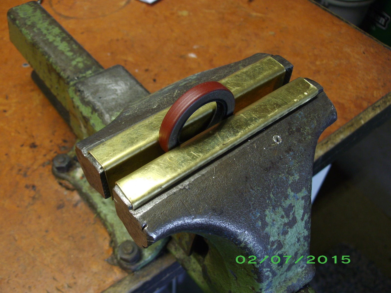

Don A . I have good results as I do it as on the picture

Two pieces of wood and a vice works; you just have to do it a little bit. Measure before and after. You're only looking for 0.005"-0.010" diametric growth typically. Seals are cheap, so my suggestion is to try it again, but any of the above will work, too. If you're using an oiled timer, it doesn't have to be perfect - the felt wasn't. If you're using a brush timer, it needs to be pretty much perfect.
