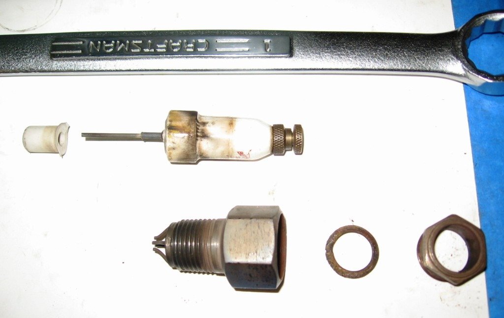

Re: Misfire on #1
This is a longshot, but I recently experienced it on my 1912 Flanders 20. The engine would Idle fine, but misfired under load (like climbing a hill). Turned out that the spark plug in cylinder #3 had a broken porcelain inside the cylinder where it couldn't be seen until the spark plugs were removed for inspection. I replaced the broken spark plug and all was well again.
