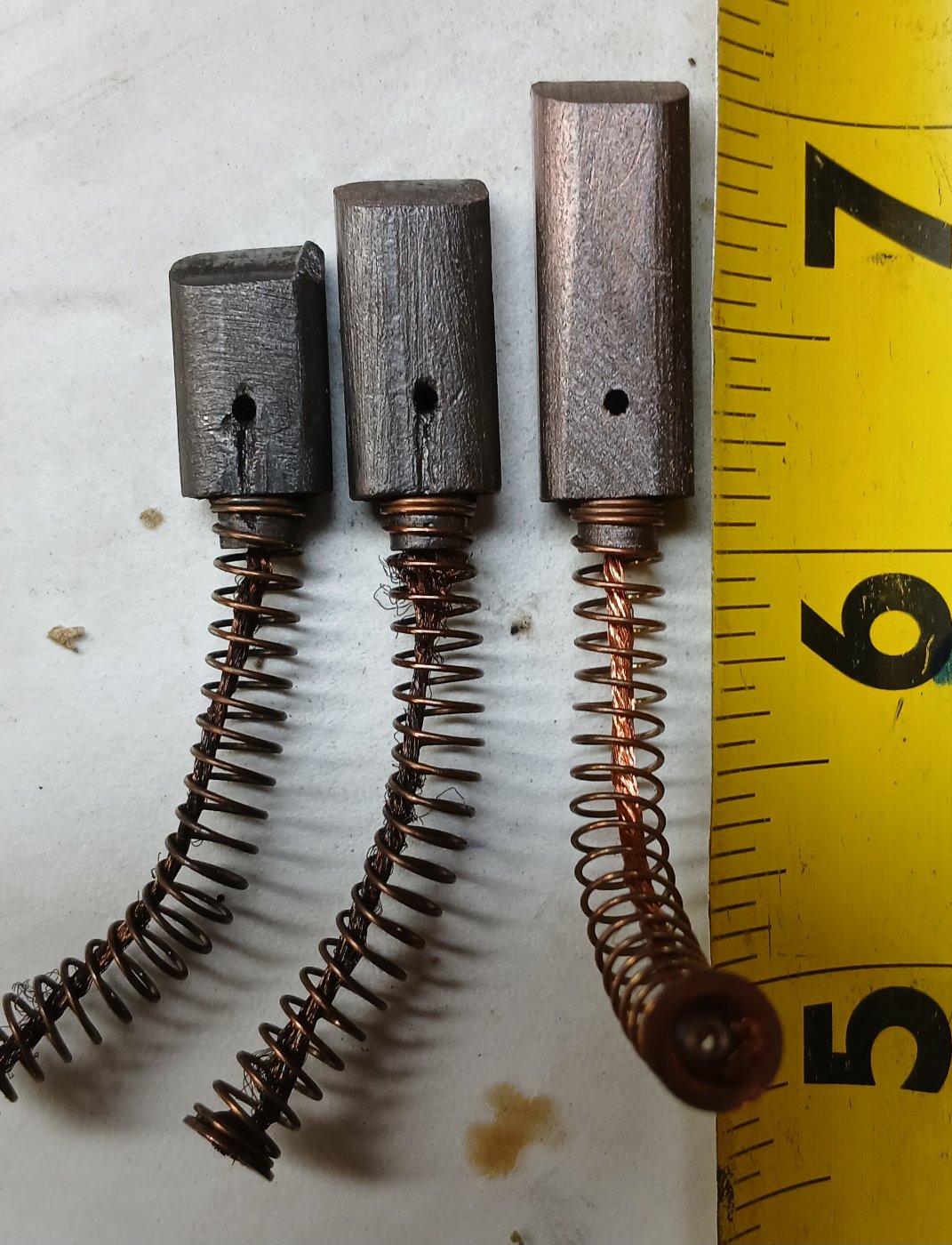

New Day works for me. I do use a carbon brush instead of bronze. It's cut from a generator brush.

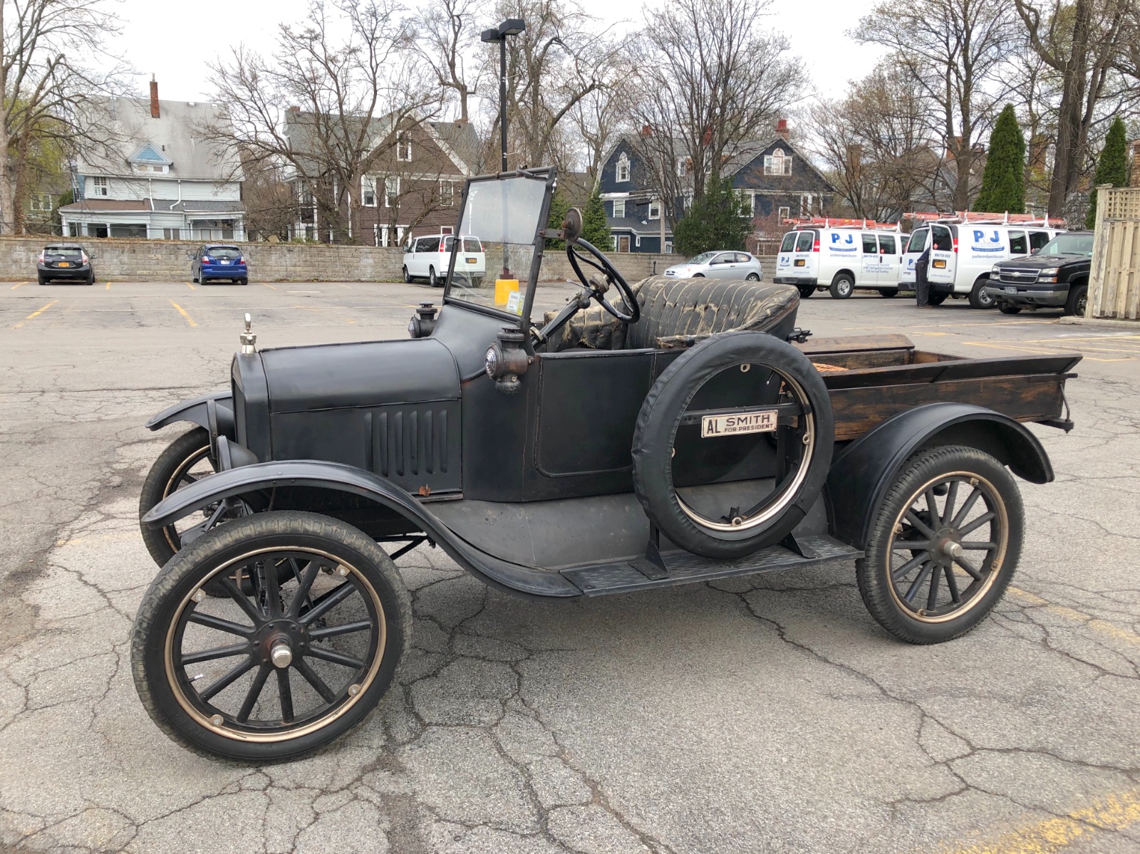

For 35 years I used Tiger timers which worked fine for a year or so and then the races eventually wore wonky with indentations on the surface. I switched to a flapper style for awhile and liked it, but the contacts seemed to wear quickly. I still keep a good one in my tool box for emergency.
After I rebuilt my ‘23 I used the TW timer for a couple of years and it ran nicely but my experience was that the brushes only lasted about eight months of driving. The coils were all rebuilt and tested. I did install a good seal when I put in the TW and that was a good move.
Right now I’m running with a vintage New Day and an OF carburetor. Still messing around with the OF as there are still some issues with irregular sustained running around 40+ mph. But in the city the speed limit is mostly 30-35 mph and the car is fine at those speeds. I had never used a New Day till now. Runs nicely so far and I like it. Just removed it the other day to inspect and aside from some dust and contact darkening seems fine. Cleaned the contacts with Scotchbrite and put it back in. I appreciate that there is a reliable E timer but I like the idea of using equipment from the model T era. Like I said .. I drive my ‘23 runabout nearly every day and have never had to leave it in the garage because of technical problems. A very reliable car.
Here it is with the pickup box installed for the summer ... in the parking lot of the George Eastman Museum where visitors always think it was George Eastman’s car. ;-)

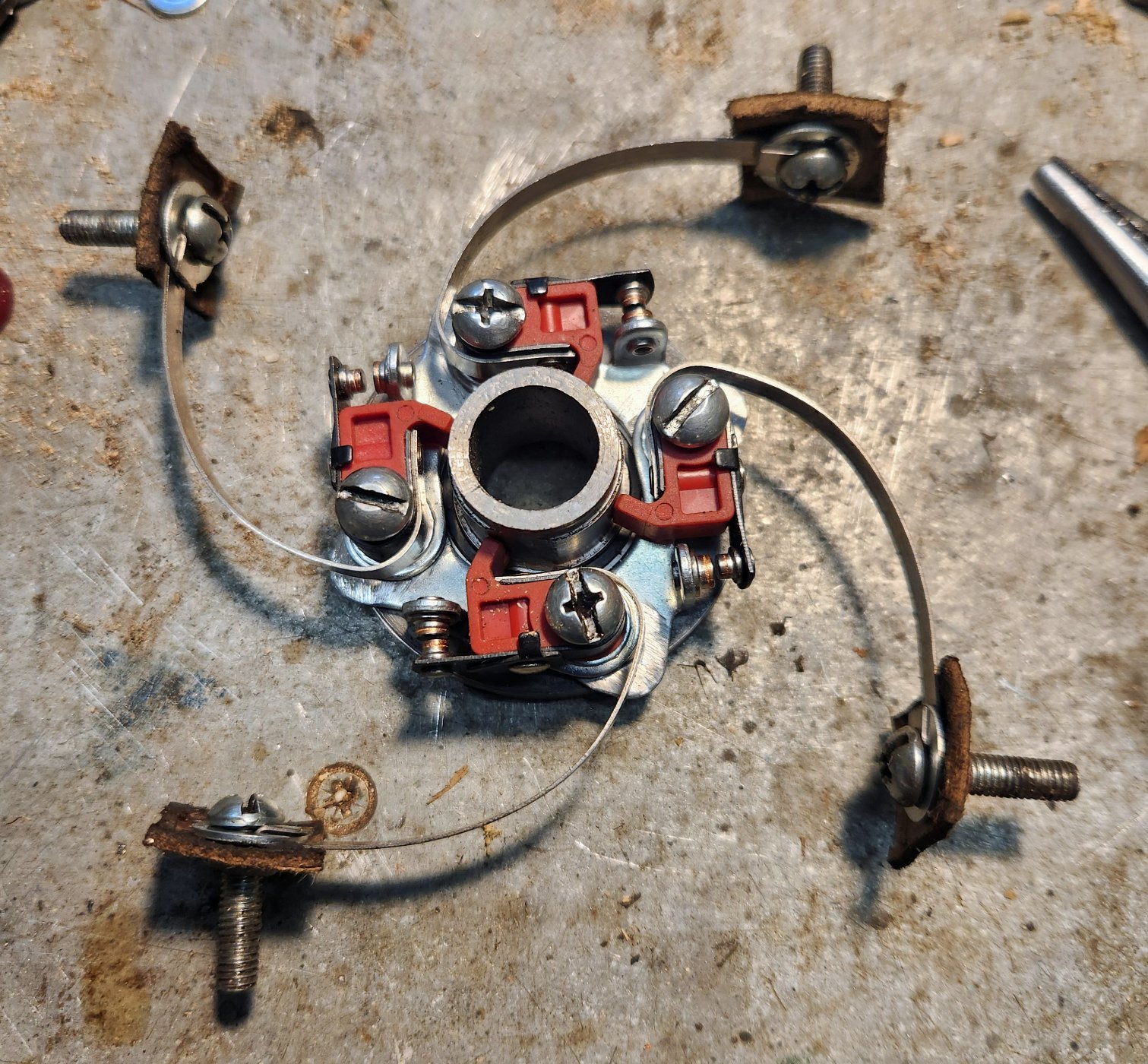

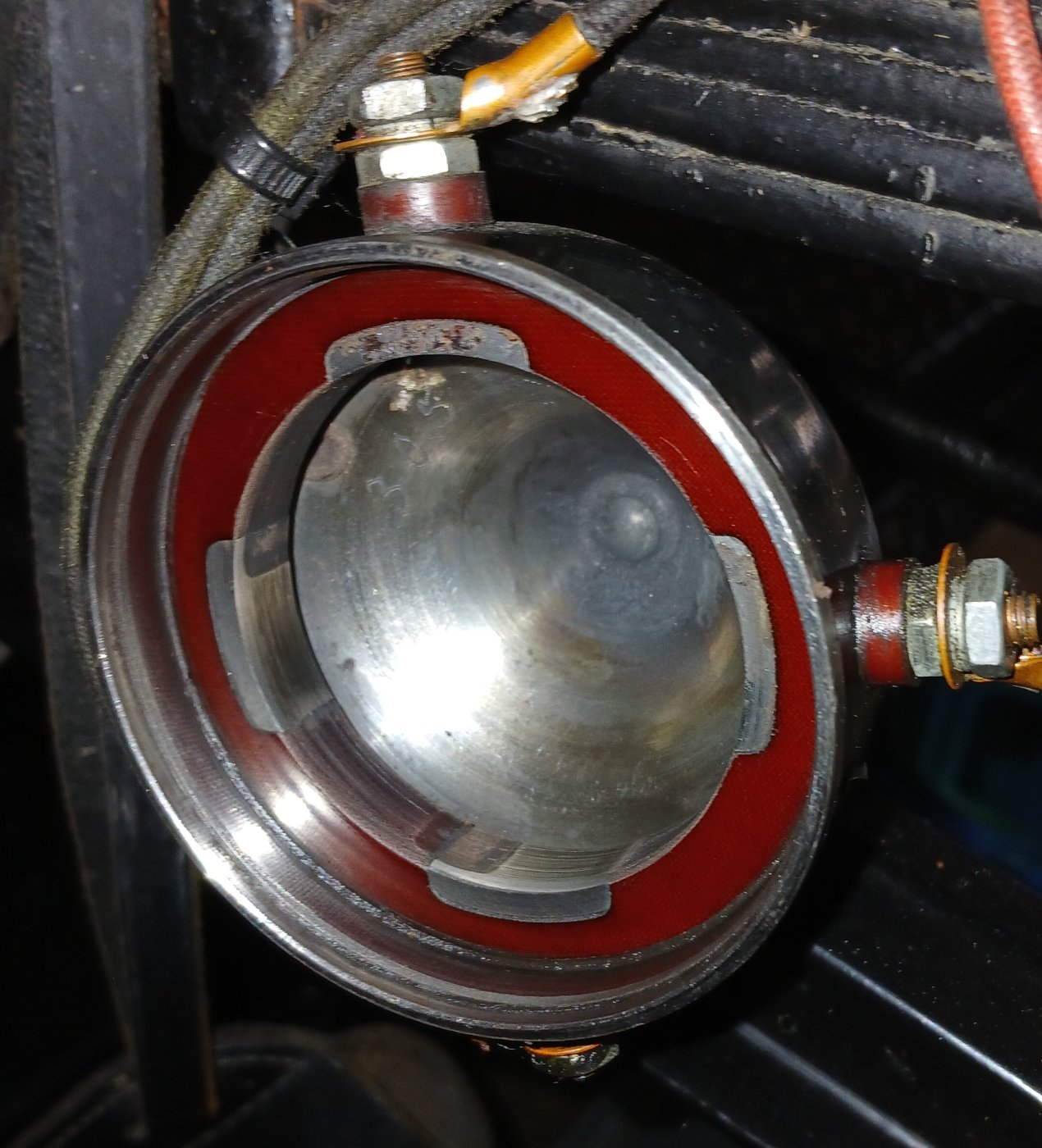

I’d like to hear from people like me who drive their model T nearly every day. I think it’s a very different experience than the occasional drive. And for me it’s also city traffic to work and then pleasure drives in the evenings and weekends. So, more like how they were actually driven back in the model T era.
Mark...I don't drive mine every day but darned close to it.
Glad to hear you like/liked your TW but am concerned why your brush didn't seem to last long but you used "months" rather than miles. I will attach 2 pics...one is the timer after over 17,000 miles on it this spring, and one of 3 sample brushes...far left brush at 4,000 miles, middle @ 2K, and far right is brand new. You can see i could, and have, actually gone further on brushes like the far left.
Someone said something about not losing thenlitle "installation wire"...well with practice I can get the timer put back on over the brush WITHOUT the wire. Learned thst early on, as the earliest versions did not use that wire!
