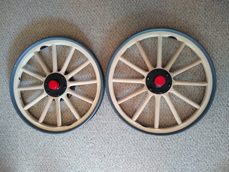

Enjoying the last of the wheel rebuilds.
Began last October. Done!

Brooks, now all you need is correct rims. The wheel you show is the type with the notch in the felloe at the bolt hole. it should have a loose lug rim which has the U shaped piece held in place by a flanged wheel nut. Fixed lug rims will go on, but they will not wedge on the felloe. The load is all on the 4 bolts.
The photo shows what I think is a Hayes lugged rim. It does not appear to go right to the back of the felloe, and looks like it sits well off the outside. This is caused by the 'foot' on a Hayes lug needing a relief in the felloe edge to allow it to go fully on. If this is the case, your is the lest desireable combination.
Sorry to dampen your enthusiasm, but it may become a safety issue, and should be addressed one way or another.

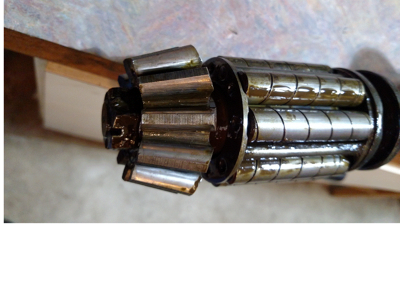

I recovered from yesterday’s electrical fiasco during the tour. I’d previously installed a 6v regulator from Birdhaven and it turns out it was defective- no charge at all even though the generator was set at full output. So, I “borrowed” a cutout from a fellow T tour participant but I didn’t dial back the generator so Excess voltage burned out both headlights, the 6v blinker turn signal flasher, and caused general mayhem. Chalk that up to yet another thing I’ll never do again. Trial by fire for sure.
And the starter also failed. Completely. Shorted out to ground - probably somewhere in the field coil winding wiring. So now my left forearm is sore as hell from crank starting the stubborn bitc$$$@; it isn’t a simple start. But eventually I get it going and it runs great until I shut it down and start the process over.
Is this T bliss or T hell? Perhaps a little of both. I’m still having a blast on the tour.

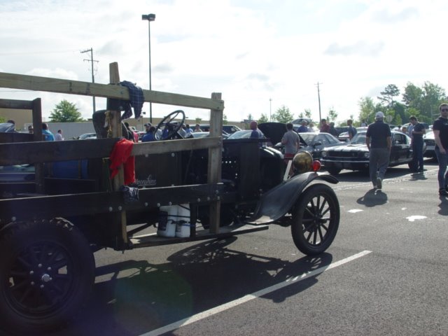

I got Ellie Mae's rear gate on...

Hauling livestock, Tom? :)

I like the way you think! It is a long way from Tennessee to Beverly Hills, so we will probably take some laying hens for eggs along the way. Those, plus the roadkill and a huge mess of biscuits Granny is cooking up should get us through.

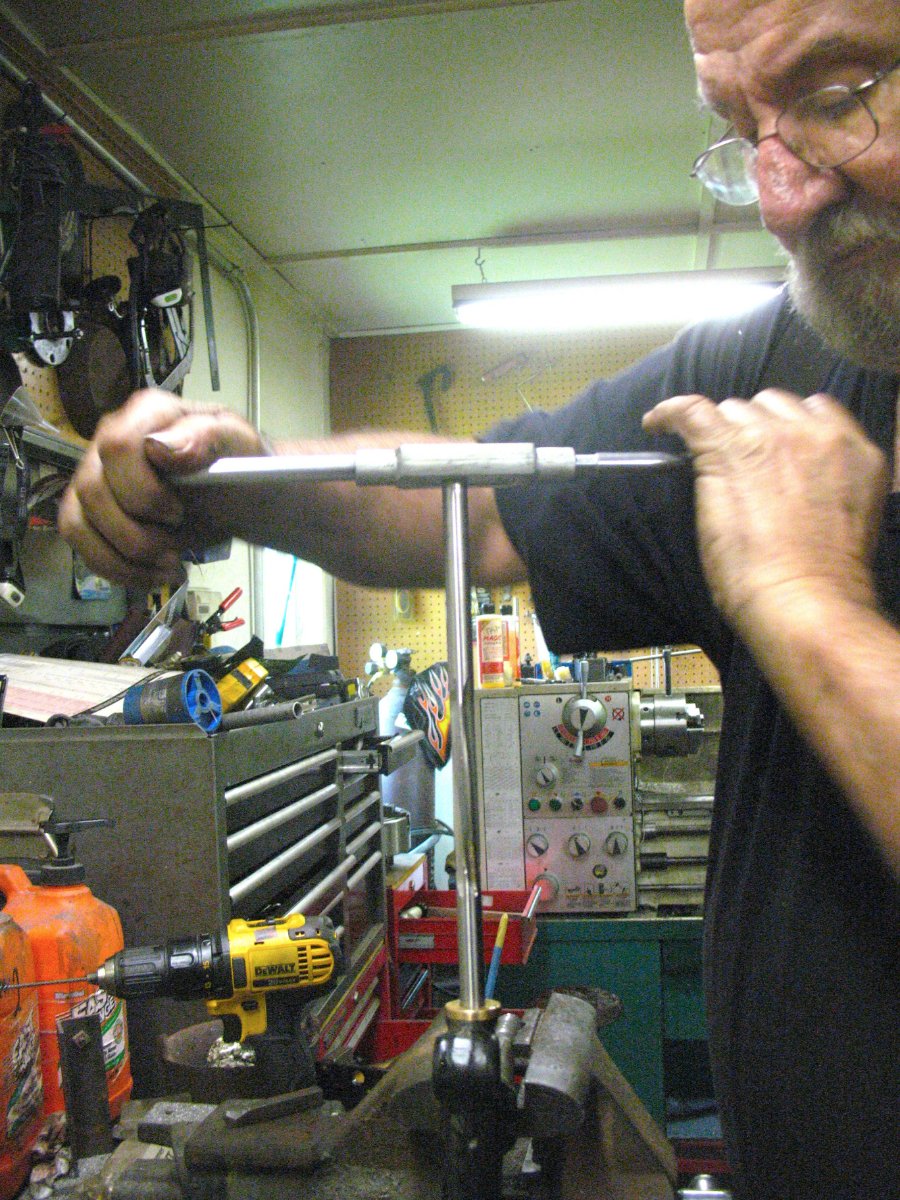

Drilled hole in right differential housing and tapped for 1/8”- 27 pipe thread and installed 1/8” brass drain plug. :)

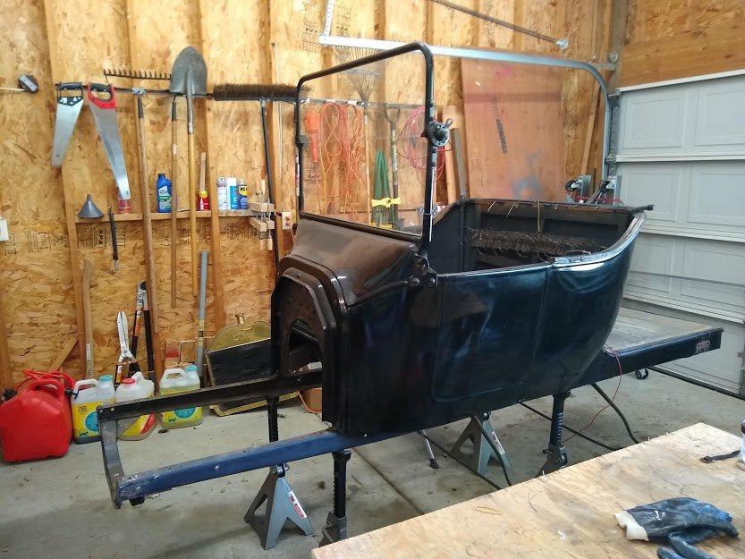

Got the speedsters body partially mocked up! Summer here we come!

Part One
Friday I went for another work day at Mike's. We spent half the day trying to get rid of main shaft run out and never did get it under .002". So we decided to take a break from that and do spindle bushings instead.
I'm using a "new" axle in place of the bent one that was on the car. It's nice and straight and has good threads, but the top holes were wallowed out and we used the Stevens tool to fix that.
The fix is a tapered bushing that the spindle bolt will fit.
A tapered cutter adapts the hole for the bushing to fit, and a screw at the bottom takes up the slack and keeps it aligned.
The cutter has to go in all the way. In fact, more cutting was required to make the bushing fit into the hole. Luckily Mike had a bigger cutter to finish the job.
The bushing stands a little proud so the bolt will press it into the hole.
Posts: 7373
Re: What are you doing with your "T" in May
Post by Steve Jelf » Sun May 19, 2019 11:07 am
Part Two
Pressing new bushings into the spindles.
The spindle bushing reamer is really two in one. The bottom one cuts the bottom bushing to pilot the shaft, and the larger upper one cuts both bushings to fit the bolt.
This shell cutter flattens the surfaces where the bushing faces will fit.
That's flat enough.
The final step is cutting the bushing faces to fit.

[image][/image]I have been able to make good progress so far this month on my 15 runabout restoration. Progress includes:
Getting my non demountable wheels back from Stutzmans. They finished them in less than 3 weeks. They do beautiful work! Current pricing is $190/wheel for correct year spoke and felloe shapes. I provided the wheel hardware and splice plates. I used appliance epoxy paint on the hub parts and bolt heads, but left the rims in primer because, based on past experience installing tires, I will likely nick them up a bit installing the new tubes and tires!
Got my fenders, headlights and splash boards low pressure/high volume media blasted by a company specializing in this process. Very reasonable price with no damage to the parts. I've since etch primed them. This was a very old original restoration, and there is some lead work on the front fenders around the area where the three rivets attach the brackets.
Finished removing everything from the body. I felt like I was working on an old piece of furniture instead of a car when I removed the upholstery and top. It is amazing how small a runabout body is once everything is removed.
Also got my running boards and leaf springs back from the blaster/powder coater. Reassembled the springs after applying slip paint between the leaves. After mostly disassembling for the last two months, it was nice to finally have something restored and finished!
Mike Bender has also been making progress on my engine, with getting the babbitt poured and the block and head machined.
We are working hard to get the restoration complete by the car's 105th birthday at the end of September.
Neal

Post by ClockDoc » Wed May 22, 2019 12:41 am
I started to rebuild my generator but ran in to a problem right off the bat. I did not have the correct tool to remove the field pole screws and I made matters worse by using the same method as the last guy, a punch and hammer!
I did manage to get one loose, but the others would not budge. So I sacrificed one of my extra chisels to make a "tool" that would work and fit the new screw correctly to reinstall.
I then put it in my vise to hold the tool tightly to the screw.
I tried using the 3/8" end wrench that fit the shank but I didn't have enough leverage. So I added some vise grips and a piece of 3/4" EMT conduit for added leverage.
SUCCESS! the rest broke free easily. Now to get every thing cleaned up and ready to assemble.

Hey Neil ,would you mind posting a picture how the body panel behind seat fastens to the side panelsand what screws or bolts were used ?I have one thats apart and need to know what size screws or bolts were used. Thanks Randall

Post by Tom Hicks » Sun May 26, 2019 4:16 pm
I have been doing test drives with Ellie Mae. Testing my ability to drive safely and testing her ability to perform. I am not finished, but very pleased with the results so far. With 5:1 rear, Warford, and Ruckstell she will run 45, and is actually pretty smooth, but even with front disc brakes her stopping ability does not make me comfortable at that speed. I think 35 will be her top speed with me driving, and she likes all speeds. I mostly drive with the Warford in direct, the Ruckstell in underdrive for neighborhoods (most of my driving), or Ruckstell direct on the open road. It does not take much throttle for her to cruise at 25 and it is a sweet sound as she smoothly moves down the road. Steady low RPM. I think the Z head helps.
I took Griffey to the park today for a walk. 90*, but we were on a shaded trail in the woods. 1.7 miles, 28 minutes to cover it! He loves riding in Ellie Mae, wind in his face. It was not too hot on the road except for stop lights. He wouldn't drink at the park, but when we got home he went straight for the pond. I will give him his spring haircut tomorrow! I had to get him out of the pond and back into Ellie Mae for the pictures, he likes Ellie Mae but at that point he preferred the pond.
We look forward to many more rides to the park together!
