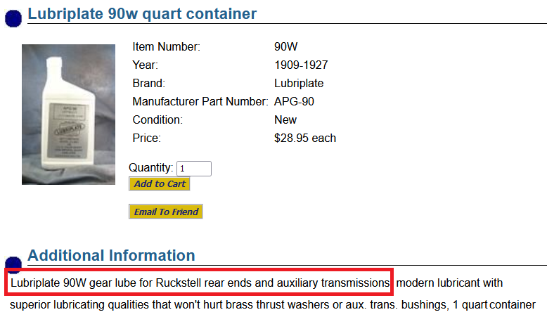

According to the rux build book 90 wt is preferred. 140 for a stock rear end. Not confident the thicker lube will get into the rux inners. I have always used 90 wt. Not had an issue lubricating. MHO. When I fill the rux for the first time, I try to squirt oil into the carrier bell thru the outer slots.
- Posts: 4691
Re: Has Anyone Experienced This?
You're correct. 90 it is. I should have consulted the manual. I have Ruckstells in all of my T's.

From Lang's
