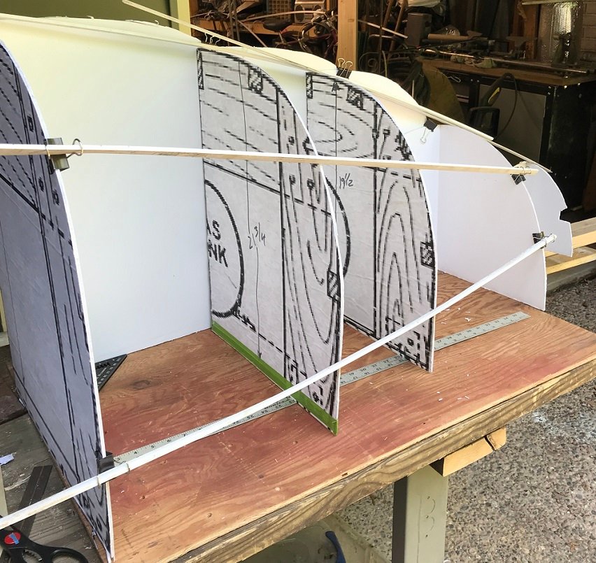

I have plans for the M&M speedster (Modern Mechanics Magazine) see my avatar the rear was fabric. --
I mocked up the plan to scale only to find out the side support widths were much to wide. But Its a good reference

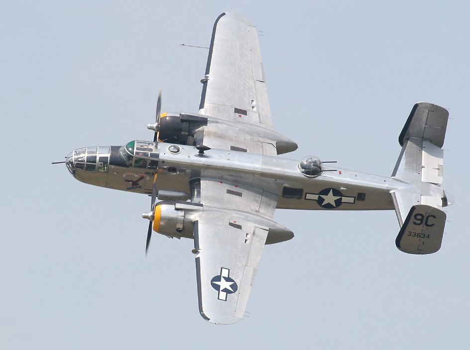

I saw this recently and got to wondering… does the fabric take a bullet hole better than an aluminum skin…? Or were they just rationing materials?
My dads speedster has a few stretched spots from taking road debris and general hangar rash over the years, but never a hole.

A bullet hole in fabric was easier to patch than aluminum. Just glue a patch on the hole. The control surfaces were also much lighter in weight. Since all control surfaces have to be mass-balanced forward of the hinge line to prevent flutter, the fabric covered surfaces did not require as much to balance them.
I have about 80 hours as copilot of a WWII B-25 bomber and I have to tell you that even though the control surfaces were lighter weight, the control forces on that plane were heavy! No power assist back in those days. From the photo you can see the control surfaces were pretty large. Trim tabs were used (and are today) to help relieve some of the forces.
BTW - on a B-25 in a dive the fabric could be subjected to speeds in excess of 250 mph and it held up fine. Imagine the force of hitting a rain drop at more than 200 mph!
