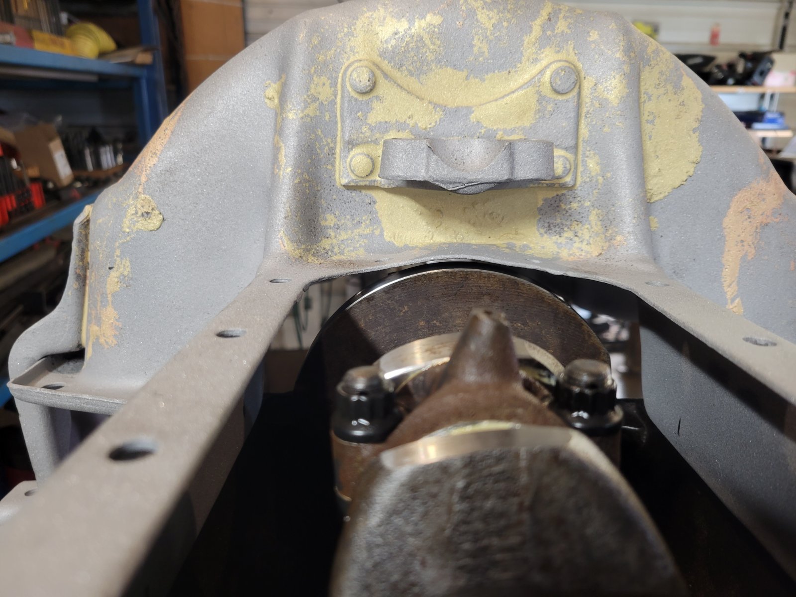

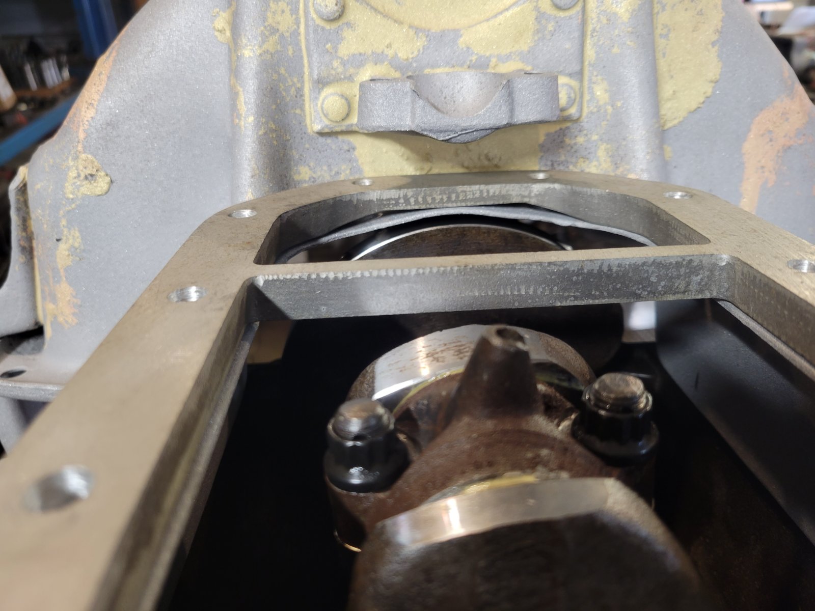

I'm back at last winters project. Please look at pictures. I bent the pan to clear counterweight, but there is no way the horseshoe will fit.
I'm thinking I'll fill the 2 holes in the pan eliminating them and have a left and right rear horseshoe.
Shown with a extension for the dipper pan, I also have some that are not notched that I could machine for a better fit.
Any other ideas?
Any other ideas?

Cut the horseshoe and tack weld in in. Bolt the pan, spacer and cover together and take a large welding torch and quickly heat the pan and form the pan down into the recess in the spacer- the metal will stretch out with very little effort. You will have room to tack weld nuts into place to clear the crankweb on the last two bolt holes where you removed the horseshoe. Heat the steel quickly and don't overheat the aluminum pan spacer.

I tapped the 2 rear holes in the pan spacer and trimmed a small piece out of the pan on my last motor. A bit of silicone seals the spacer to the pan, and the inspection plate doesn’t know the difference. Lots of clearance now!

You can’t use a B crankshaft in a model T unless you turn down both the rod and main journals down to model A size. At that point you have nothing more than a counterweighted model A crank. The B main journal size is larger than the space between the T main bearing bolt holes. You can’t run B rods in a T block unless you have an overhead cam engine because the B rods will hit the cam in the block. So call it a model A crank unless you want to spend an absurd pile of cash. I can post pics of our T race engine with a full size B crank and DO Rajo head.

Ditto on Erik's post..., been there done that! And don't forget to dimple the upper mounting on the oil pan for those rods to clear!

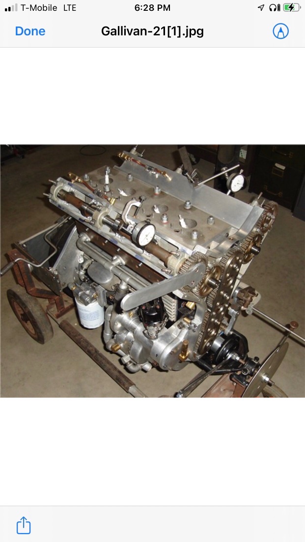

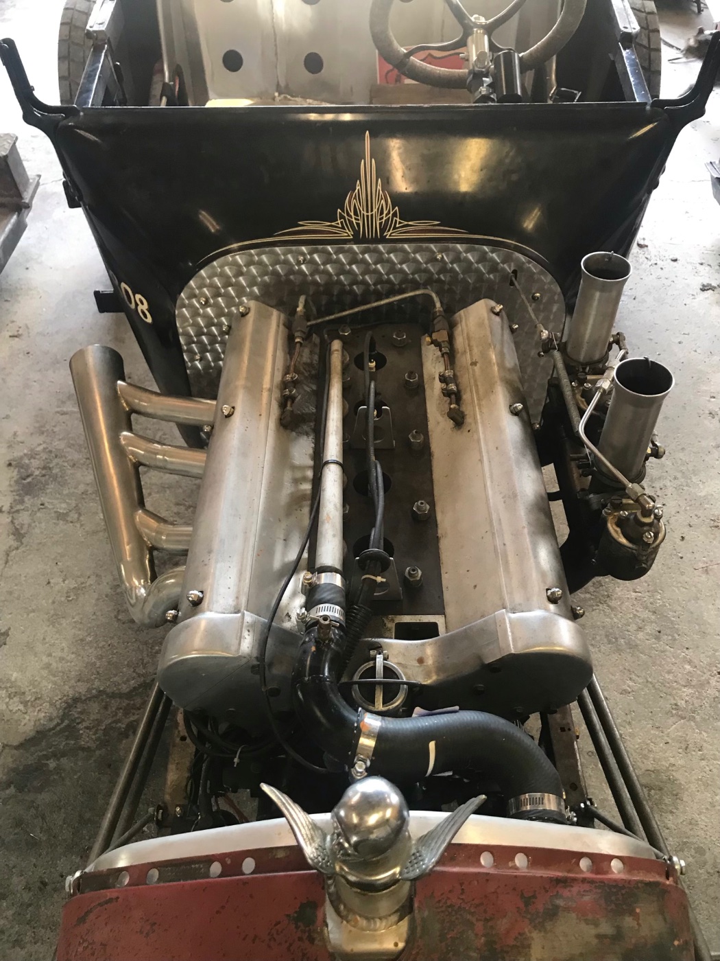

Here are some pics of the Rajo DOHC. Use of the full size B crank was possible because the cams are overhead and the main bearing webs were machined out and replaced with larger ones. This engine performs very well up to 6500 rpm.

Scott, I am not sure my DO Rajo is the same one you are talking about because I don’t recognize the names you mentioned, but what you said sounds like it is the same one. It was built with high compression pistons to compete at Long Beach. That event ended before the engine was ready and it always rebuilt with lower compression pistons to use a supercharger or some kind of exotic fuel. The net result is that it has only 75 psi compression. It goes like hell but could really use the high compression pistons back in. We know where they are and will have them back. We bought the engine from Brian Blaine of ragtime racers. We built the rest of the car around it.

Scott, thanks for the clarification. Interesting that our DO Rajo was also detuned. It is definitely a Rajo as it has the design tweaks Jagersberger made after he bought the whole project when Gallivan got in trouble for building them instead of Hispano Suiza airplane engines for the army.
