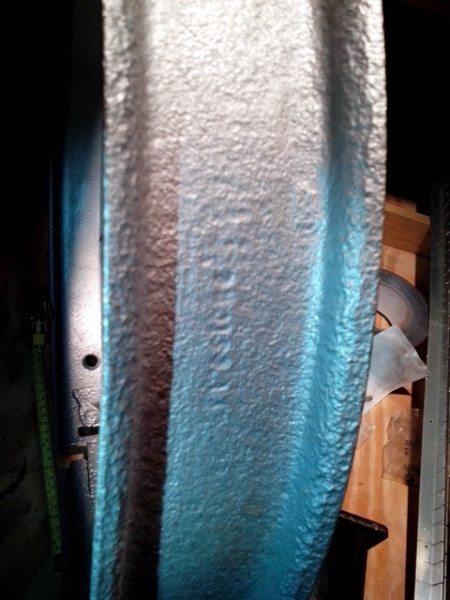

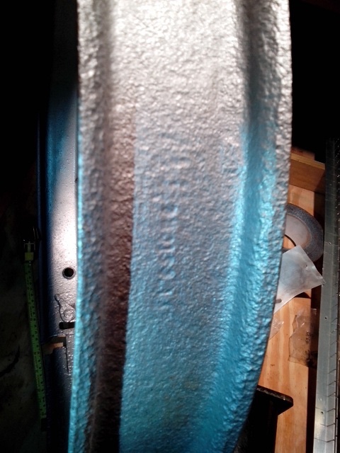

I have a set of reproduction 21"split rims on my 26 coupe. They were mad by Stephen Hood. He is Vintage Rims Australia. I also have a set of 30x3.5's on my 25 pickup.

There you go Tom. Direction to a source in one post and a testimonial from a happy customer in another. Steve does beautiful work. He is a great supporter of our Model T National Rallies.
