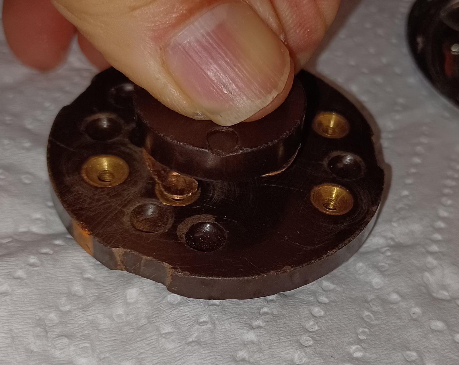

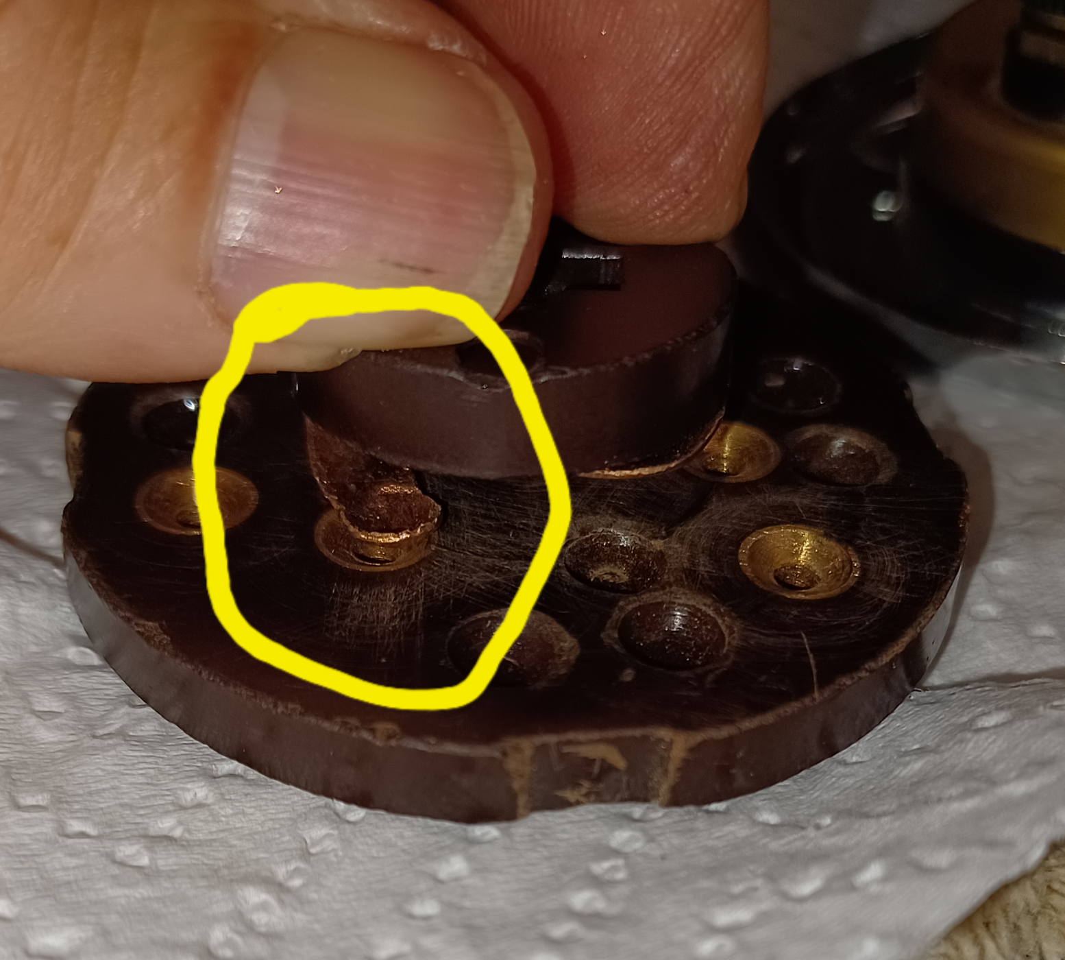

- Posts: 3743
- Last Name: Wrenn
Re: Rough on magneto
Bill I bet it's your switch. I'm attaching 2 pics..my Fordor runs great on batt, and only on mag for about 2 trips after I open it up and tinker with it. It's a repop. I went back to the original after Cleaning up the contacts and making sure they are "firm". The repop, with the yellow circle, shows how poorly the contact is from the male portion into the little female depression contact. I am sure that's what the problem has been.Bill67 wrote: ↑Wed Oct 04, 2023 3:49 pmHi. Last week I posted a question about my magneto not working. Several people gave advice and I have it working; problem was in the switch. (Thanks for all the help).
I just took it for a short ride (close to a mile). It is definitely running more rough on magneto than on battery. Any ideas?

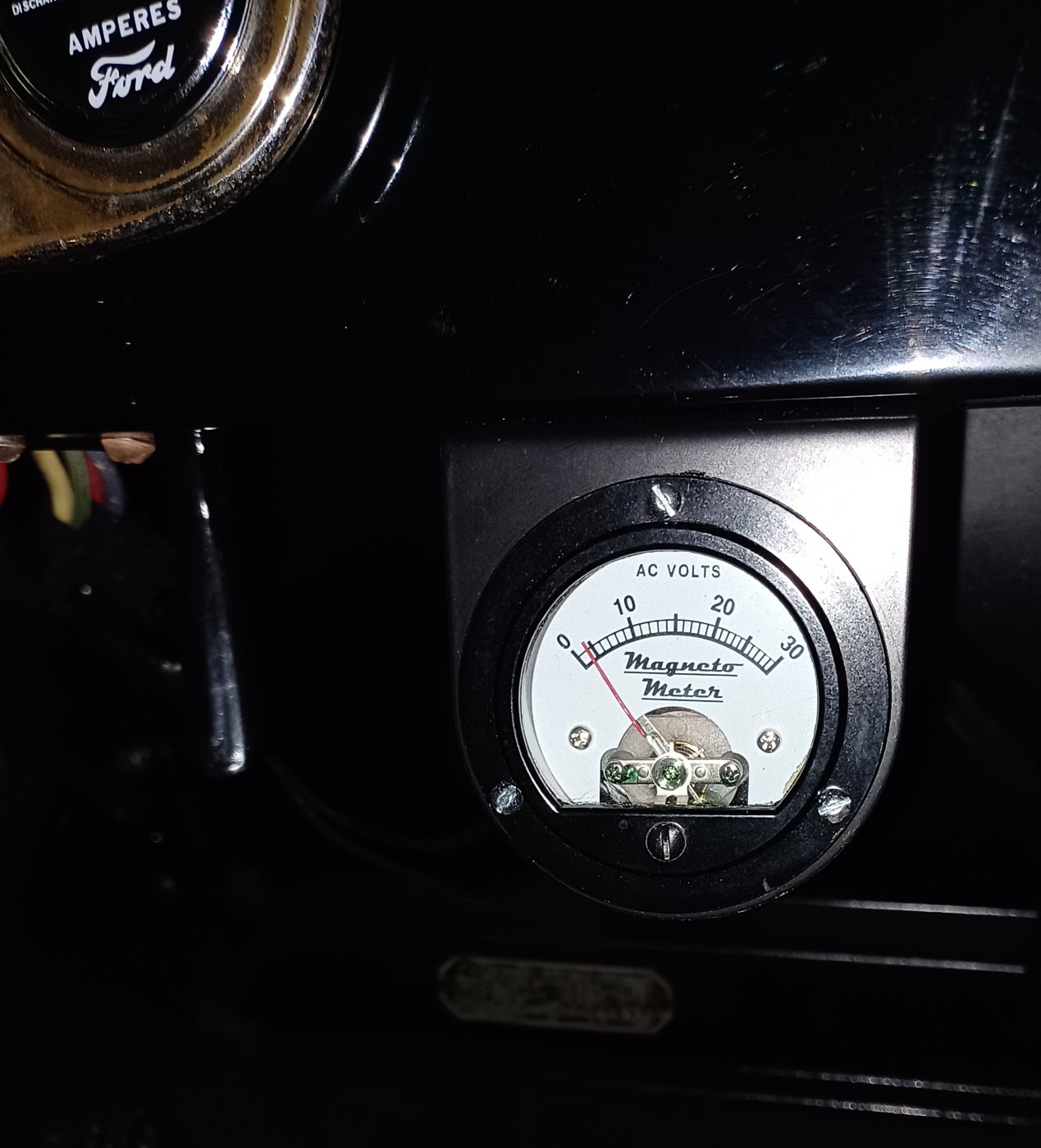

- Posts: 3743
- Last Name: Wrenn
Orrrr...you could put one of these on your car and then you'll always know what your mag is doing!
