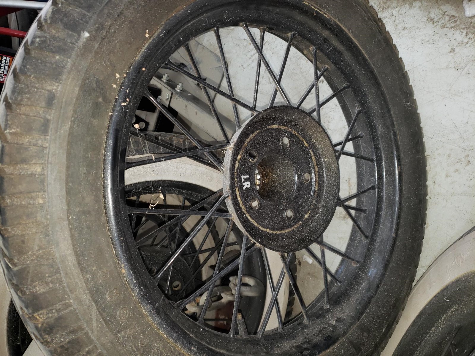

Instead of using the spoons, I'm wondering if anything in the modern tire world would remove these tires from these rims without damaging either one.
Let me know of anything I should look for, or ask at a tire shop.

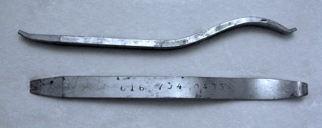

There once was a kind, elderly couple who manufactured and marketed their own design of tire irons especially for the Ford Model T.
Unfortunately, the phone number they had stamped into their irons no longer goes through, so I suppose the best that can be done now is to try to find a set of irons that approximates their shape and size. _They measure out at 9 7/8".
If the tire irons you purchase have any square corners or are anything but dead smooth, take a file and then some emery cloth to them.
