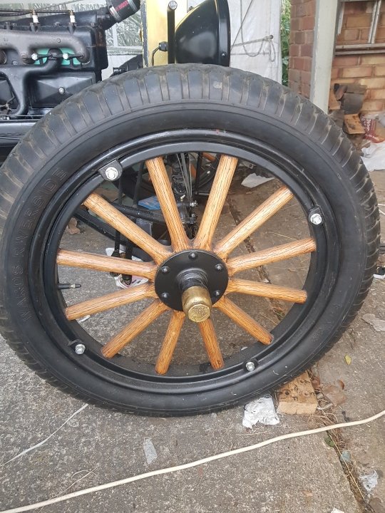

Here is a picture.
- Posts: 5579
Re: Detachable Rims

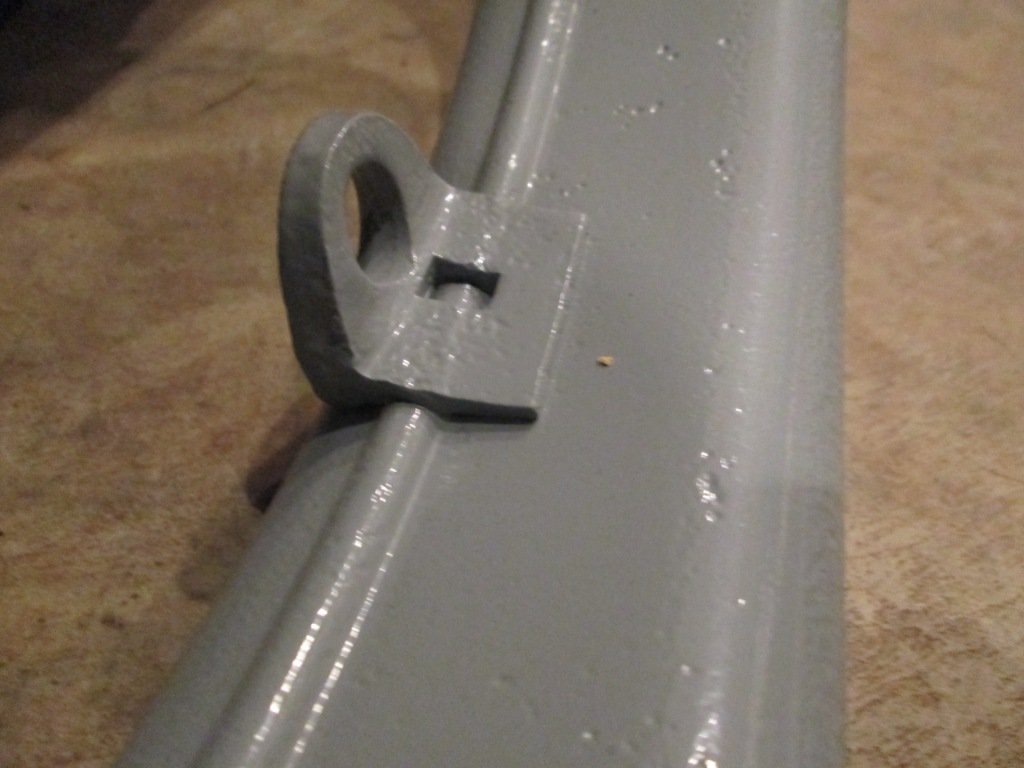

That particular rim is a Hayes - can't tell about the wheel a unless you remove the rim & tire. Hayes wheels have an indent that the rim "footed" lug nestles into. As Jeff mentioned - some are interchangeable & some are not. Hayes also has 2 styles of lugs - your type which has a bit of a straight side & the other is more curved - can't tell you why !

The front wheels on your '15 are most likely 30x3. So ,you will also need new 30x3 1/2 tires for the new demountables. My Hayes wheels have Hayes stamped into the lugs.

The big question is whether or not you want your "1915" to be like a real 1915. The demountable wheels like you show and others (like the Hayes) commented on by other posters were not available until 1919 and later. There were after-market demountable wheels made for model Ts by 1915 by companies like Firestone and Perlman. However all factory built model T Fords before 1919 had non-demountable wheels on them. USA built model Ts had non-demountable 30X3 tires in front, and 30 X 3 1/2 tires on the rear wheels from the factory. Canadian Fords had 30 X 3 1/2 tires front and rear. Why Ford had different sizes between the fronts and rears nobody knows for sure.
Many thousands of pre-1919 Fords had the non-demountable wheels changed out and replaced with later (1919 or later) factory demountable rim wheels after they became readily available. Thousands of antique automobile hobbyists have been using them for over a half century now. So if you choose to go that route, you will not be alone.

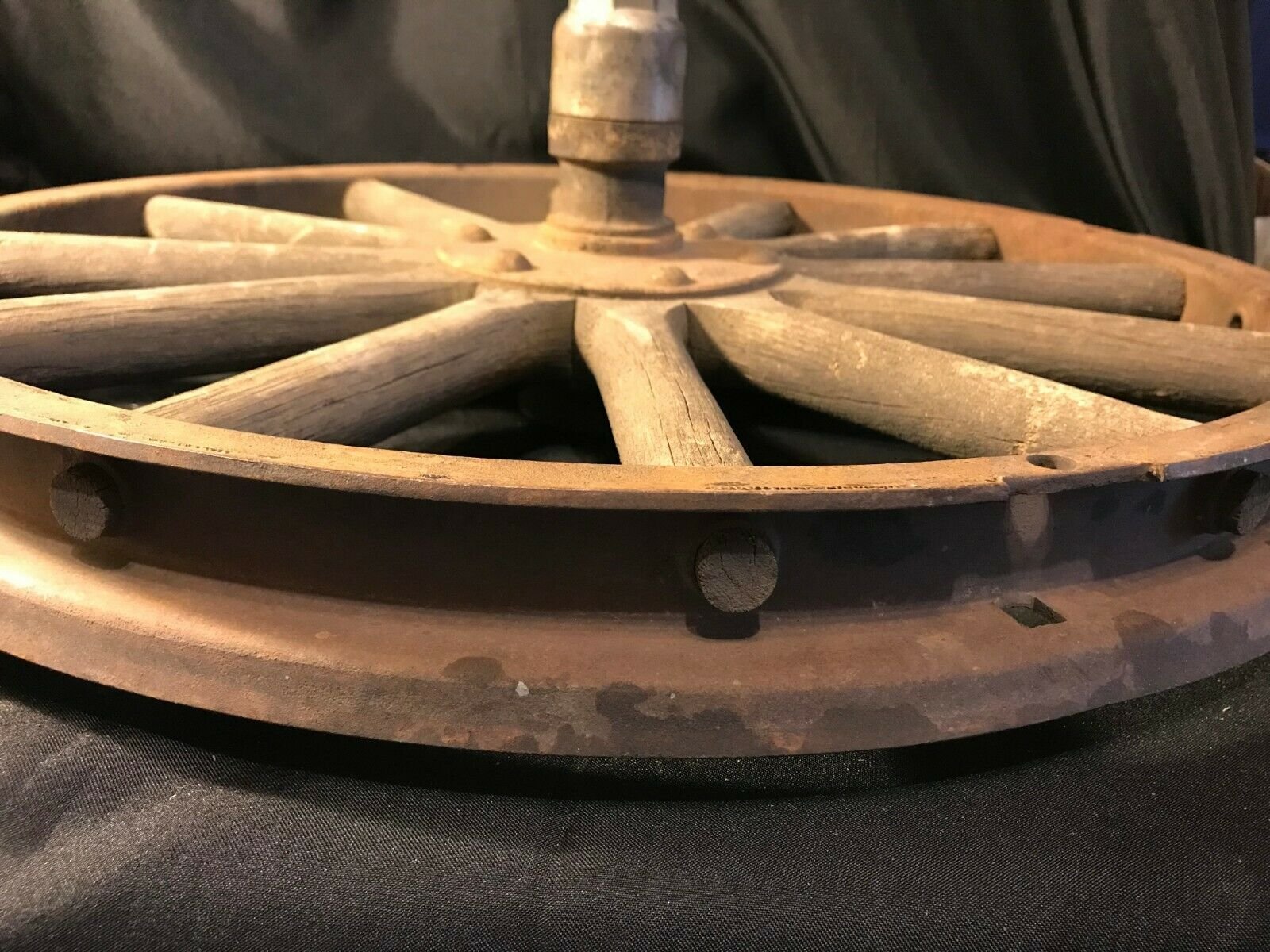

Hayes branded rims have the foot on the lug as shown. For them to fit the wheel, there must be a cut out/depression in the felloe to accommodate that foot. Other lugged rims without the foot on the lug will fit any wheel.

Hayes rims are easily identified. The lugs have a foot on them, as shown on the grey painted rim posted above. The lugs are also branded Hayes on the outside face. This means that the wheel is easily identified too, because the felloe needs a cut-out/relief to allow that foot to go on over the outside edge of the felloe.
All rims fitted to T wheels have the valve stem hole in the same place. If a rim to hand has a valve stem hole closer to a lug which may be slotted, it is a rim for a Chev or other car. You are correct that such a rim will necessarily have lugs in a different position. The four lugs will still be symmetrical. It is the valve stem hole that is shifted.
If your car had Hayes rims with footed lugs on rims without the reliefs, it is little wonder they did not fit well. The foot on the lug will not allow the rim to wedge onto the inside land on the felloe, and it would be free to wobble about wherever they would allow.

Wayne, when looking for felloes to build Hayes wire wheels, I discovered that Overland wheels had Hayes felloes, with the depression for the lug foot and the valve stem hole in the same place as a T.
Dick, in my experience a Kelsey lugged rim will bolt straight up to a Haues felloe. A Hayes rim will not bolt to a Kelsey wheel because there is no relief in the felloe for the lug foot.
