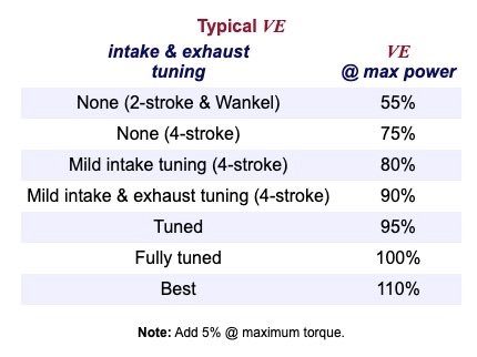

Sorry, I may not have been clear in what I was asking. The attached is a comparison chart of relatively new engines (assuming overhead valve). The information I'm looking for specifically is a comparison of engine construction types, L head, F head, Overhead valve, etc. specifically the Model T engine. I've found a VE of approx. 57% for the "flathead" Ford, and for a lack of any better information I'm going to use that number. Thanks

The peak operating VE for a stock model T engine would occur at or near the torque peak. Exactly whatVE would be I cannot say, but I'm sure it would be less than the later model flat head 8 at its torque peak. You could look up the specs and do the math and get a fair idea.
VE varies widely among individual designs within the several general engine types. Some OHV engines operate at a lower VE than some flat head engines.
Hot rodding is the art of increasing VE without destroying drive-ability or the engine itself.

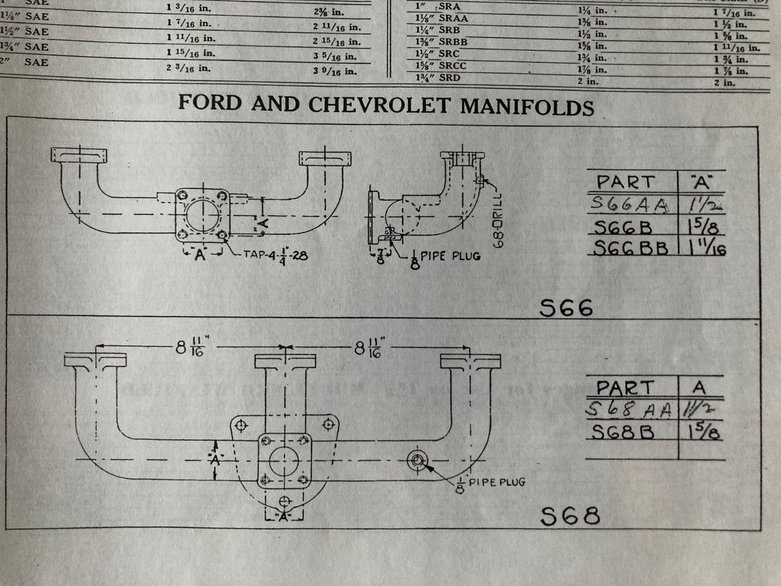

Brent, Pat great help, one last question any opinion on a Winfield S-BB on this engine. Have one on the shelf, but Winfield manifolds are hard to come by, although I do have an stromberg to winfield adapter. Thanks again
- Posts: 8413
Re: Volumetric Efficiency of Model T engine (L head) ?
VE is primarily a wide open throttle consideration. VE will fall off very quickly with less than WOT.
Longer, smaller ID intake runners usually favor low end torque, and larger ID, shorter intake runners are usually best for high HP at high RPM. Most everything up to and including the phases of the moon can have an effect. RPM and cam profile affects both intake and exhaust flow behavior.

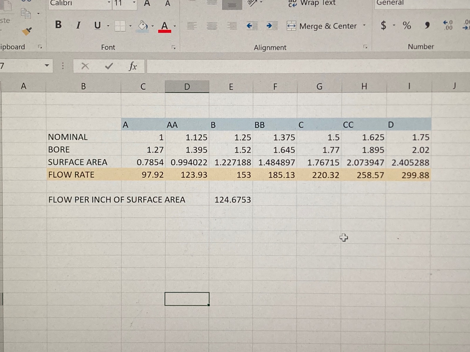

For reference, I calculate a BB at about 185 cfm using the “standard” 3” h2o depression. This was the largest of 3 sizes offered in the Winfield catalog for Model A engines. I currently run a S-B on a warmed up flathead in my touring car and used to run a SR-C on an arguably hot flathead in my speedsterhenryford2 wrote: ↑Fri Oct 13, 2023 7:30 pmone last question any opinion on a Winfield S-BB on this engine. Have one on the shelf, but Winfield manifolds are hard to come by, although I do have an stromberg to winfield adapter. Thanks again

Thanks Kevin! I run the S-BB on my BB Rajo and like the ease in setting it up.
