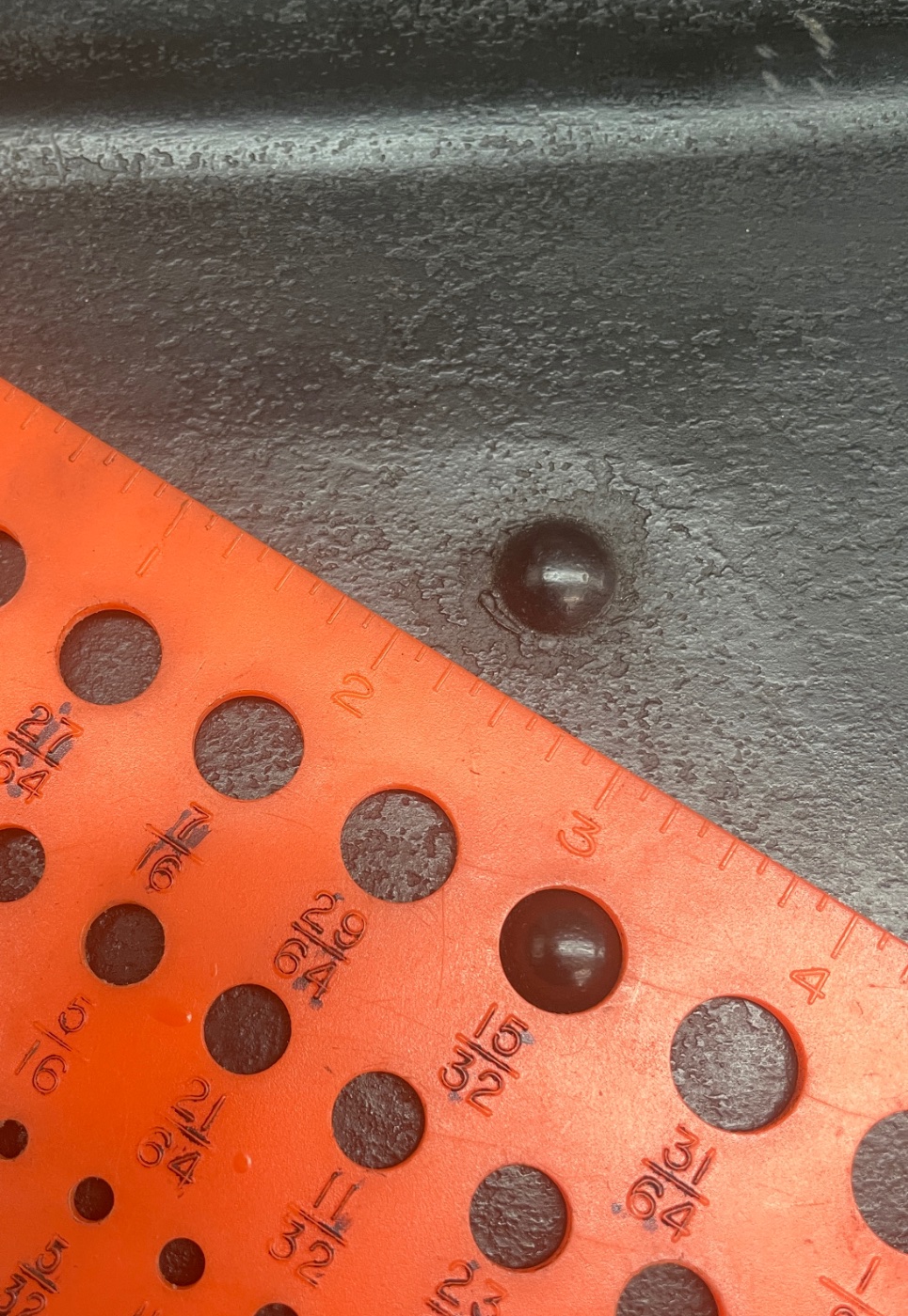

Photo is a '12 front fender and rivets to bracket appear to be a low round type, measure about 15/32" in dia.
The Truss head in Restoration Supply wouldn't seem appropriate, may have a pointed crown.
The rivets supplied by Lang's for their brackets are likely correct. Their correct bucking bar for the rivet head will keep the head looking factory when riveting the shank underside on the bracket.
