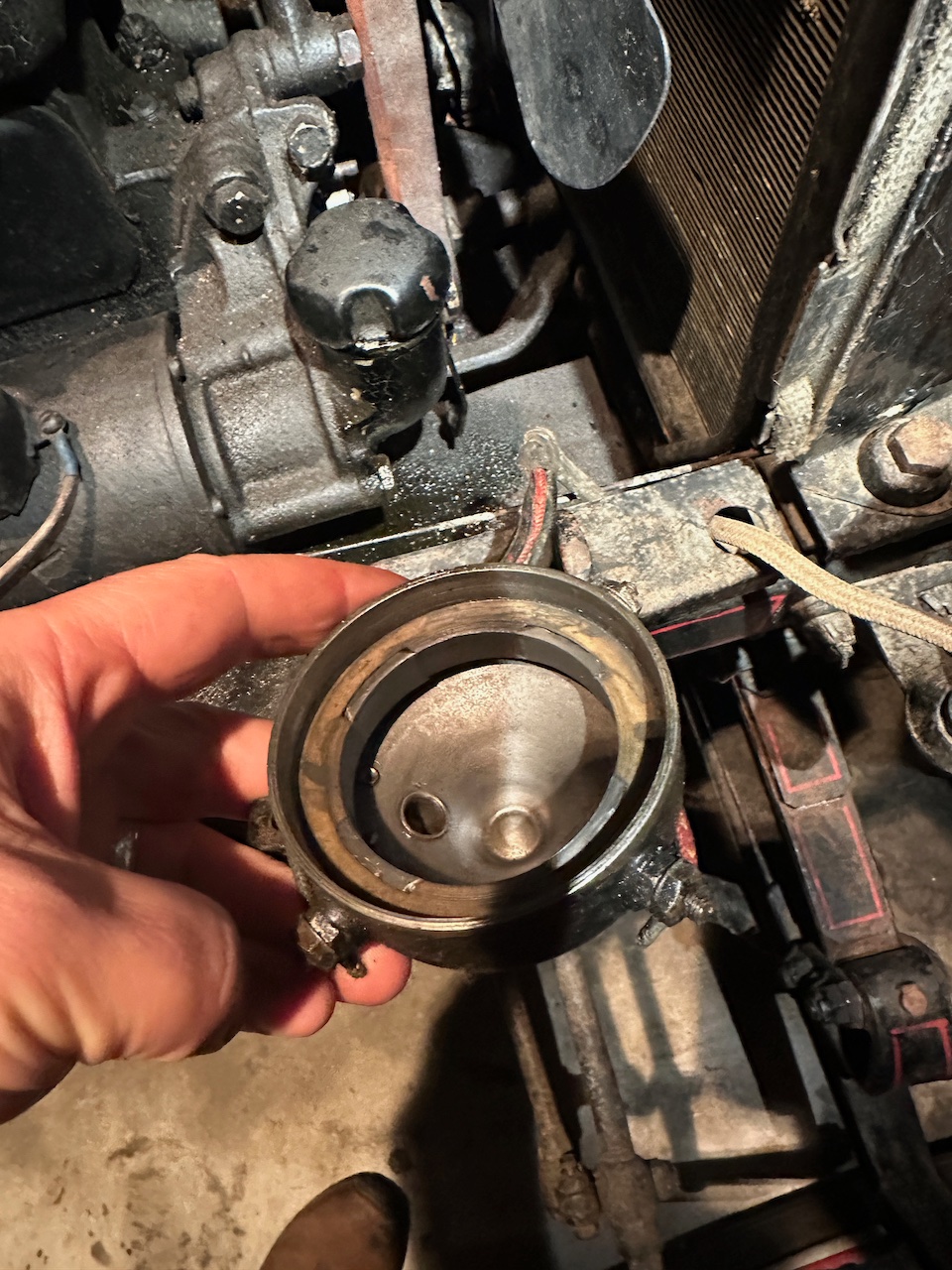

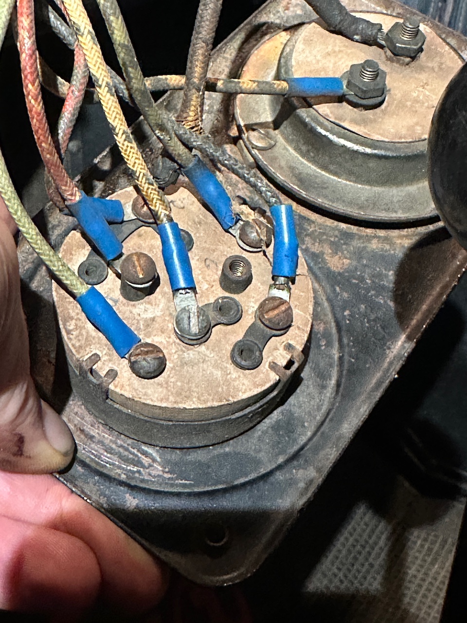

I cleaned the timer (pre-cleaning image below), in addition to taking each of the 4 wires off and cleaning the terminals better, then adding some dielectric grease to help fight against future oxidation.
I have noticed the lights will work (battery), but only after wiggling the switch, so I"m wondering if that is a hint of where to look next. I also noted there was an empty terminal; I'm not sure if that is normal or not (image below) I did tighten all the screws (as well as checking the screws in to the blocks for the coils, though I did not clean those as they looked really good).

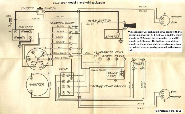

Make up a jumper wire to go from (+) on battery to the input of the coil box, thus bypassing any switch issue you may have. If the coils don't buzz with a direct jumper, then it's either contacts in the coil box or the coils themselves.

"I have noticed the lights will work (battery), but only after wiggling the switch, so I"m wondering if that is a hint of where to look next. I also noted there was an empty terminal; I'm not sure if that is normal or not (image below) I did tighten all the screws (as well as checking the screws in to the blocks for the coils, though I did not clean those as they looked really good)."
Big clue. SWITCH.
Either way you have a switch issue.
Take it apart & service the contacts.
Big clue. SWITCH.

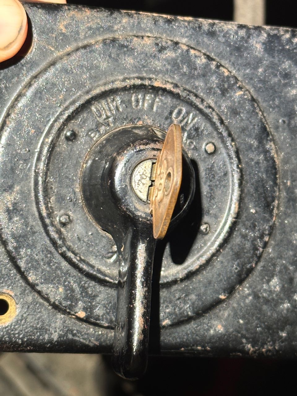

Turn key to LEFT for "Bat", then crank. Turn key to RIGHT for "Mag" to run car on magneto, or to start on "MAG".
Turning the key from center position to left to center to right a dozen times or so may get it working if it is internally dirty.

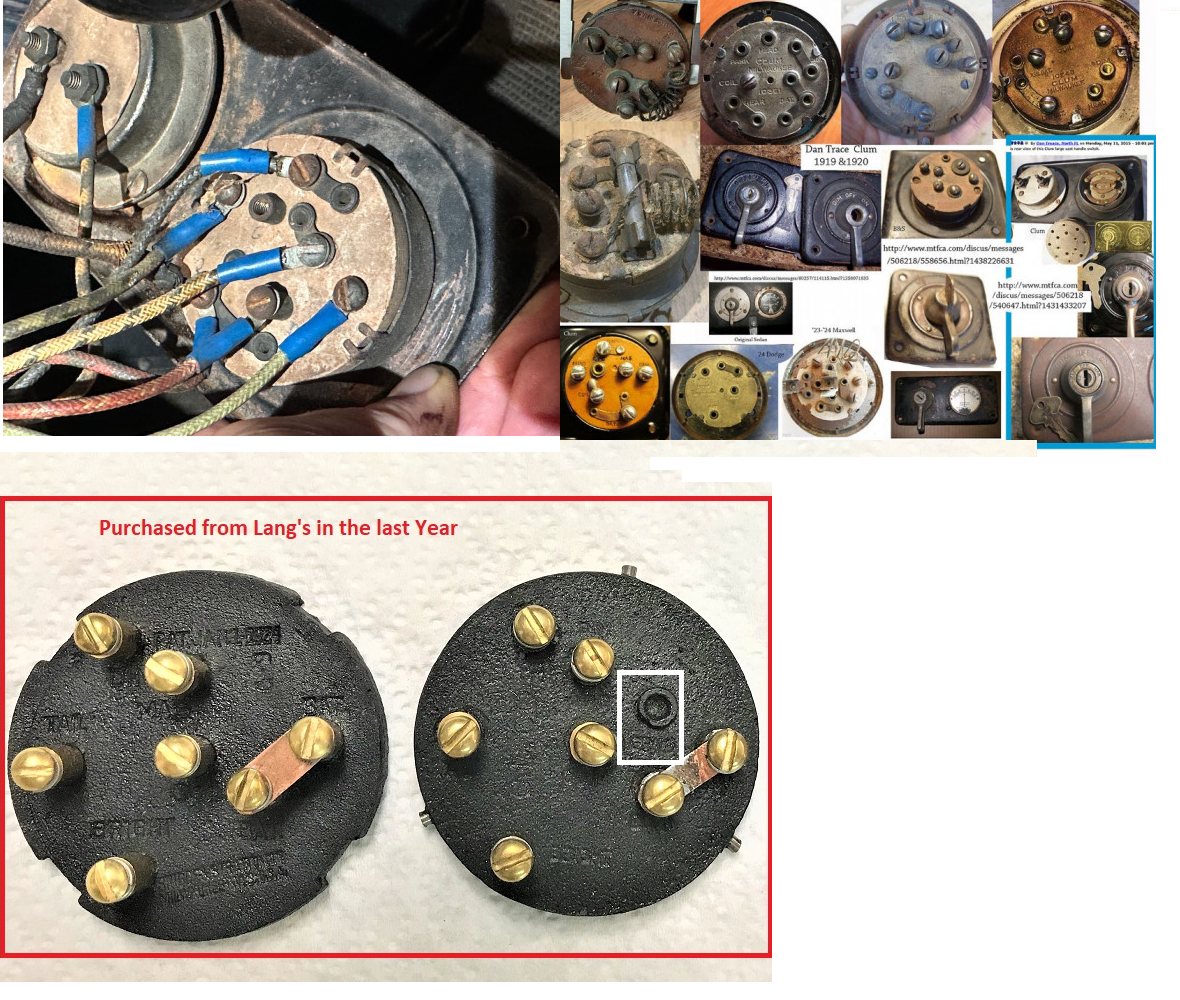

Not sure how you wired your switch but it appears to be a unique backing plate. It may have been from another vehicle and retrofitted to the T switch plate. It may have internal contact issues. If so I can fix it.Also there appears to be a crack in the backing plate wher the screw in the 11 o'clock position is. Would like to see what the front of the switch plate looks like - can you add a photo of it
What you need to do is test for continuity from the switch positions to the terminal strip or coil box as to what it is supposed to make contact with

-The roller on the timer was nice and shiny, but I still cleaned it up a bit in case there was oxidation I couldn't see.

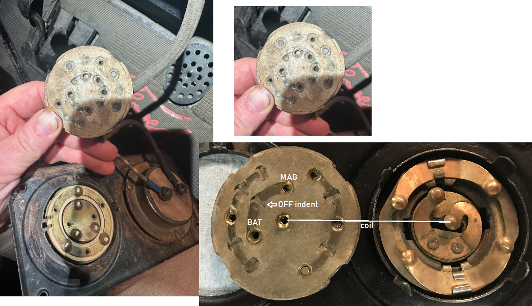

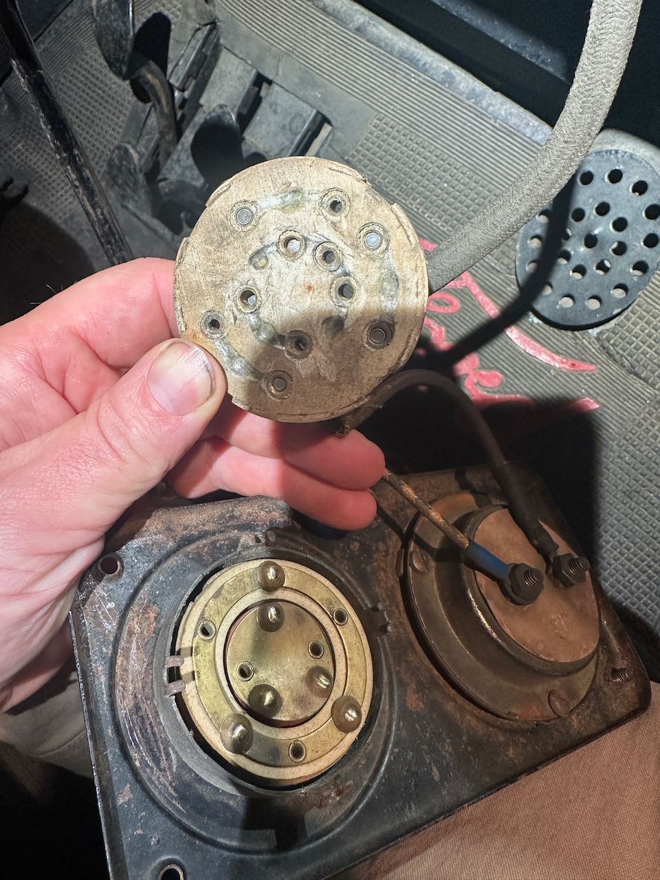

- I took apart the switch (images below pre-cleaning), cleaned the contacts, and no change. I think the "dimples" don't go quite deep enough.

The backing plate on the switch is the problem. Use some fine sandpaper and clean all the brass contacts on the backing plate. It’s looks you have a not so common switch. The most common version is the one that’s being reproduced but not that one. Ford used different manufacturers to make parts that were used.
What you could do is to take the switch back and carefully sand it with some sand paper on a flat surface. That way it will sand easily. Don’t remove much of the back but just enough to get it perfectly even.
Also slightly bend up the brass tabs on the switch that is still on the switch assembly. It looks like one is barely making contact on the switch back. You can tell by the shiny places on the the brass tabs.
Good luck!

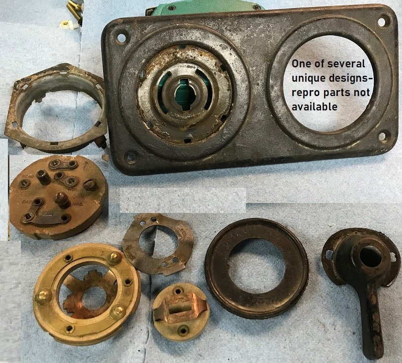

As I suspected that switch is one of the less common ones. They don't make a repro backing plate or any of the internal parts for that switch. But it is a very good one as you can see the "popular design" repro backing plate is entirely different. The "dimples" where the screw posts are should be cleaned so they make good contact when either the key or handle is rotated. I can't see any brass in those positions - can you? The other black dimples are resting spots where contacts are not to be made. Often the backing plate gets a slight warp & rubbing if across some fine sand paper is all that is needed to refresh it (but not to much). Lastly the tumbler could be cracked. I'm not in the business, but offer to repair these to help members. Will email you via the forumCouchsachraga wrote: ↑Wed Oct 18, 2023 8:16 pmThank you all for the thoughtful posts! Great community here.
In no particular order:
-Oddly I don't have a cover for the coil box.
I'm likely ordering either a backing plate, or perhaps a new switch in its entirety, as well as a coil box cover (assuming Langs or someplace has one!). I might be able to tweak the switch backing plate enough to make it work, but given the "warping" and crack I'm leaning towards replacement.
One step at a time... thank you all again! To those I didn't address I did read your post and appreciate your thoughts - I likely will end up sending the coils out for a rebuild, but first I'd like to get it at least almost functional!
Other thoughts (and thoughts on replacing switch vs. just backing plate) are welcome!
This switch has the same internal parts but they are held in place by an entirely different method. The smaller disk in my photo is upside down

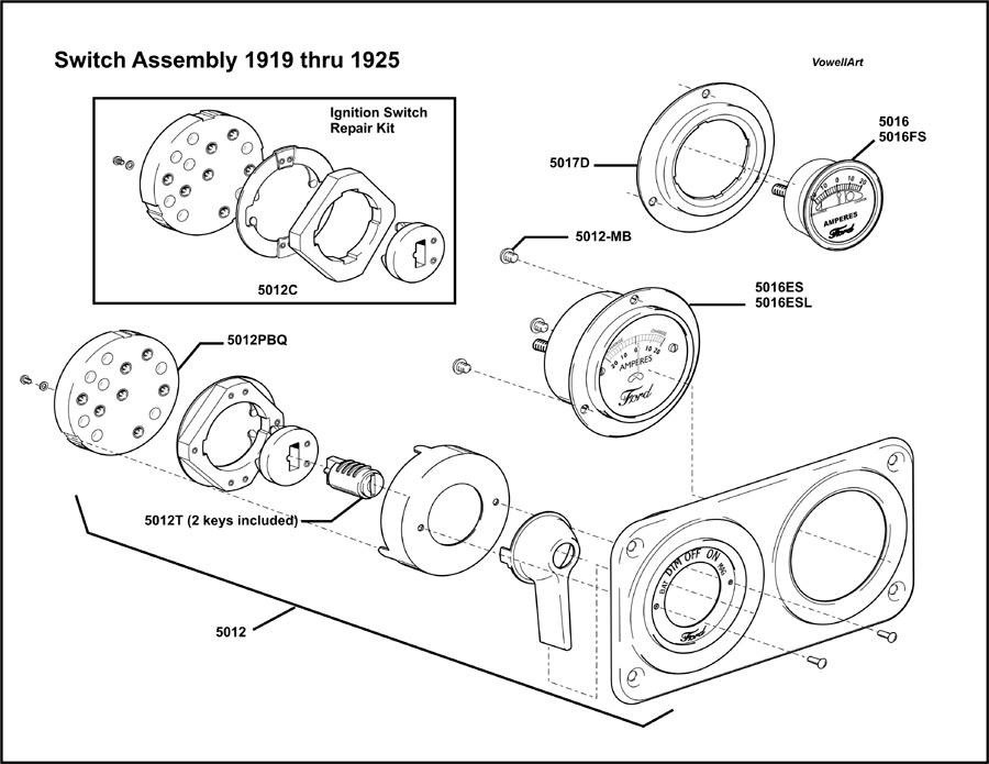

Regarding the fiber switch discs, You can get slightly longer screws and grind them down so that when they are tight, they will protrude into the dimple, but lower than the plane of the dimple as the dimple holds the contact in place through all the vibration while driving. When grinding off the screws to the correct length, be sure to factor in the thickness of the wire connections.
Or, better yet, you can get new replacement switch parts for your original switch with the screws in the right place to accommodate the correct “Ron Patterson” wiring chart we all use. Use your original switch plate and switch housing that’s riveted to the switch plate. It is always best to use original parts that came on the car from the factory, not only for originality, but because the parts were made by the hands of Ford factory workers and they were made better. I always enjoy looking at a part on my ‘26 T coupe and know that it has been with the car and all its’ adventures for 97 years ever since leaving the factory.
Again. Do not remove the rivets to remove the housing. It is very difficult to find replacement rivets with the correct patina that only comes with age and the switch can be rebuilt without removing the housing.
