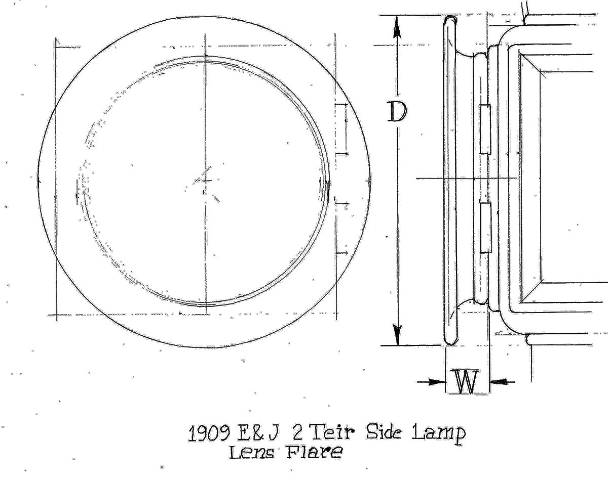

T am thinking of making a couple lens flairs to make my 1909 T more correct. I have good photos but would like to know the exact dimensions of the outside diameter and the distance the flare extends from the door it attaches to. I think the parts and photos can give me the rest. If anyone can tell me the "D" and "W" dimensions, I can make them much more correct.
Or if someone has a damaged one, they could part with, that would even be better.
Thanks, in advance.

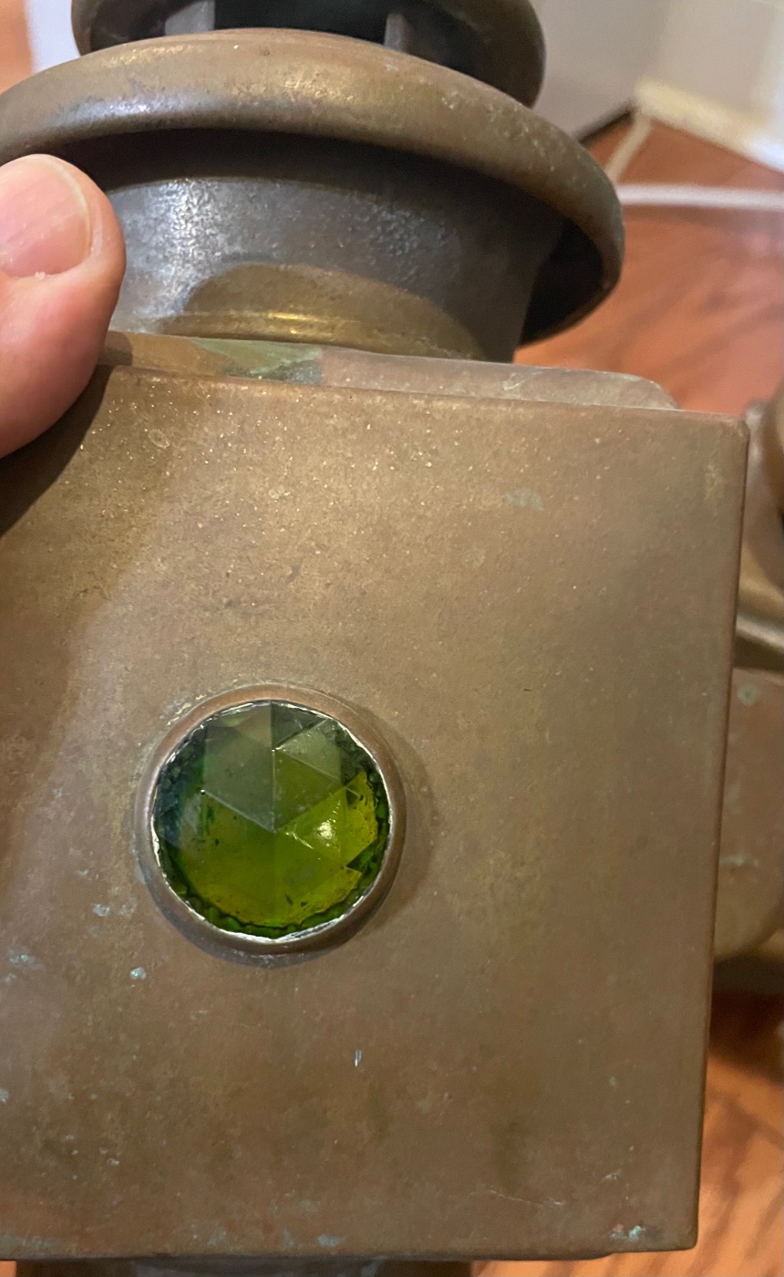

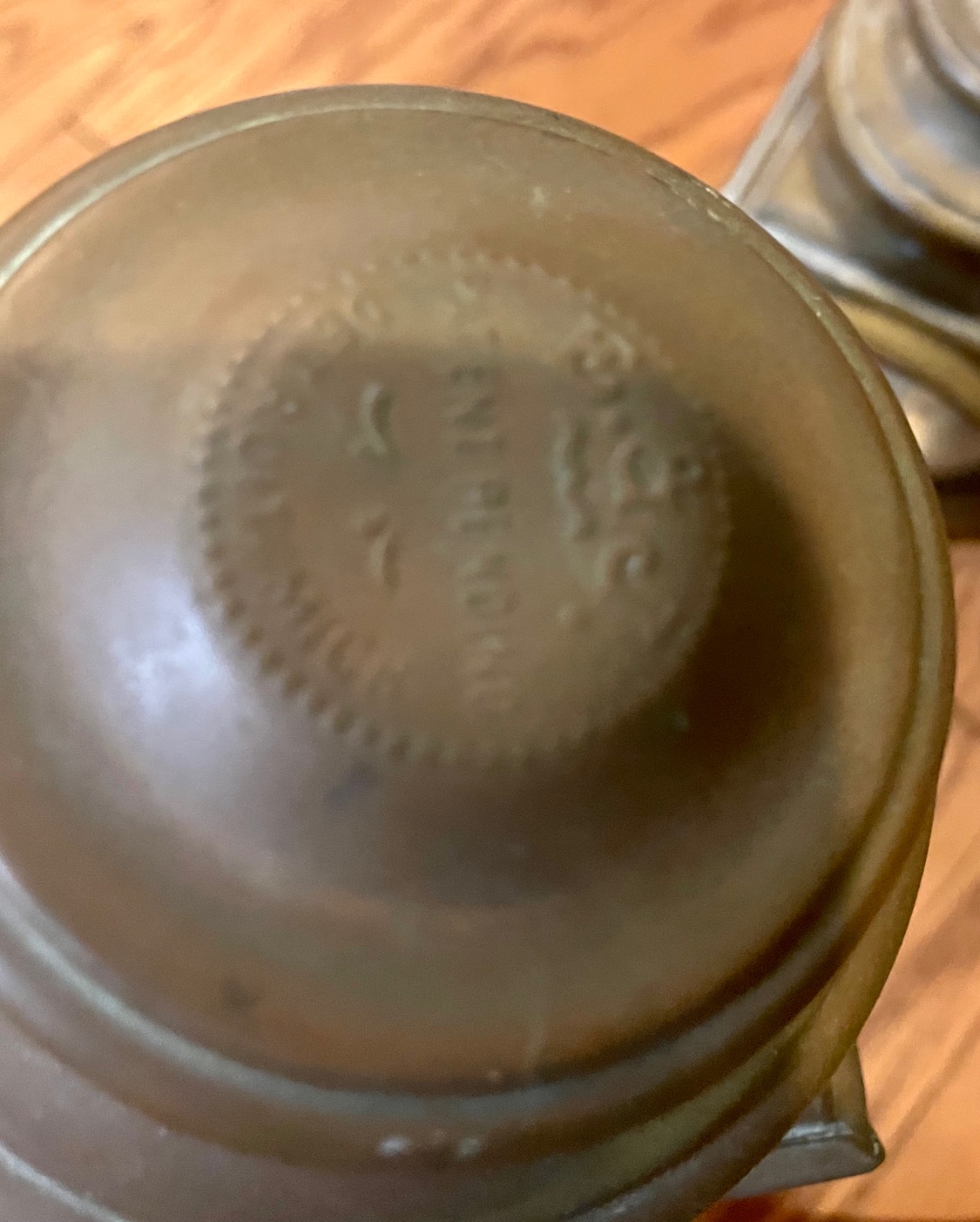

What is also neat about some but not all of the Patent Pending lamps are different style jewels some were smooth with no facets and some were faceted but different colors.

Those lamps with the red and green jewels may have come off a small steam launch or little motor yacht, hence the nautical colors.
