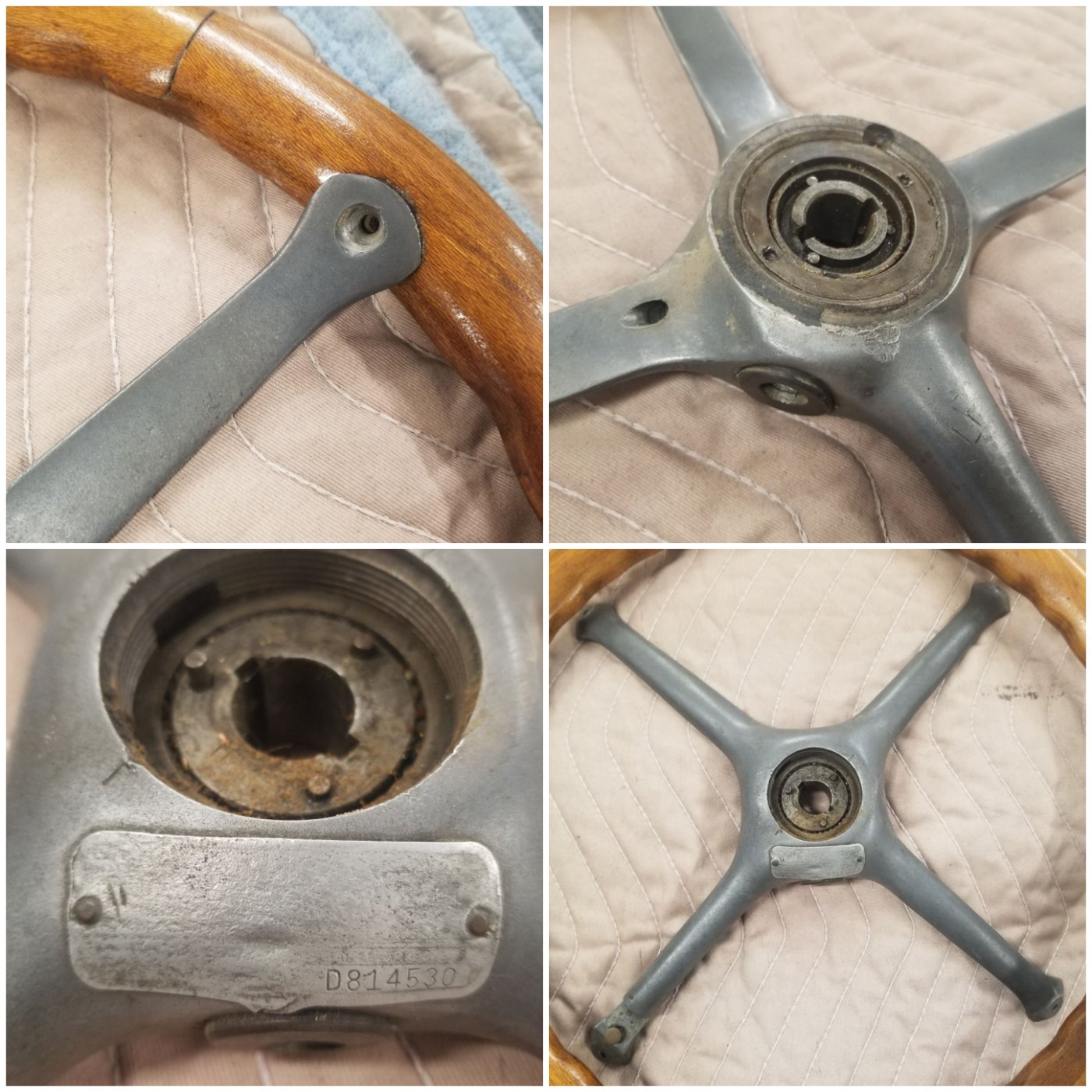

One of the many parts being giving to me with the 25, is a Fan man steering wheels. First thing I noticed is that he lost the screws that hold the wood rim on. Now that I've had a good look at it, the center hub seems to be missing a screw in badge? I also don't know what else is missing to make it function.

Pic attached

Vincent just regular wood screws will work even better if they were slightly rounded imho. Check the depth of the existing hole’s & diameter for your screws. It appears your steering wheel is set up for a horn. I don’t think it’s a Fatman steering wheel but rather a locking steering wheel in which case you may need a key if it is not already engaged for steering. I’m always a bit hesitant to use those with out the key or a way to disassemble to see what I actually had. This style has ball bearings involved for free wheeling when not engaged. Be careful. Best John

It’s going to be tuff finding the right horn button. And, that’s not a Fat Man steering wheel.

Good to know. I only know what the owner told me which is why I'll be asking a lot of questions!
Thanks.
