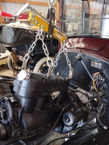

Leave the hogshead on! Take the brake and reverse pedal off, it's not that hard to do, you'll be surprised at how much easier that makes things. Then get one of those engine "balance" things with the crank on it and practically stand the engine up like a 70% angle and out it'll come! I done it twice already! Good luck Tom.
- Posts: 3743
- Last Name: Wrenn
Re: Taking out a Fordoor engine
Here ya go Tom...found one pic of when I took mine out, yes it's a "bit later" but overall the same procedure. This is before I really stood it up on end almost!TWrenn wrote: ↑Tue Oct 24, 2023 8:06 amLeave the hogshead on! Take the brake and reverse pedal off, it's not that hard to do, you'll be surprised at how much easier that makes things. Then get one of those engine "balance" things with the crank on it and practically stand the engine up like a 70% angle and out it'll come! I done it twice already! Good luck Tom.

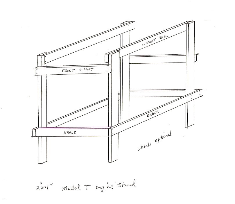

You could do it by hand with two friends, but have a place ready to put it. Here is a picture of a simple engine stand I made of 2”x 4”s. Measurements are basically taken from the chassis so the engine stand is the chassis made of wood. Jim Patrick
