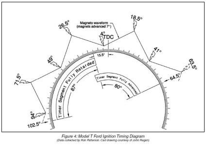

Hey all, I am working on timing my 1913 T and ran across that great article by Ron Patterson about hand cranking, but I am asking for a little help with interpreting this image...can someone validate this is a diagram of the front of the timer as seen from the front of the car? Or what does this diagram show? My puny brain is struggling to make sense of it, just don't want a sore arm by reading it wrong.

I am posting this at the risk of getting beat up again. It shows how the polarity of the coil spark changes every 22.5 degrees of crankshaft rotation.
The 22.5 degrees is a result of 360 degrees divided by the number of magnets on the flywheel. This can be seen when using an HCCT.

Ron can further explain the diagram better than any of us could, hopefully he will see your post and respond.
In the meantime, forget the diagram, here is a great procedure for setting timing that will work for any brand of timer:
https://dauntlessgeezer.com/DG97.html

Steve Coniff and I co-wrote that articel twenty years ago in an effort simply explain how the commonly misunderstood Model T Ford ignition system really works. The explanation remains today as one of the seminal learning documents.
The diagram Figure 7 is intended to depict the inter- relationship betweenn three key elements of the Model T ignition system.
Those three elements are 1) crankshaft osition in drgrees 2)magneto current pulses and 3) timer case movement.
When you look at the digram think about these three things and how they are moving and working togather.
Whne we wrote the article we had many heated discussions abut how the diagram should be depicted.
Steve Coniff passed away last week, but I'll bet he is chuckling about the disagreements and number of times we changed the diagram to get everyone on board. Like hearding Model T cats!

This describes the "9:30-3:30" crank pin procedure in step by step detail. Thanks MarkCudaMan wrote: ↑Mon Oct 23, 2023 6:00 pmRon can further explain the diagram better than any of us could, hopefully he will see your post and respond.

Give me a cal if you still have questions abiout Figure 7.
