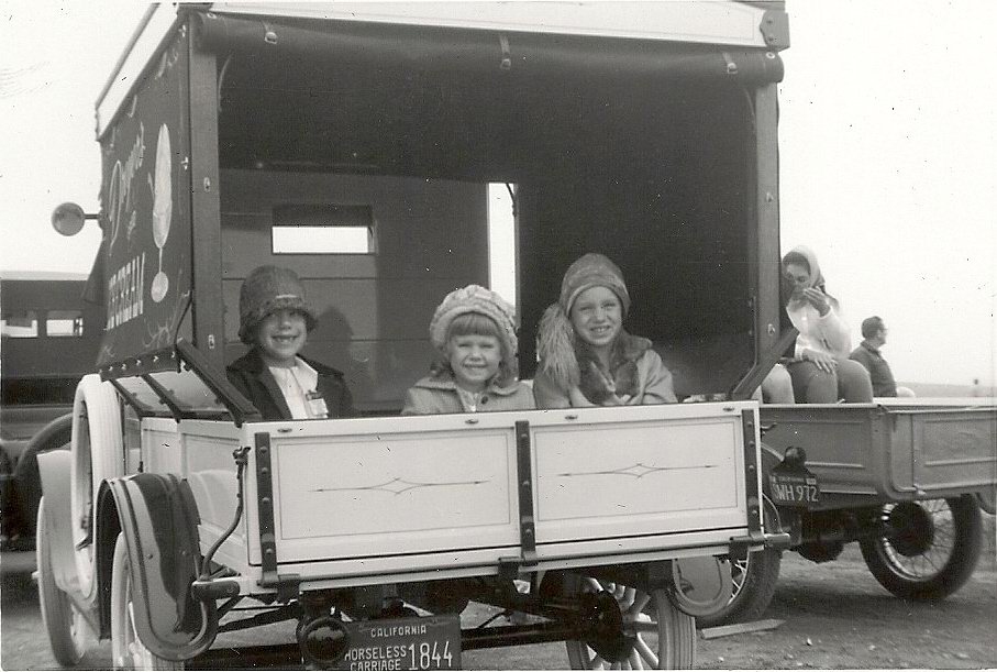

I've got nothing new here but to emphasize same gear up same gear down. Going back to the "olden days" on the MTFCA Catalina tours I drove my ice cream truck (weight around 2100 pounds empty) with Karen in the cab and our 3 daughters in the back, all the way down to Long Beach, around 400 miles each way, Catalina Island, and on our way home headed into Yosemite National Park for a couple of days, then back home. Never touched the band adjustments. I'm sure a few people behind me on the island hills were not happy as we traversed down some of the very steep grades. I started at the top of the grade in low band held that pedal down tight all the way down the hill to the bottom. Very slow but no band wear. As you can see in the pictures Tim Stangland in his original UPS truck accompanied us the whole trip

I remember a LOOOONG time ago when he and Karen came from Calistoga to our folks house in Santa Rosa for Dinner in their centerdoor (I must have been in my teens.... yeah!)... it's one squirrley road from Calistoga to Sana Rosa... but it was then that I realized Ford knew what he was doing, once you locked that "low" band into place, that car was going to stay in Low until the driver gave upon it. It's a lesson I never forgot...
